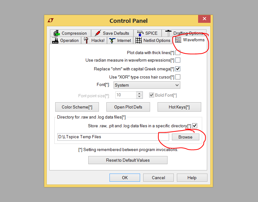

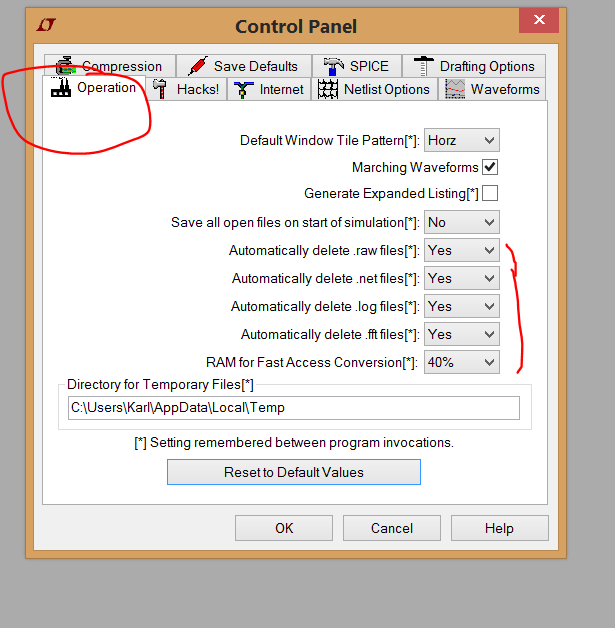

If you use LT a lot then it might be worth you moving the folder that LT stores temporary files in over to another partition. That is something I do, simply because LT can generate a few Gb of data in a long simulation and it seems pointless having that on the C drive where other files must 'work around it' and ultimately end up fragmented when the simulation run is over and the space is freed again.
To do this simply choose a location where the files will be held and create an empty folder named something like LT Temp Files. Now open LT and open the LT control panel (the hammer symbol) and click the 'Waveforms' tab. Now browse for your newly created empty folder and select it.
(Remember to set LT to delete all temp files automatically too)
