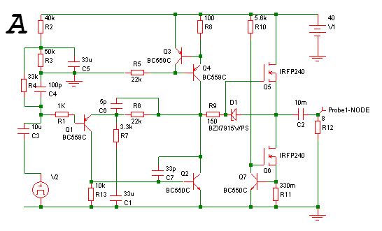

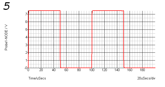

Your amp looks like voltage feedback to me, and the cap is totally appropriate. Without it, stray capacitance can be seen as a capacitor from Q1's emitter to ground, which causes an increase in gain and instability at HF. The 5p cap swamps these out to improve stability.

The most notable difference between this amp and more modern versions is the fact that there is no long-tailed pair (LTP) for the front end. Feedback is applied to the emitter of the input transistor, and works in current mode - hence 'current feedback'. This is possibly contentious - there are several interpretations of the term 'current feedback', and not everyone agrees. In this case, the emitter circuit of a transistor is inherently very low impedance, so is influenced by current. That the current is derived from a voltage is of little consequence, because this is the case for nearly all feedback circuits.

I think I sound crazy saying this, but if you look into MikeB's Symasym, which uses a double LTP, he says there was a big difference in quality when he changed to the 2N5551 and 5401 transistors. Perhaps it partly depends on the transistors?
Also, you may want to play with R9 as well to help square waves (if it matters). This resistor, aside from being a gate-stopper, forms part of an RC network from the output of your preamp to ground (through MOSFET parasitics). This network is what stabilizes your preamp without needing a Cdom on Q2. This nonstandard compensation gives your amp the qualities of a current feedback amp (high open-loop corner frequency, fast, steep rolloff). I like this, and I wonder what it has to do with the sonics. Is it possible that different compensation could be partly responsible for better sonics? Thinking out loud... You could test this by giving Q2 a Cdom, say 33-68pF.

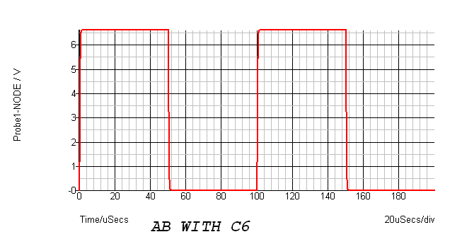

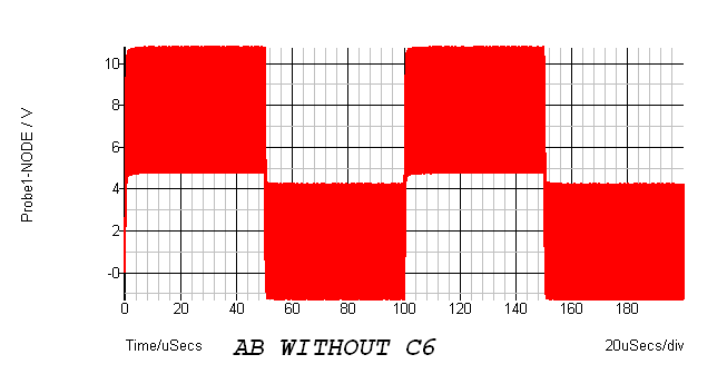

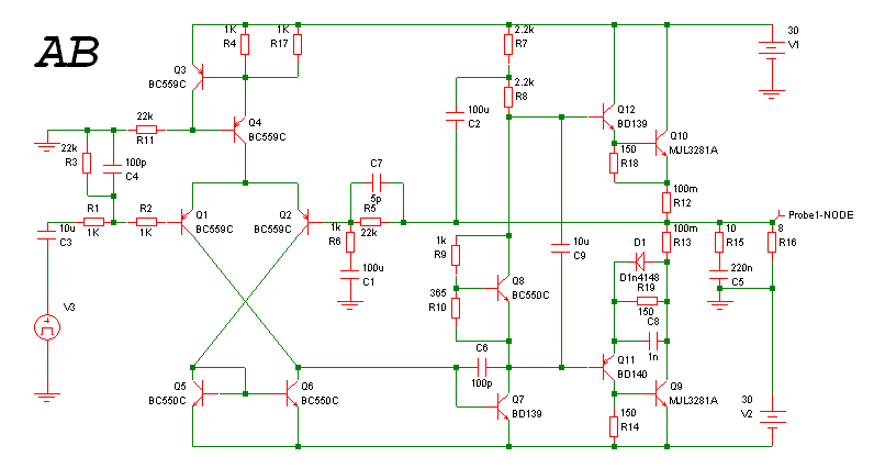

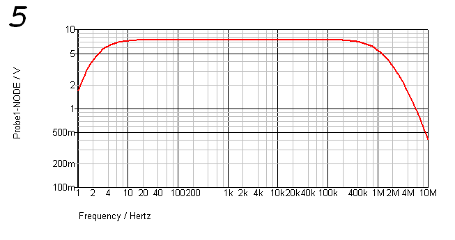

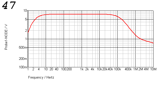

Here they are. With the LTP one too.
Addition of the Cdom in the emitter feedback amp seems to make it anemic in the HF response.
Removal of the Cdom from the LTP amp seems to make it run so fast that it starts to fly at supersonic speed.
These tell little about the sonics, however, everybody knows these facts.

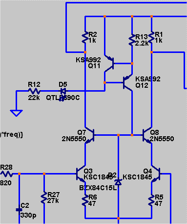

I suppose it depends on what kind of VAS you use. For my VAS's, any Cdom value will swamp out parasitics and render them negligible. I consider this beneficial, since semiconductor parasitics are nonlinear.

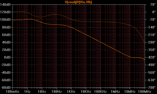

Ostripper, I'm talking about stability compensation, in the form of a discrete miller cap, just like C7 of Shaan's latest follower schematic.

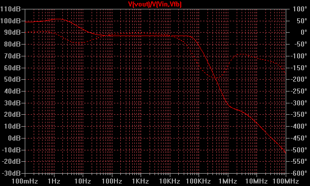

Here is what I mean about being inefficient. These are two open-loop plots from an old version of my headamp. The first is with default compensation. Second is switched to the VAS miller cap Cdom like Shaan's schematic. OLG is a function of differential voltage of the input stage, which is a function of input stage loading. As you can see, for the same phase margin, my alternate compensation scheme is much much more "discrete". Input stage loading effects are outside the audio spectrum, and THD is low at ultrasonics.
- keantoken

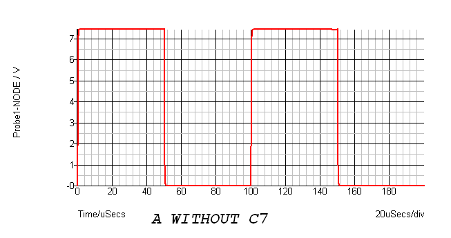

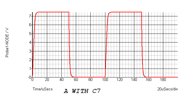

The sim shows overshoot with 10kHz square wave. The small cap (C6) solved it. At the same time I have some silver mica 5pF I bought years ago. Installed them in the board. No impact on speaker output though. Same lucid sound.
I heard this feedback cap causes current feedback amps to oscillate. Perhaps it wasn't true.
cheers.

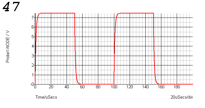

I also add silver Mica there, but not 5pf, but 47pF. Don't know any issue afterward, but seems OK if I test through free PC software (RTA) using soundcard + pink noise.
Ervin L
Ervin L
5 Vs 47.
Real world performance will be poorer in both cases though.
