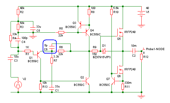

Cascode mod of the CCS. Just a thought. Are we really allowed to do this? I mean, does it seem to be workable? I ran a simulation with the current probe placed on the +ve of the 1ohm resistor(marked with black arrow). Above is the schematic and below is the graph.
About 90 microampere at 20kHz. Does it mean fluctuation of 90uA? As much as I know It is not the quiescent current, because the original MPF with darlington shows 15mA at 20kHz in the same test but draws 2.2A from the supply. As 90uA is about 166 times smaller than 15mA so I was wondering whether it could minimize the spikes further or not. Need advice.
Thanks.
What if R11 (22k) not connected to the pre amp output, but direct it to MOSFET Q1 source (before to output caps)? Will it improve?
Thx.

I had some thoughts about this circuit:
Why not make the positive rail ground? When the circuit switches on, Q1 will dump an indefinite amount of current into C2 in order to bring the output up. If the load is instead connected to +rail, the CCS will instead draw a steady current through the load until the cap is fully charged, minimizing turn-on thump.
After we do this, I had the funny thought of experimenting with connecting the ground side of C4 to Q4's emitter. That way the current source becomes a linear push-pull follower, conserving energy without damaging linearity. (Also, the feedback network was the only thing loading the VAS, now it doesn't anymore...)
Also, if you want to see the real response of the CCS you will have to place the current probe at Q6's collector (BJT terms for lack of MOSFET vocabulary...). The current through R1 will in fact be the most steady since MOSFET capacitances reroute error currents to the gates.
- keantoken

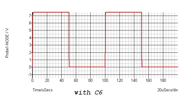

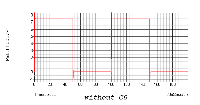

Small addition
The sim shows overshoot with 10kHz square wave. The small cap (C6) solved it. At the same time I have some silver mica 5pF I bought years ago. Installed them in the board. No impact on speaker output though. Same lucid sound.
I heard this feedback cap causes current feedback amps to oscillate. Perhaps it wasn't true.
cheers.
