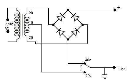

I have an interesting problem now.
I am running the follower from a 20v-0-20v/4A rated EI transformer and this current rating with 40v output is the maximum available from retailers here.
The transformer becomes hot after almost an hour of operation and thermally stabilizes at about 75-80 degrees Celsius, which I think is really hot; barely touchable. It's almost the end of winter here and maximum midday temperature is about 24-28 degrees C. In the Summer it becomes and remains more than 30 deg C. for many days and midday temp often rises to 45 deg C.
With the current darw of ~2.5A I think the transformer will get too hot in summer and probably will fail.
So I thought of a workaround as the summertime fail-safe. The configuration is depicted in the picture below.
The dissipation in the transformer decreases with the lower voltage output. I think this will do good in summer. The current through the follower is still ~2.5A. Adding another 1ohm resistor increases it to 3A, which too doesn't seem to stress the transformer too much.
My question is that whether this lower voltage have any adverse effect on the distortion figures of the follower. Listening tests didn't show any quality loss in output other than clipping at less volume.
Thanks.
