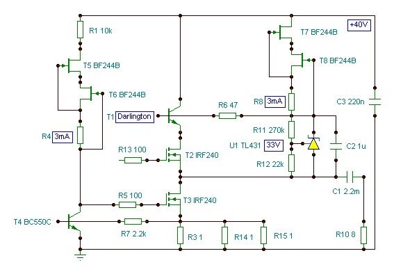

Shaan,
there is a small positive fb loop from the supply via the 4K7 to the gate of the mosfet CCS. With positive going signal, supply sags a little, this pulse is passed through the 4K7 to the gate, and output rises just a little. The effect is small, but non-linear. It could be eliminated by splitting the 4K7 into two 2K2 in series, with a 47uF bootstrap cap from the mid-point to the ground. This ensures that the supply for the lower gate is referenced to ground, and will it will reduce distortion. [snip]Hugh
Hello Hugh,
Nice catch on the pos feedback loop. Not wanting to split hairs, a bootstrap cap is normally returnd to the output instead of ground. That way, the midpoint moves up and down with the output making the voltage across the lower 2.2k, and current through it, constant.
Not sure what that does with the turn on/off thump though, has to be checked in practise.
jd
Understood. I tried the config you suggested many times and am well aware of its advantages. I think I will apply it... very small modification. Thanks.Shaan,
I do not hate gate stoppers. In fact the follower becomes unstable as soon as I remove the resistor from the upper FET or, I don't know why, place a resistor in the CCS FET's gate. Not using one makes it behaving as it should. So I omit that.I do suggest gate stoppers too, it may be OK in the present form, but gate stoppers take care of the hexfet tendency to oscillate by slowing charge transfer to and from the gate junction, which is a cap, in fact. You can't be too careful here, particularly as the amp must drive a highly reactive speaker.

Hi Hugh;
this 47 uF cap will definitely give a thump on switching off of the amp.
Gate stopper will introduce a pole with input capacitance of MOSFET
Hi Anatoliy,
Yes, there is a thump, but it's infrasonic, hardly noticeable.
Yes, there is a pole, no question, defined by RC, but again, this is common practice to sidestep potential instabilities, and introduces no sonic penalties, why not?
Hugh
I don't think so. It would be better if quiescent current of the whole output stage goes down when the amp is switched off, instead of abrupt discharge of the coupling capacitor through the CCS and a speaker..
Because such a pole can cause oscillations, while without it the CCS may be stable. According to what Shaan writes it is stable.
Thanks both. The config looks interesting, so I will try it. If it oscillates, I will just have to remove that capacitor, and there I get my 4K4(~4K7 ) back.

Howdy,
since that resistor acts as a current source, it should be preferably replaced with an active high impedance arrangement (will give a cleaner voltage at the gate without causing any spike).
The BJT you see in the gate is THE last "active" device I can afford(due to limited space and for the sake of simplicity).
A little bit of spike is perfectly okay for me as long as the FM channels are alive while the follower is on(I don't own a scope, so I never know how much spike is there at any time, however).
But of course I encourage you if you want to make one. If you don't, just fine, I know you don't like it.
Thanks.

Nice. I'm happy to know that. Now place the active CCS there in place of the 12K resistor and like it more. This is really great. Hope it'll sound cool. Good job.

Your idea of a CCS supplying the gate voltage is a good one, I use it too, and it works very well, no thump, particularly if a cap is placed from gate to ground to slow switch-on.
