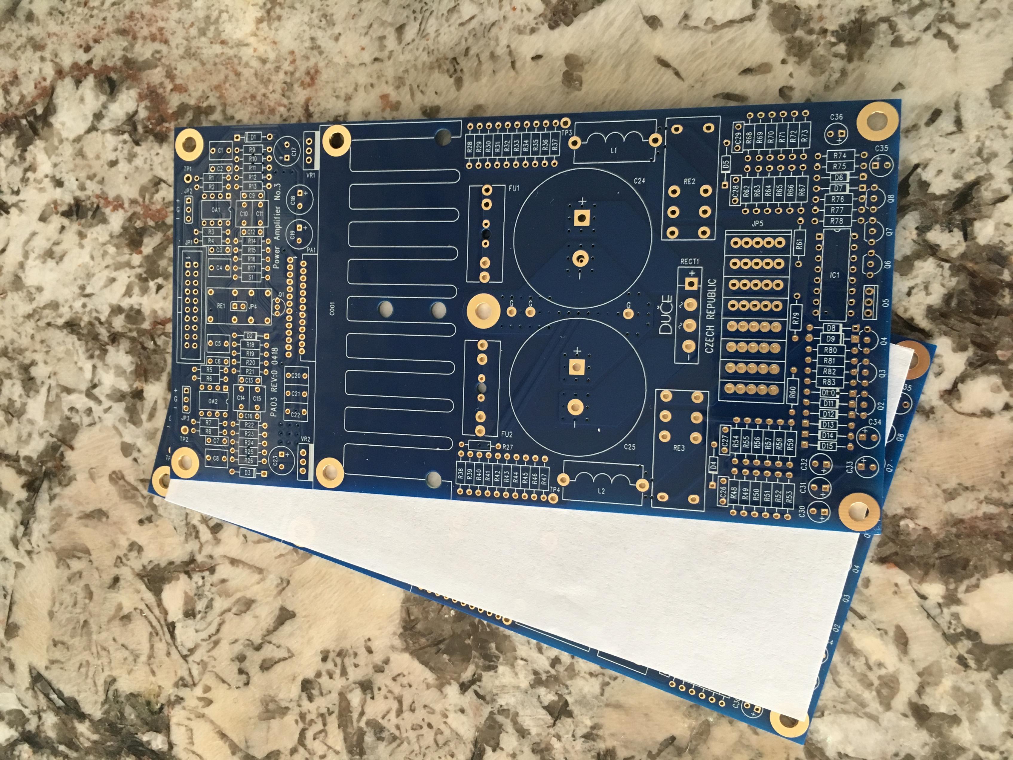

Just a quick thanks P-A. I have finally completed the build and am test listening to the amp now...it's awesome! Just have to get a case sorted along with the final touches (which may include a new heatsink as I am using a modified and recycled one for now). Can't believe how good it sounds. And as my first foray into amplifier building it's been great fun and great learning. Photos to follow when I finally get it done. Have to warn you it rtook me 6 months to put it together...life is so busy!!!

Boards are stereo .... chip is stereo.... one board would be enough for the last person.
How do I purchase a board please?I have still a few boards left.
Sent from my SM-G900H using Tapatalk
Added my name ,hopefully
Received my board today ,it's got to be the best service I have ever had anywhere 4 days Sweden to England Thank you peranders. John
