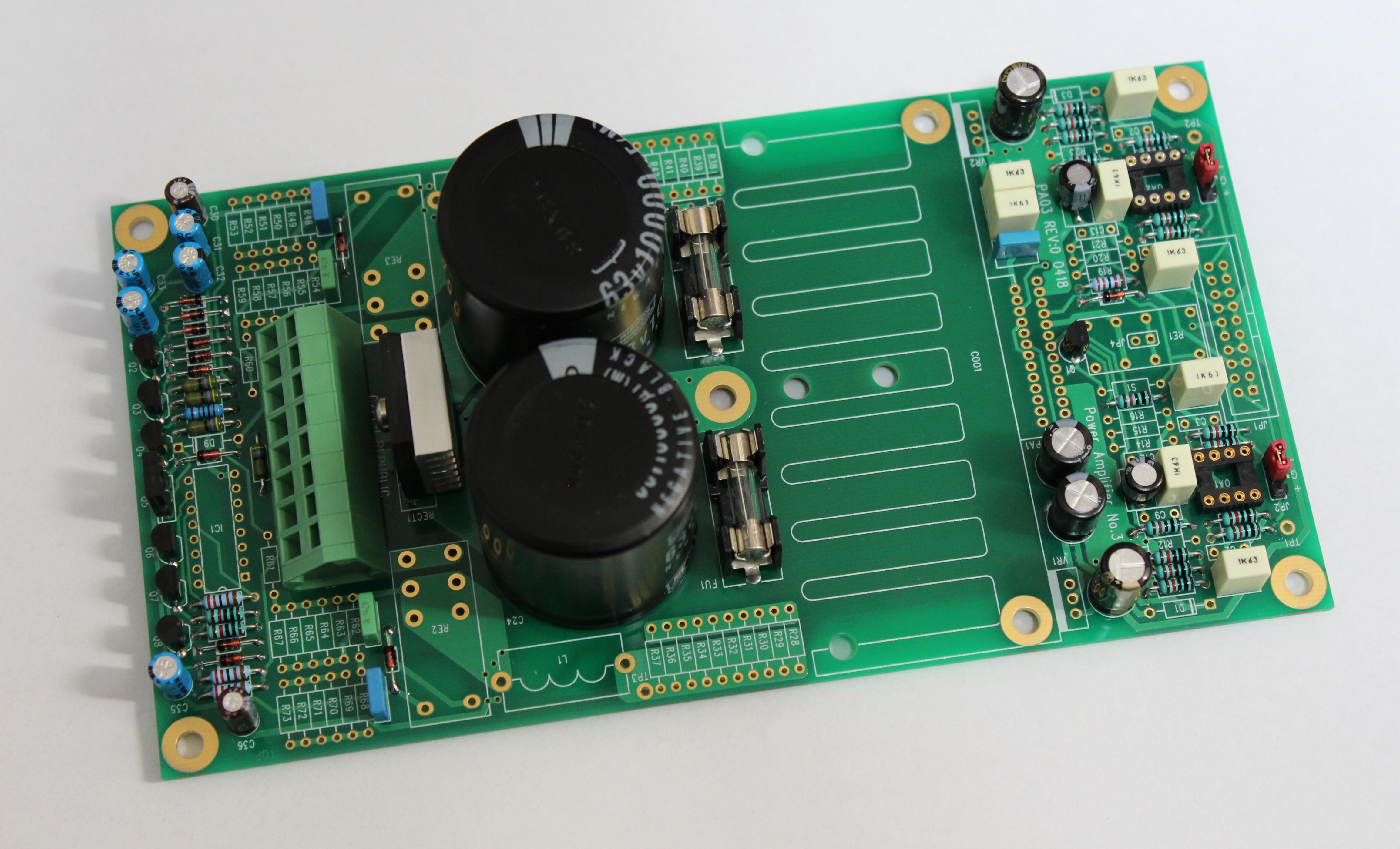

Made some progress yesterday Can't wait to power it on!
Made some progress today . The board is almost completely done. However, I still have to order a mica insulation sheet for the LM4780 and to solder the two voltage regulators to the board. In addition I will add two extra spacers to attach the heatsink even more firmly to the PCB. There are already a few holes for that in the PCB. I changed the layout for the heatsink a bit. This way the cabinet can still be 'low profile' and does not have to be that large in size.
Update: I was searching in my 'junk box' for some parts when I saw a nice U shaped piece of 5 mm thick aluminium. So after some drilling and tapping some new M3 holes the PCB has been improved . I have also added two spacers for extra stability.

Very nice implementation of the heatsink, I was thinking along the same lines as I was searching for a suitable enclosure, to mount the board horizontally narrows the choice of enclosure.

Hi! Quick question:
In the elfa BOM, C2, 3, 6 and 7 (68pF, 500V) are listed as article no 65-862-00, which turns out to be 47 pF 100V.
C9, 16 (47pF, 500V) are listed as article no 65-862-26, which turns out to be 68pF, 100V.
My bad for not reading properly what I ordered, so now I have slightly wrong parts.
My questions are:
Is the lower voltage rating ok?
If so, since I ordered just enough parts, is the small difference in capacitance vary important or can I just put the 68pF ones where 47pF ones would go and vice versa?
Otherwise my build is progressing nicely, heat sinks tapped without incident=)
