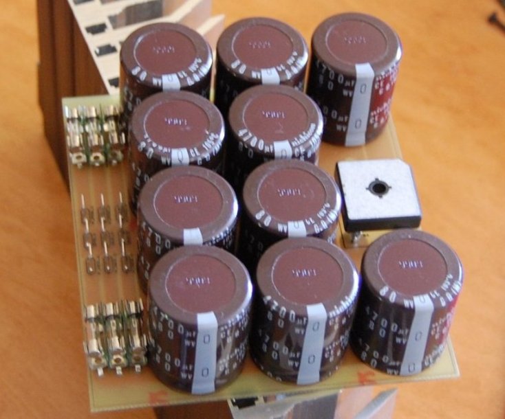

There are some full power tests further back in this thread (I think). It's in excess of 140 watts into 8 ohms. Running it on a 4 ohm load is fine but make sure there is a good heatsink. 2 ohms is NOT recommended.
The max rail voltage for this (indeed, the voltage it was designed for) is +/-56VDC. To use a lower rail voltage would require changing the frontend cascode voltage divider (specifically R4), R11 to adjust current thru the VAS and R27 to adjust the current thru the frontend. Gain would need to be adjusted also - R26.
Disabled Account
Joined 2007
The current capacity of the amp would be exceeded and the outputs would fail.
Is a 2 ohm load a serious option? This was initially designed for an eight ohm load but will do 4 ohms fine. For a 2 ohm load, rail voltage would need to be drastically reduced.

So what is the current capacity, then? Is there no overcurrent protection?
The rails will be fused for each channel, yes.
EDIT: I assume that fast-blow fuses are preferred. What value should they be?
The fuses are the overcurrent protection - there isn't any built into the amp itself.
I have 4 amp fastblows on my 6 channel:
That's 2 fuses per channel - one on each rail. None blown yet.
2pair 1943/5200 on +-56Vdc (40Vac 6% regulation transformer +-23500uF Re=0r22) can do ~140W into 8ohm 60degree phase angle
It can manage to drive a moderate reactance 6ohm speaker to about 170W to 180W, if you keep the output devices cool.
4ohm 40degree phase angle is asking too much of the 1943/5200 pair for good reliability.
3r0 is near the resistive load limit and confirms that 6ohm is about the minimum speaker load.
More robust output devices would allow slightly lower load impedances.
