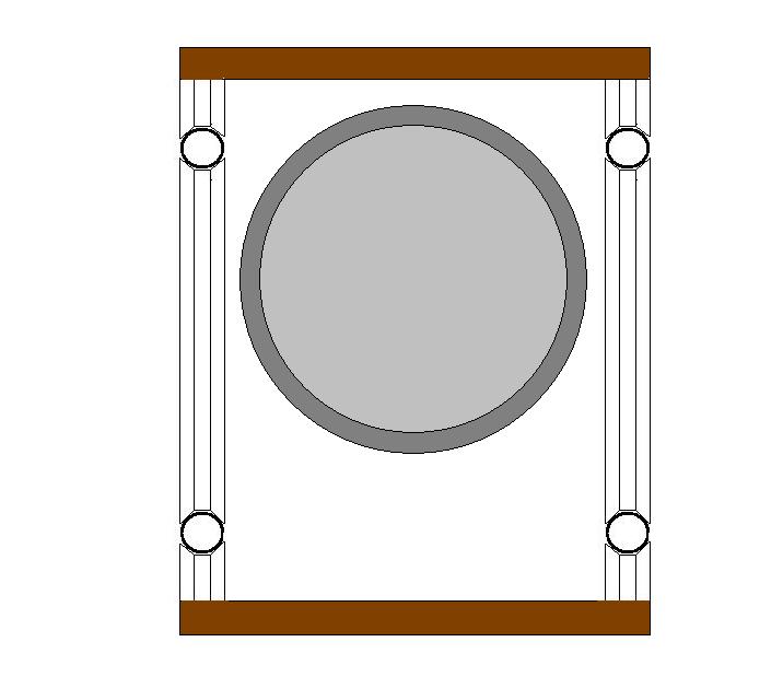

a small set of external speakers that come with my TV use a 2" Driver with an Aluminimum Hexagonal sandwich type cone,and a 3" Passive Radiator the passive radiator is two Flat aluminimum pieces with a fairly dense,rigid piece of foam between them....it was simply a flat diaphram with a Cloth Roll Surround...no spider which is perfectly fine as the 2" Driver most likely doesnt move enough air to push the Radiator to the point of needing a spider to stay linear,ill never know how good...or bad they sounded for that matter....the 2" Drivers had Foam Surrounds...which had basically Rotted away into nothing...the speakers still played though...the Aluminimum Diaphrams of course gave Bright High Notes and decent mids...the bass was non existant...or midbass for that matter...probably due to the missing surround...a search of the sony part # Stamped on the speaker reveals the speaker is still avalible....it makes me wonder if High Density foam would be good for a passive radiator...its Awfully light...and quite rigid...and those thin aluminimum sheets on either side certainly help...the question is how can you Mold your own surround?...prehaps have a Metal Mold Cast..and pour a Rubber mix in and let it harden to the Form of the Surround?...and what about the secondary suspension...(as i like to call it)...more generally called the spider...you can probablu get one of those at a speaker repair site....dont know how you can make your own,Total Linearity wouldnt probably matter since theres no voice coil to rub against the Motor structure...
wouldnt a bigger PR also result in lower Q ressonance?
Instead of ordinary spider its possible to use spider threads
Make a block of poly foam with backside shaped like a woofer cone
A wooden stick in the middle fore mounting the spider
Centering isnt exstremely important as there is no voice coil
But at this low frequency, maybe a spider isnt needed at all
Chassis could still be wood, or the box itself
Front of poly block could be anything, wood or aluminium
But at this low frequency, does a spider really make a difference
Fs surely gets lower without, with thread spider as an exception

Done it - it works!
Years ago i needed to tune something like 20L to about 25Hz. As the enclosure was a 4th order bandpass & was being fed by 8 (yes eight) 8" drivers i decided that a port was out of the question as it'd be rather big to say the least
So i designed & built an oval (race track) style passive radiator. Instead of using a bicycle innertube i used 2 motorcyle innertubes & cut each tube so i had more than half of each tube left. I know this is kind of complex so bear with me..I made two oval surrounds out of MDF & cut a nice big piece of 4mm aluminium for the diaphram. I then cut more pieces of alloy to clamp the two pieces of innertube together by bolting through & sandwiching them between the alloy plates. Copious amounts of evostik type glue to seal it completely.
The same was done on the outer surround which was obviously the frame.
Tuning it was a doddle as all i needed to do was inflate the now sealed innertube to get the correct resonance frequency via a standard air valve..Ok so it needed adjusting about once a year, in fact it leaked less than a normal innertube.
No spider needed
I ended up selling the sub to a friend who made rather good use of it until he moved to a smaller property, at which point he sold it back to me dead cheap
I'll see if i can get some pictures for you all, give me a few days.. I wouldn't hesitate to do a similar thing again, though i'd make the thing round!
It might be called crazy, but i can tell you that it worksThe third one is a crazy idea from another thread
Surround is a bicycle tube
Airpressure should keep it in place
