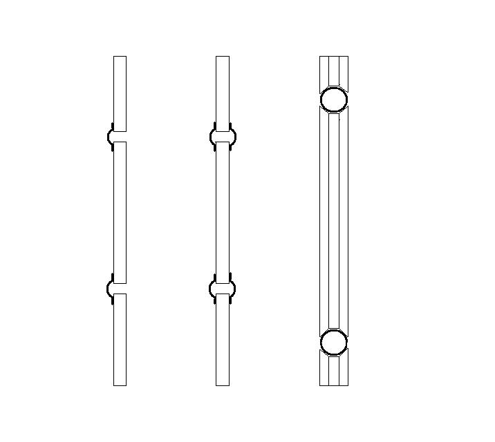

Just an idea I thought I would share with you
Commercial passive radiators does actually cost quite a lot
Chassis could be simple plywood
Or if proven to work, constructed directly into the sub
Surround should be available as repair component
The passive cone itself could be anything you can imagine
From the most simple to advanced laminated materials
The third one is a crazy idea from another thread
Surround is a bicycle tube
Airpressure should keep it in place
Thats the cheapes one
But may take some experimenting
But thats the fun part, right
Have fun :)

Funny, i was just thinking of the same exact thing the other day. Two sets of surround with some offset between them should keep the 'cone' moving in one axis?
The bicycle tube idea looks real neat, but would be hilarious, as well as embarresing, if the sub literally blew up (both PRs cones bust out) during a loud explosion while watching a movie.
Tinitus, I made something like #1 many moons ago. Found it to be too much work when what Collo suggests is a good starting point. A plywood "basket", a piece of wood paneling, the sidewall of a small bicycle innertube, rubber cement and a whole lot of staples. Thanks for the memories.:)
I wonder if you would need a spider and dummy coil assembly to keep everything moving in one axis?
Probably a good idea but some manufacturers do make the "flapper plates"
Some MDF with a bolt epoxied onto the coil former would accept the weights.
You can also add weight by filling the dust cap from the rear and painting the cone with multiple layers of PVA glue. To get really funky, you paint small coins onto the cone with it.

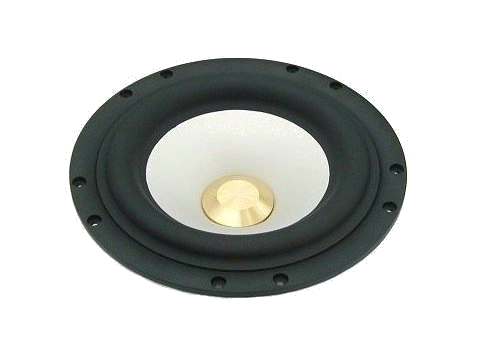

The one I heard at båndseis place was just a rather cheap dayton, but careully adjusted with weight
How is this ScSp 10" fore a passive radiator, at 150EUR
And maybe you need two of them, pr sub
Thats a lot of money

The middle example in Fig1 is the SLAPPS principle. It should work very well, and replacement surrounds are available at a reasonable price. I suggest the PR should have up to 3x the Vd of the main driver, so use a bigger PR than your driven woofer. The Cerwin Vega double roll 'M' type are only a bit more than the common types, and they can move further.
Another thing you can do is nestle a smaller surround inside of a larger one. Philips has a patent on this idea, they have a narrow ring between the two surrounds.
