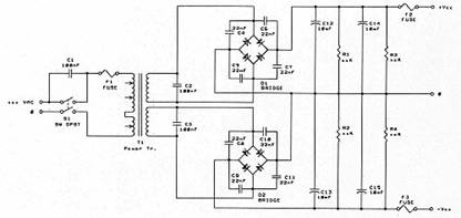

so you think i should make something like this? i have 4 33,000uf caps, so 66,000uf per rail...

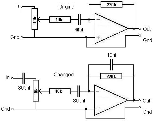

feel free to change the diagram/call me stupid if i have got it wrong. the info is scattered across several posts. :(
thank you so much for your help so far. :D
[edit]: duh! forgot the image. :dead:
The PSU schematic you have is OK, if a bit on the complex-for-what-you-need side. There's no need to use 2 bridge rectifiers (as you will get 50Hz instead of 100Hz ripple, which is harder to filter out), or that many snubber caps across the bridges AND transformers, or the bleed resistors across the caps (as the amp will discharge the caps anyway).
Is perfect for what you need (using 18-0-18 not 25). Add more capacitance if you want, but I'd be tempted to save a couple of those big caps of yours for another project. Also EITHER add 47nF caps across each diode of the bridge, or 100nF across each side, i.e. ac and dc.
Your amp schematic looks fine with the exception of the 800nF caps. Leave the one on the pot wiper at 800nF and either make the input one 10uF or ditch it altogether, as the CD player will have an output cap anyway.
You could also add a 470nF across the pot and then put a 4k3 in line to the input to add another (passive) low-pass filter, to make it 12dB/oct overall with the active filter on the amp.

could you draw on my diagram? dont worry about being neat. :D
i have just remembered, the caps are 16v so the power supply will have to be exactly 15v or less. i can only get 25v secondaries or more. could i get a 30v secondary, and somehow use the socondaries to get 15-0-15v? i cant remember if they will become 15v if i put them in parallel. i am going to buy 2 transformers anyway (300VA), so i can just use one for eaach rail.
I wanted to draw on your schematic, but I am at work ATM and cannot access FTP to upload any pics...

The smoothed DC voltage using a bridge rectifier like I showed you earlier will give you AC * 1.414 volts. So if you want a 15V supply you need 15 / 1.414 = 10.6V.
12V transformer will give you 12 * 1.414 = 17V
The bridge rectifier will drop a volt or so, you you will just wing it.

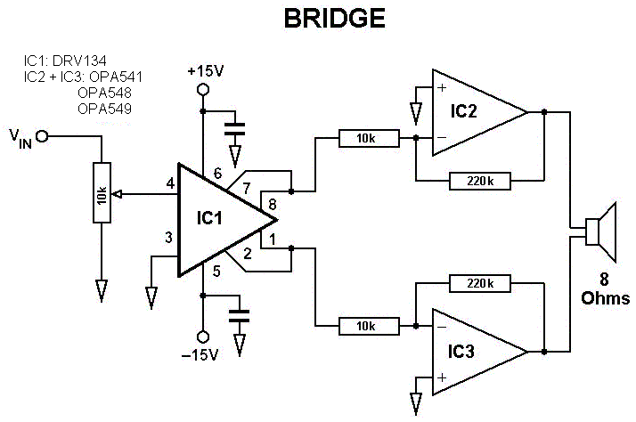

The only problem is, because you want to stick with your low-voltage PSU, you need to make a bridged amp to get enough power. So that means you either
1) build one amp as per the filter schematic and another just with equal resistors for Rin and Rf and no other components, then connect this unity-gain inverter to the output of the 'master' amp.
2) build 2 identical chip amps as you originally intended and make an active filter and bridging adaptor (unity-gain inverter) from op-amps.

could you draw a diagram for bridging, i have this one, but you dont say anything about an extra chip. i have some DRV134, so i can use these. what do you think?
