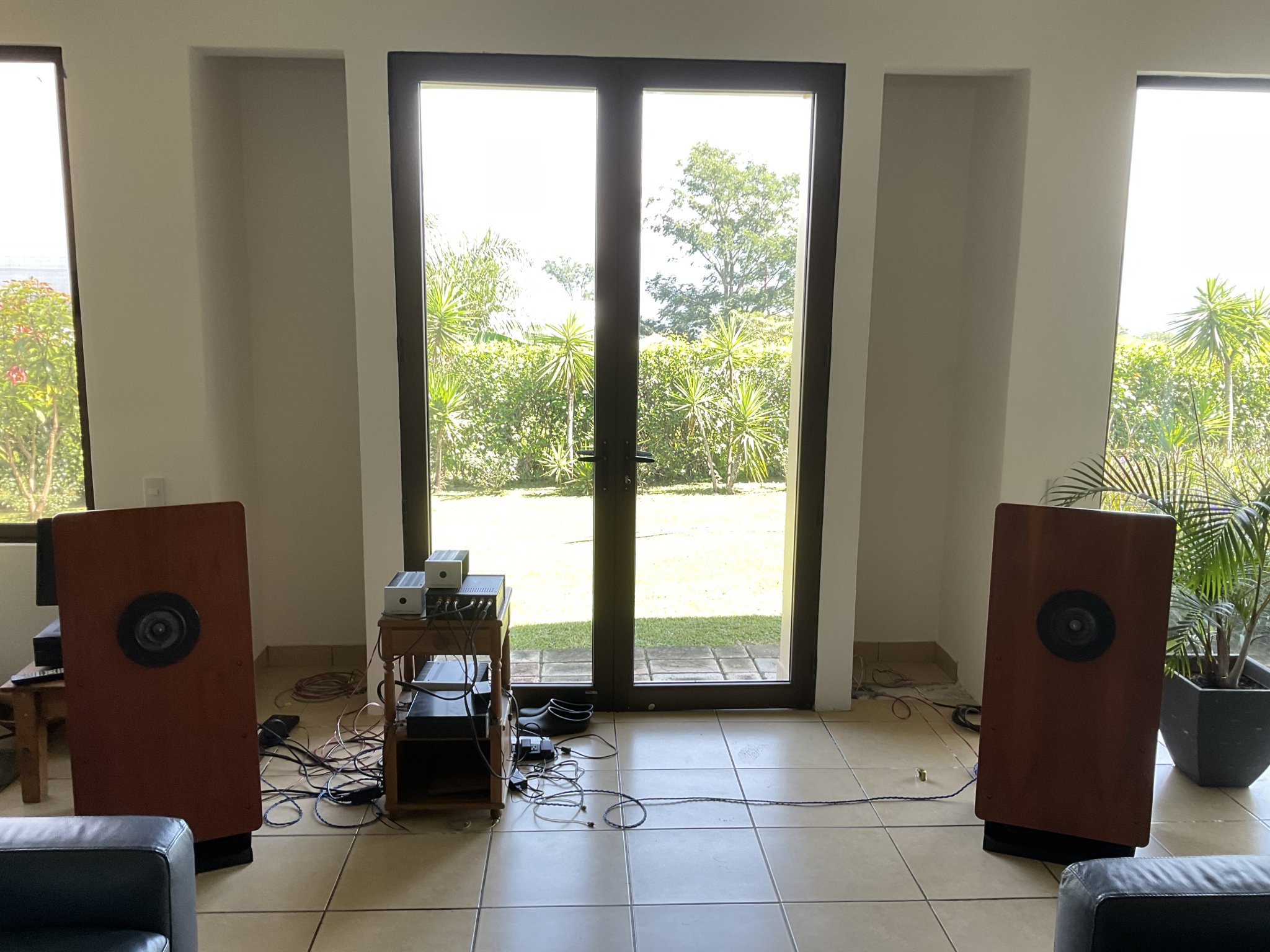

4 channels of ACA, N P told me how to mod the crossover for the drivers which are the awesome SAL ones we sold for awhile in the store. Woofer is Hawthorne Audio Augie 15” (made by Eminence) Both driver companies are out of business.

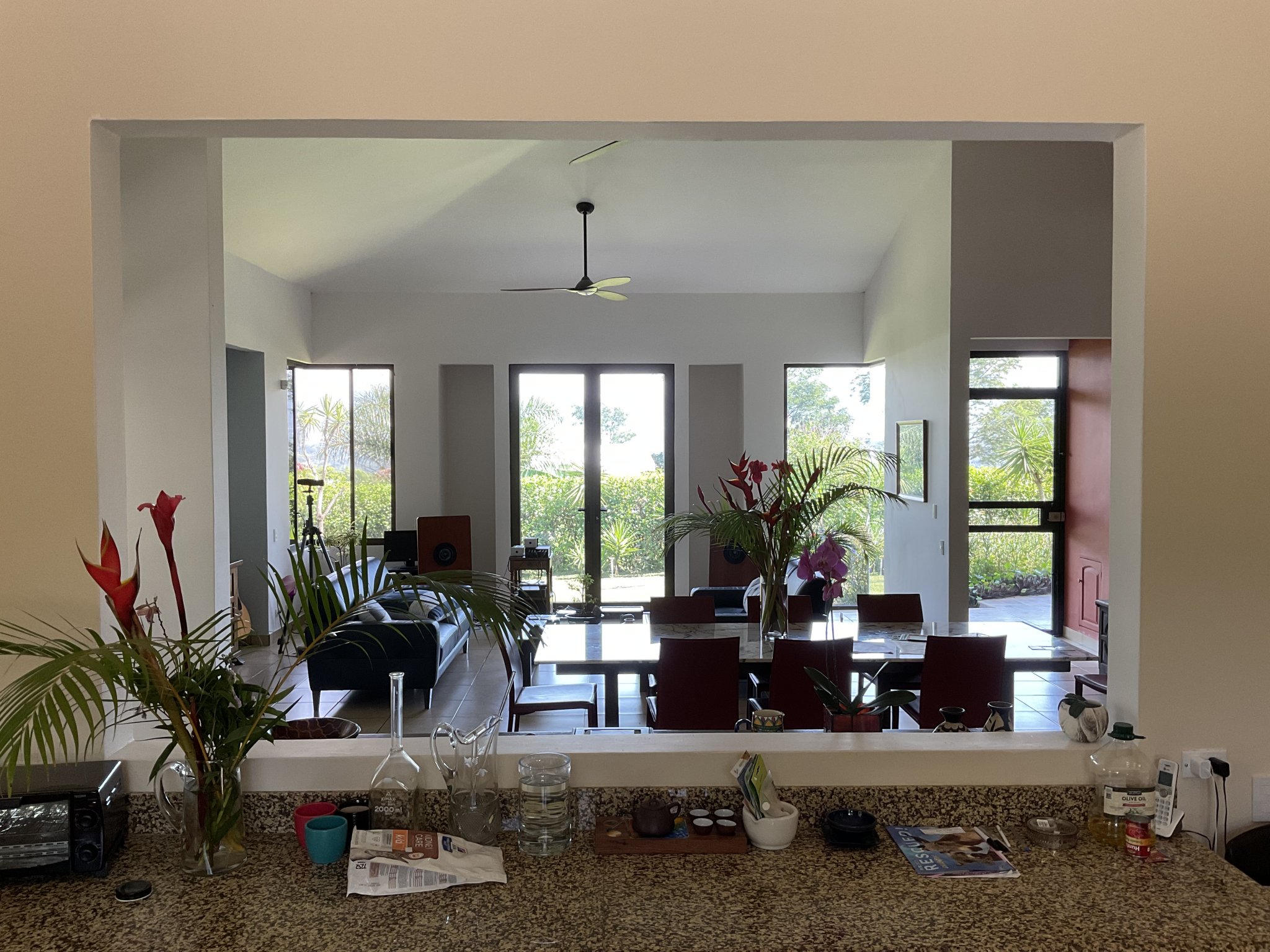

It’s a pretty large room, 9x10M, and the second photo show the way it connects with the kitchen. It’s a bit live, with rather a lot of hard surfaces.The OB radiation pattern helps a lot, as the tall ceiling is also reverberant. They sound spectacular, mostly because they aren’t close to any walls. The high’s and low’s are not super extended, no silbilence in the highs, no boom in the Bass…But the SAL tone just takes your breath away for the beauty of the notes!
Finally, a system that could still be tuned a bit (I have the PASS VFET amp kits to build) but I love it!
