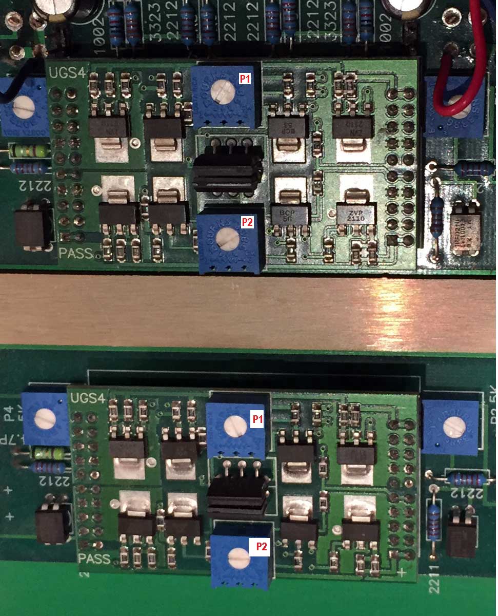

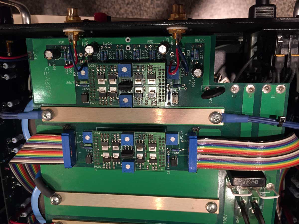

i cannot figure out how to attach images to this website, but the insides look entirely stock and unmolested.
I looked at some prior posts of yours and while i had the lid off did a few measurements with a digital volt meter and got the following readings after the unit had been powered up (fully) for about 30min:
Main board pins: 0.106 for one side and 0.109 for other ( slightly higher than the 0.94 referance)
Right speaker term output: btw 0.218 - 0.224 btw positive and negative; and 2.48 & 2.25 against ground (the housing of the amp)
Left output: 0.0 btw positive and negative; and 0.15 & 0.15 against ground (the housing of the amp).
Not sure how helpful this information is. If you send me an email adr - i will send you pics directly if you like.

there are 3 things nee to be taken care of :
1.
Iq - 106mV and 109mV are practically the same (2.8% diff.) and - if your heatsinks aren't too hot in your environment just leave them be ..... diff. to 94mV is measly 10% up anyway
2.
differential offset - DC voltage between speaker terminals - ditto OK on left channel (say that 50mV and less is allowed for home amps , either positive (+50mV) or negative (-50mV) , while right channel needs correction
3.
absolute offset - DC voltage between any speaker terminal and gnd ; it isn't so critical (say up to 500mV in temp equilibrium ) but if not set properly , it'll chip of one half of voltage amplitude ( take it as one half of output sine shorter than other ....... so clipping sooner than other one ) , while also sliiiiightly influencing linearity on much smaller voltage levels ,below clipping area
so , few preparation steps :
- take 2-5cm wide sticky paper tape , put it all around edge of top plate/cover of amp, to prevent scratching while manipulating with cover ;you can make few loops of tape as handles , to ease pulling it away from amp
-prepare two DVM's - connect one for absolute offset (probes on terminals) , connect second for relative offset (one terminal (any)) and gnd ; case gnd is good enough
-nice ,wide,proper screwdriver for these blue bugger pots ;
now - look at pictures you sent me - I labeled pots on UGS pcbs ( that's all you'll need to fiddle with - leave those at main pcb as is) .
case 2. differential offset - attach DVM's as explained - to one channel , UGS closer to connectors is for left channel , while UGS closer to xformer is for right channel (as written on speaker terminals) .... that speaking of UGS to output terminals correspondence
now - all inputs grounded ; most practical way is to put shorties on XLR's (pins 1 and 3) and on RCA's , so practically pin 2 of XLR is also shorted to gnd ; no dummy load on speaker outputs ;
power up amp , let it cook to temp equilibrium , with top cover in place
open cover , then slowly fiddle in one way (or another - DVM will tell ) with P2 , to decrease existing offset (observing DVM between terminals) in half , no more ; put cover back , let it stabilize
repeat previous step , as many times is needed to achieve decent small offset between terminals
now - case 3.
open cover , then slowly fiddle in one way (or another - DVM will tell ) with P1 , to decrease existing offset (obser4ving DVM between terminal and gnd) in half , no more ; put cover back , let it stabilize
repeat previous step , as many times is needed to achieve decent small offset between terminal and gnd
NB that one setting will slightly influence other one , but you'll repeat it few times iteratively and get done
when done with one channel - move to second one and do all that again
remember that each time put cover back and let stabilize , in between steps
OK , that's it ;

Official Court Jester
Joined 2003
t......
-prepare two DVM's - connect one for absolute offset (probes on terminals) , connect second for relative offset (one terminal (any)) and gnd ; case gnd is good enough.......
I knew it , brainfart .
it needs to be written as :
-prepare two DVM's - connect one for differential offset (probes on terminals) , connect second for absolute offset (one terminal (any)) and gnd ; case gnd is good enough
