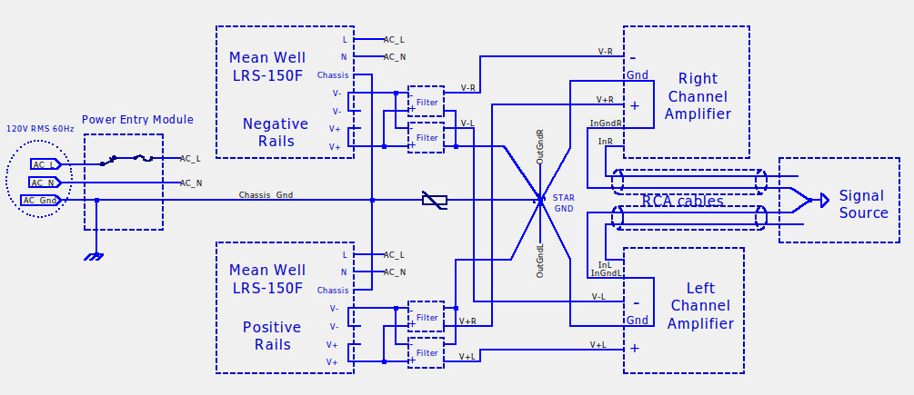

I tested two RC filters different connected either SMPS->RCfilter->F5mPCB or SMPS->StoreFilter->RCfilter->F5mPCB.This is a really good illustration of the importance of a proper grounding scheme.

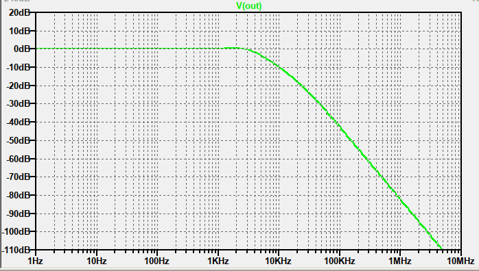

The RC filters were 0R22 and 22mF and 0R25 and 3.3mF. The filters didn't reduce the 60Hz harmonics enough to be worth the space and added PS impedance.

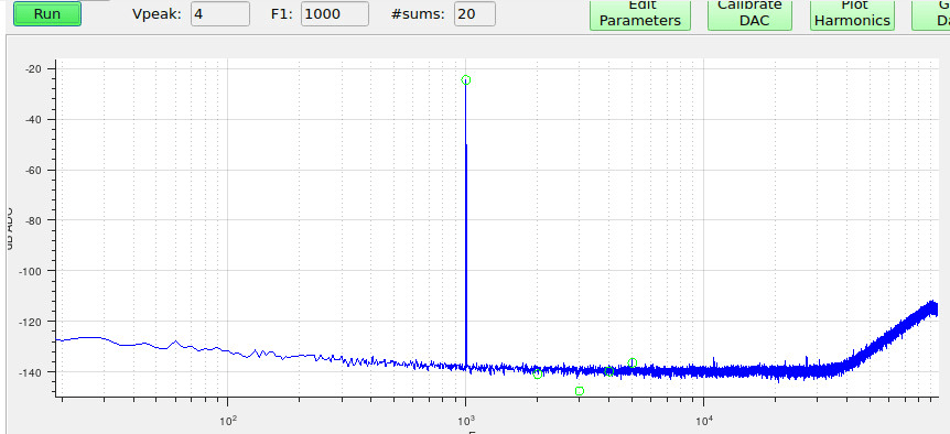

The inherent noise floor of my spectral measuring system is limited by characteristics of the M-Audio AP192 sound card and the external "wiring" to the deviced being measured.
This image shows the loopback spectrum of the soundcard with wiring analogous to that when measuring the F5m. The rising noise level starting at about 40kHz is due to the noise shaping of the DAC and ADC in the AP192. This needs to be taken into account when evaluating the spectral measurements of the amplifier shown in the previous posts. As can be seen, the noise levels from the amplifier are near the underlying noise floor of the measurement system, with the exception of a few low level harmonics of 60Hz (around 25uV rms) and some low amplitude SMPS noise at around 40kHz-60kHz,
By careful implementation of the star ground topology shown in the second image, the noise levels were well below 100uV rms.
Bottom line: These Mean Well supplies should present no significant noise issues, particularly when good grounding practices are used.

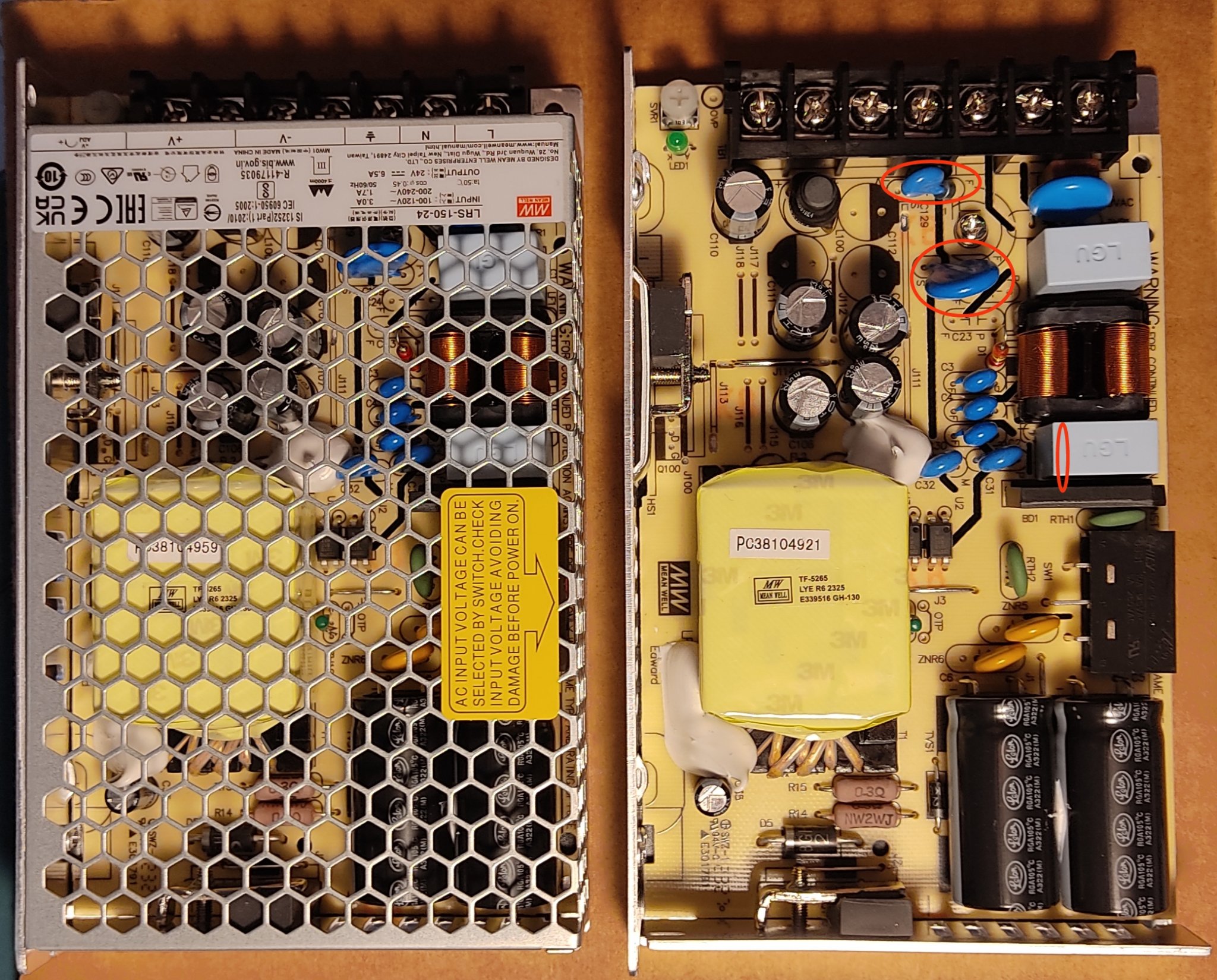

These Mean Well power supplies (I bought two LRS-150-24) have small ceramic capacitors between the negative output and ground. Mine has two ceramic capacitors in this position. My question is if you think these small ceramic capacitors can create problems, like high frequency ground loops or something? (and thus better to be removed in case +/-24V with center " tap").
