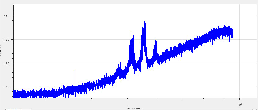

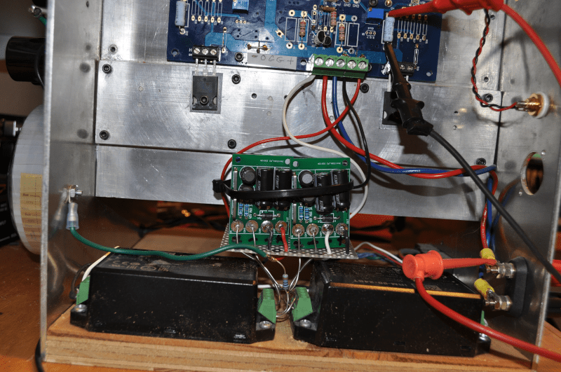

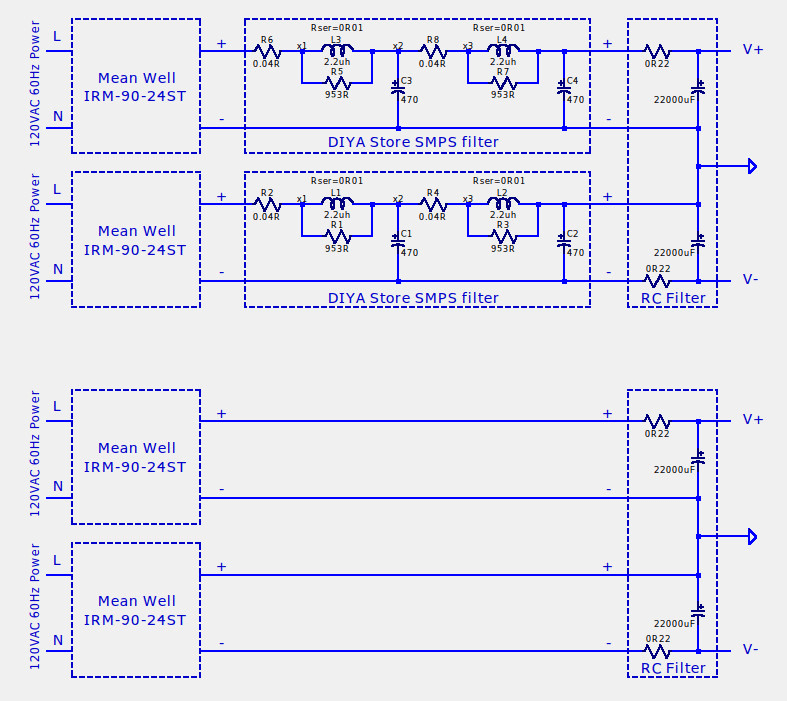

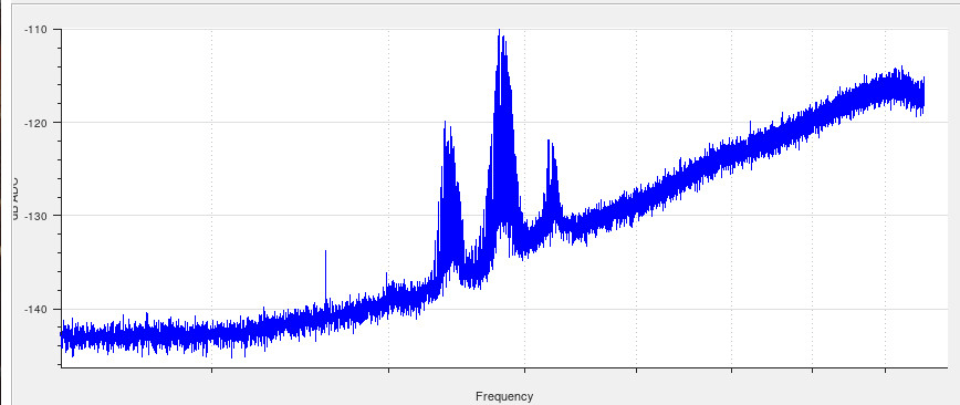

I added Store SMPS filters between each SMPS and its RC filter. There was no significant change in the low level noise in the 55kHz region of the spectrum.
The second image below is the noise with the SMPS filters. The third image is without.
I explored some other mechanisms for the noise coupling but could not find anything that changed the things.
Bottom line: The noise level of very low and mostly outside the audio spectrum.

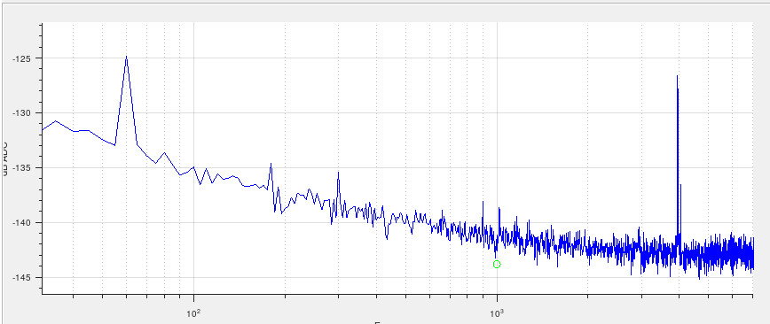

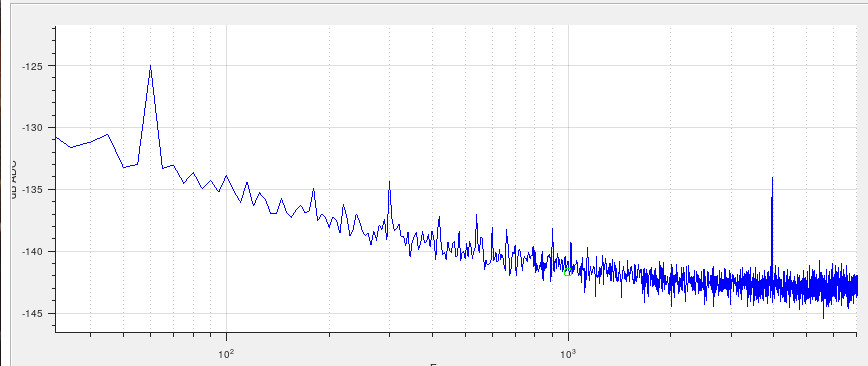

The 4kHz spike is still there. My earlier screenshots did not accurately resolve the height of the peaks. I do some more spectral measurements, both with and without the SMPS filters.
The first image is WITHOUT the filters, showing both the 60Hz noise and the 4kHz noise, which is at about -125.5dB.
The second image is WITH the SMPS filters, showing the 4kHz peak at about -134dB, which is a reduction of around 8dB.
There was no improvement in the 40kHz-60kHz range.
I seem to see a 4 kHz spike? I am accustomed to spikes above 20k with switchers.
I am unable to find an explanation for that 4kHz spike. It is 100% repeatable and only occurs in the channel with the SMPS. I have looked for instrumentation problems with no success.

That 4kHz spike is still a mystery, but is at such a low level that it should not have an audible affect.
With only the RC filters, the spike is 103dB below the 1 Watt into 8 Ohms, resulting in an amplitude of about 20uV at the amplifier output.
With the DIYA Store filters and the RC filters, the spike is 110dB below the 1 Watt into 8 Ohms, resulting in an amplitude of about 9uV at the amplifier output.
