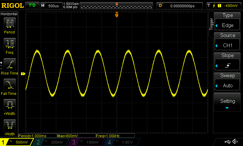

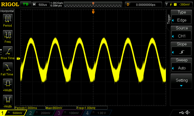

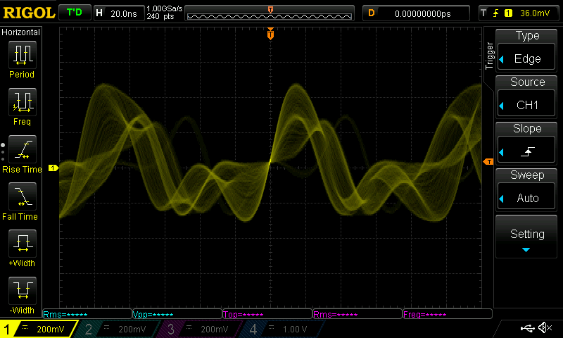

Things are getting weird. Remember that the amp works and sounds fine (although I admit I only tested it on some cheap speakers so far).
I attached the Focusrite 2i2 balanced to the amp input and generated a 1 kHz sine wave. I attached a Rigol probe to one of the inputs (+ or -). The amplifier was turned off and I got this on the scope
It is not perfect, but it is as I expected a 1 kHz sine wave.
I then switched the amplifier on and the scope screen changed to
Where did the fuzziness come from?:confused:
I interpret that the input is somehow changed by switching on the amplifier. I assume this should not happen. What could cause this?

For a start you should not be concerned about the FFT spectrum when doing basic functional testing. It will be much easier if you just leave that feature turned off for now. What immediately comes to mind when looking at the input waveforms is where do you have the scope probe ground lead connected and also how are you connecting the balanced input signal to the 1.7 board. If the focusrite is truly balanced you only need to connect the + and - signals - (Pin 2 and 3 on an xlr connector) You do not need pin 1 at all. If however, like some low priced balanced pro audio gear, the output of the focusrite is not truly balanced then you need to connect pin 1 to the 1.7 to get a quasi balanced signal.
If you connect your scope probe directly across the output of the focusrite with the 1.7 disconnected what does the waveform look like?
What does the 1.7 output look like on the scope with the input signals you are measuring above. Measure each phase of balanced output with respect to the circuit ground.

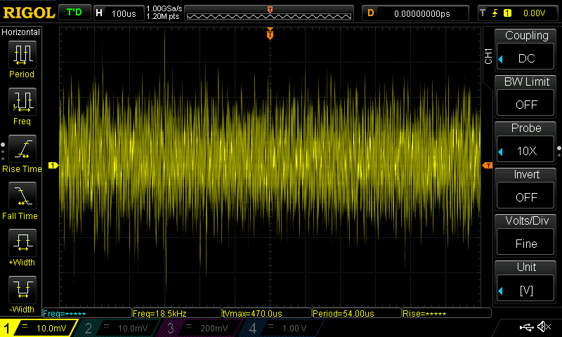

Some interesting measurements today!
1000Hz sine wave, -3dBFS, REW signal generator through Focusrite 2i2.
No difference whether laptop was powered by battery or AC.

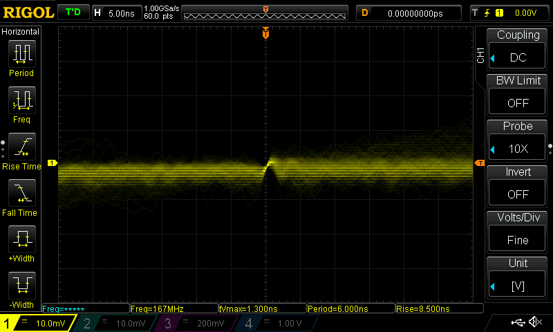

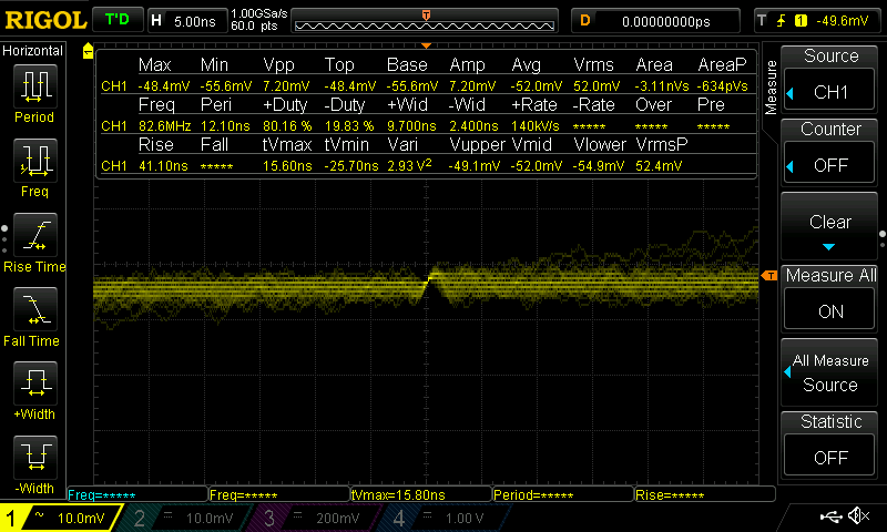

2i2 to Rigol, probe connected at pins 1 and 3 of 3m XLR cable. No connection to amplifier.
Noise (5 ns horizontal division)

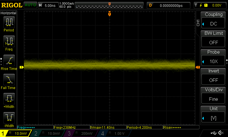

For comparison, Rigol probe shorted. Same 5 ns horizontal division.
Is the XLR cable noisy? Probe connected directly to 2i2 to eliminate cable. Same output.
Same but using different time/division (100 us).
2i2 seems to have proper balanced output. Images of pins 1+2 and 1+3 look the same. Output of pins 2+3 looks the same but double the amplitude of 1+2 or 1+3.
Next the AP1.7 meaurements.

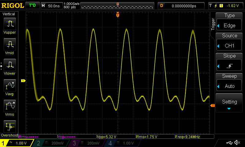

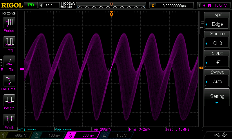

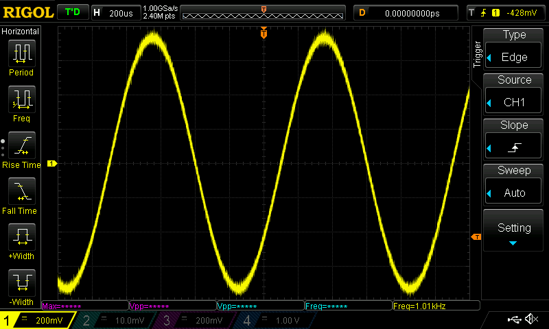

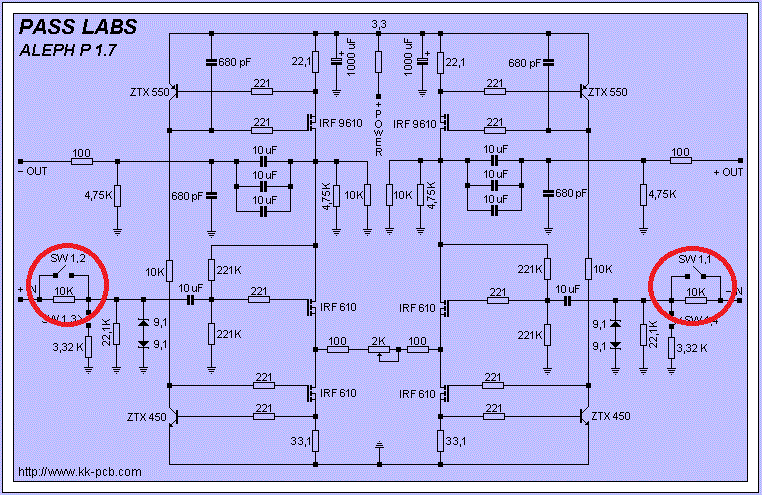

I had been thinking before that it seemed as if the input (measured at the input!) was distorted by the amp circuit. I had checked all resistor values between the input and the active part of the circuit and found nothing wrong (or any other resistor for that matter). Then I realised that I had listened to the amp connected to a diy F4 and had set the amp for maximum gain, including bypassing the 10k input resistor.
After switching the 10k back into the circuit, the shorted input looked a lot better!
The outputs with shorted inputs looked better too!

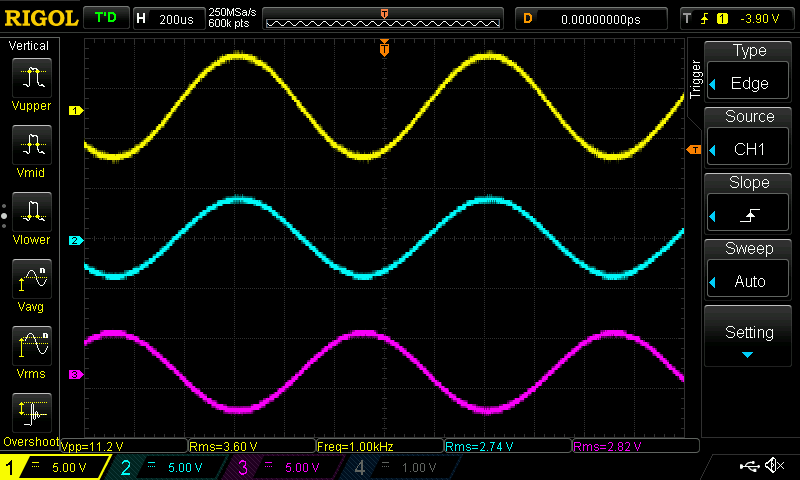

So, back to the signal generator. 1000Hz sine wave as before. This is what the input and output look like with the 10k resistors in the circuit.
I tested the other channel as well and it is also fine.
What did I learn? Well, besides a lot about my scope and other test and measuring equipment an important lesson was to trust my ears because the amp sounded ok.

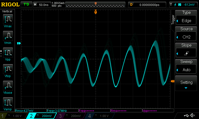

Joined 2016
With regard to #547:

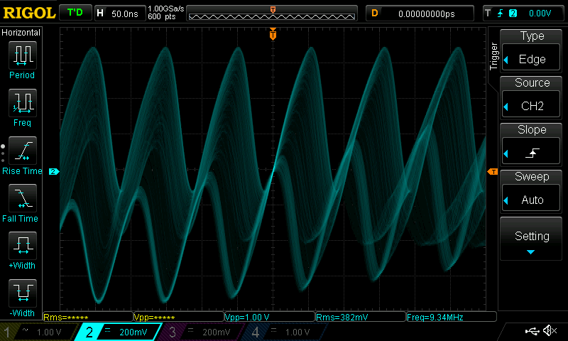

That looks like oscillation to me ... :eek:
Inputs grounded, no signal in, right ?
The amp could still sound OK because the 400-500 mV of multi-MHz oscillation is just riding on top of the audio signal. But it is an additional stress on the amp and the components, and maybe on devices downstream.
Now, the interesting question: how to tame the oscillation ? Here the people who have experience with this circuit need to chime in ...
With regard to #548:
That looks good !
What I don't understand at the moment: Why was the amplifier oscillating with the 10k Ohm resistors bypassed but the inputs shorted to ground ?
Best regards,
Claas
That looks good !
Best regards,
Claas
Hi Claas,
I don't understand it either. As a guess I think that the oscillation originates at the gain 610's but that is mainly because they are closest (their gates connect to the input through the 10k resistors). Could be something else entirely haha.
If I understand the user manual correctly, bypassing the 10k resistor is the default setting.
What I find interesting is that the user manual does not specify that the input impedance is changed (which I assume it is) by the switch.
More measuring I think to see if I can locate the source of the oscillation. No idea what I am looking for but that should not deter me.
Albert
In post 547 it looks like you have an oscillation. If you can duplicate those conditions again and see the same behaviour, have a look at the power supply to see if it is clean or showing oscillations as well. One thing you can do to help prevent oscillation in the current sources is to increase the value of the base or gate stopper resistors. I think I changed mine from 220 to 470ohms. Which circuit board version are you using?

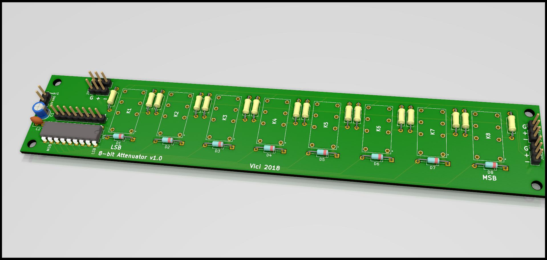

I've been reading through most of this thread, as I have a set of reliable borads that I made almost 15 years ago. Other things happened in life, and the boards have been sitting in a drawer up unitl now.The boards are OK and easily solderable even after these years, as they were originally chemically tin plated.
But - my question concerns remote control. I dropped out of programming 30 years ago, abd have not kept up with modern controllers and programming systems.
Has anybody looked into a control processor that will fit with the original design?
The board I used was given to me by a diy audio member and resembles the volume control of the original design, but it only uses 7 relays instead of 8. It is designed to use a pot and an adc chip to control the relays. I decided not to use the pot and adc but control the relays directly from an arduino based control board.

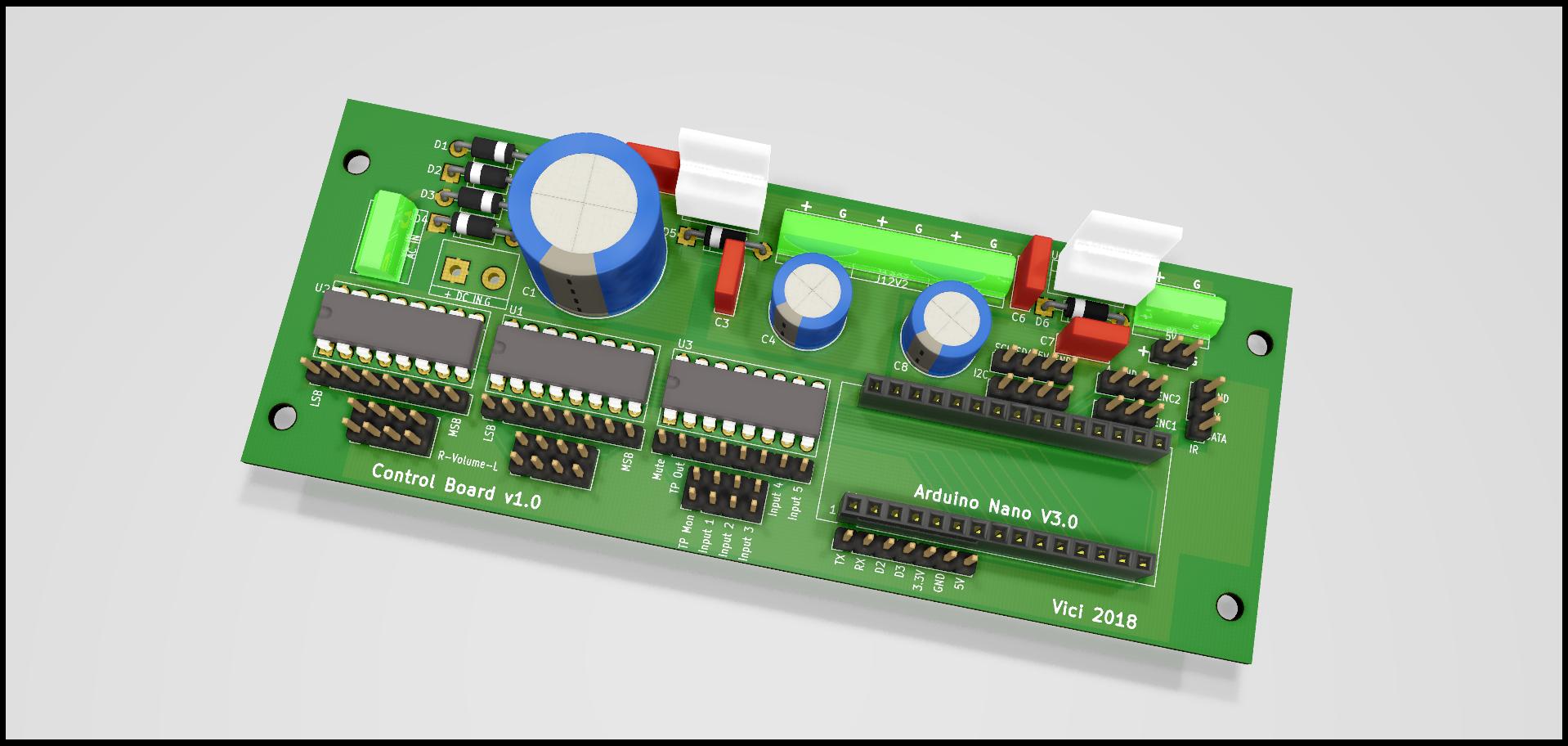

The control board has 8 separate left and right volume bits that can be switched on and off. I take the output of a shiftregister (on the control board) to drive the relays on my AP1.7 board (instead of the pot and adc). It was simple enough to design the software so it can work with either 7 or 8 bits.
I use it with IR remote control and a 16x2 display. The board is designed so that perhaps in the future I could use rotary encoders, but for now just IR remote is all I need.
I have also made a volume board that follows the AP1.7 original design.
It will (eventually) replace the Dantimax boards I had been using in an AP1.7 a friend of mine built using KK boards.

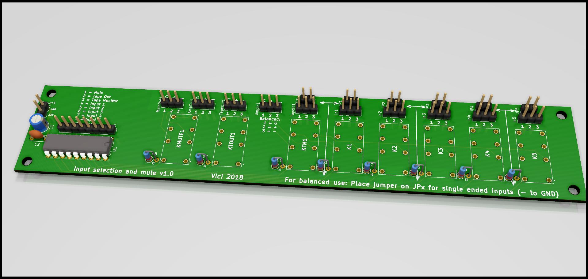

Finally, I made an input selection, tape monitor and output mute board. It is also controlled by the control board above. It can be used for single ended stereo or balanced mono.

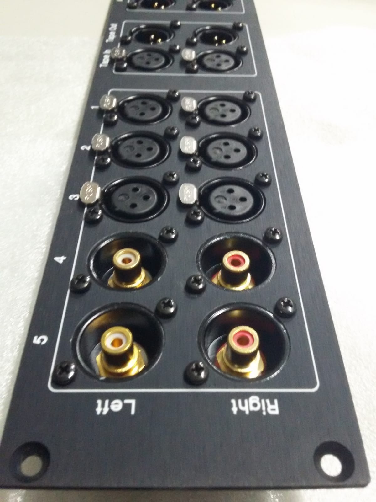

I use a mix of rca and xlr jacks on my rear panel.
When using single ended inputs you should ground the IN- (in the above example for inputs 4 and 5). I am not sure how the Dantimax boards do this, but I designed the board so it could be used with any mix of rca and xlr connectors and simply install a jumper for rca inputs (grounding IN-).
Note that this was my first attempt at designing boards and working with arduino's and I am still debugging my amp haha.
I would recommend you download the arduino development software at www.arduino.cc (free!) and order a simple arduino uno at aliexpress (or ebay or whatever is convenient) for a couple of €. https://www.aliexpress.com/item/hig...-Arduino-UNO-R3-NO-USB-CABLE/32697443734.html and You can follow the many tutorials and examples on the web.
The arduino uno uses a ATmega328P 16MHz 8 bit processor with 32kB program memory and 2kB or sram. Plenty for this type of stuff.

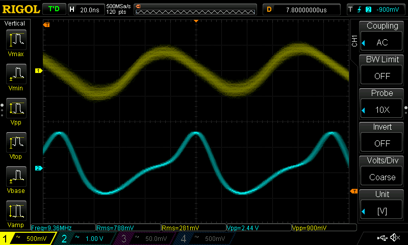

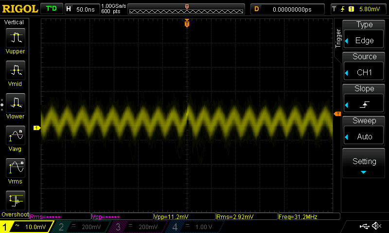

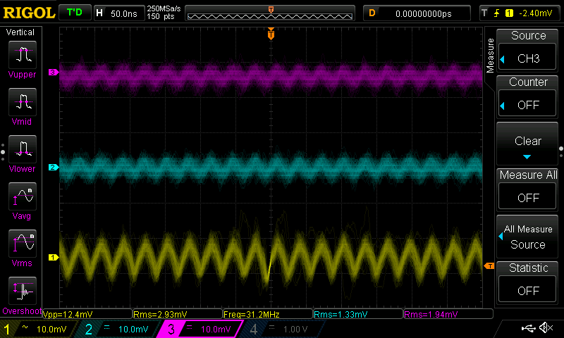

Hi Gerd! Still hunting for my oscillation!

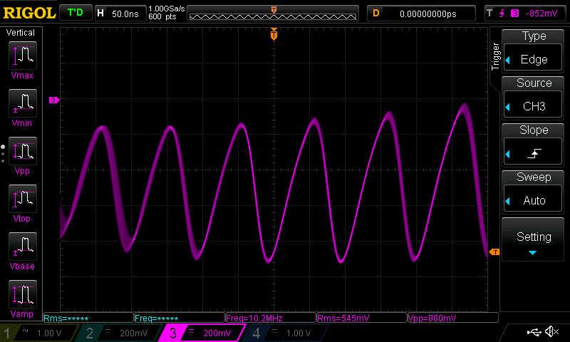

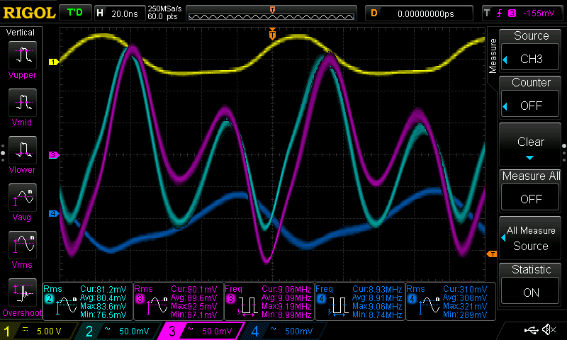

I made some more measurements today. Following Brian's suggestion I had a look at the output of the powersupply.
There is noise (a noisy, rough sine wave at somewhere between 30 and 40 MHz; not shown) and it is larger on the amp side of the 3R3 resistor that connects it to the PSU than at the PSU side. Assuming the 3R3 resistor attenuates the noise, I conclude that the noise originates from the amp and not the PSU. This seems to agree with the fact that the oscillation is affected by the 10k input signal resistor.
What bothers me about the oscillation that I see at the input is that it not a clean sine wave. I assume it is the result of the original sine osciallation interacting with the circuit.
731165d1548326609-pass-aleph-1-7-preamp-builders-thread-ds1z_quickprint34-png
I put my probes across the 680pF capacitor that sits across the ZTX550.
attachment.php
Again, the PSU side (CH2) is smaller than CH3 (same 50mV scale)
Leaving the CH3 probe in the same spot, I moved the CH2 probe to the 2k trimpot (in my case a direct 0R connection because I wanted maximum gain). Note that CH2 is now on a 500mv scale and CH3 is on 100mV.
attachment.php

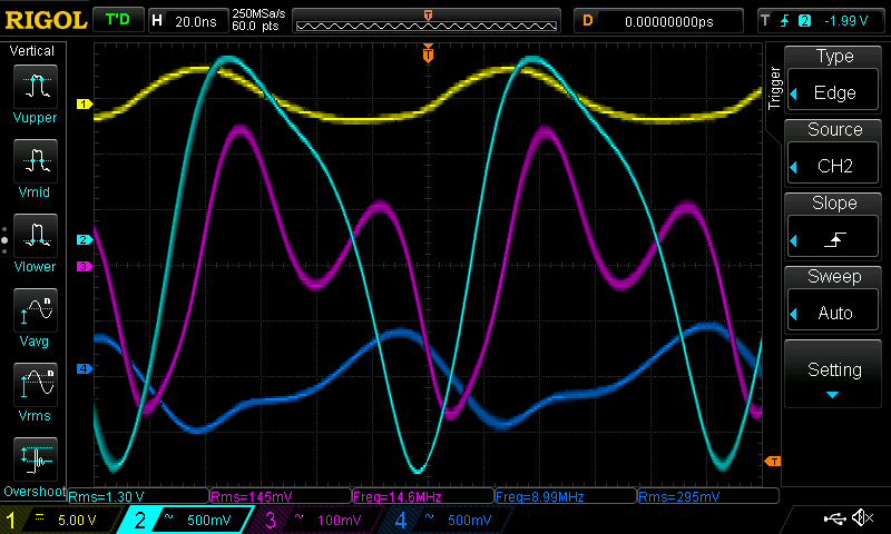

When I disconnected the link between the + and - side of the amps (removed my wire in the spot of the 2k trimpot) the screen only changed marginally. Nor did it change when I moved the CH2 probe from the + side to the unconnected - side of the disconnected 0R resistor that sits in place of the 2k trimpot.
What happens when I measure the source and drain of the middle/gain irf610?
CH1 connected between 10uF and irf610. CH2 connected at connection between the 2 irf610's.
attachment.php
I note that CH1 shows a relatively smooth sine wave.
Back to my original observation that the osciallation is much greater when the 10k source resistor is bypassed. The input is connected to the gate of the gain irf610 (via 10uF and 221R in series). It is also connected the ccs irf9610 and gain irf610, but this is via a 221k resistor so I assume that the extra 10k that is bypassed (or not) would not have such a large effect.
Based on this I hope the gain irf610 is the culprit. I intend replacing the gatestopper by a larger value (470? 680?) to see what happens. Problem is I will have to remove the board from the case, unsolder the 221R's in there, etc.
I would appreciate any suggestions.
Thanks,
Albert
