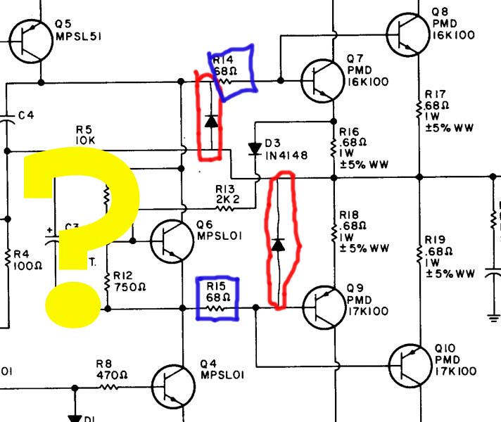

Nelson Pass said:
If you put a large cap across the bias transistor and reversed
diodes from the + and - of that cap to the output it will tend to
kill the turn on thump.
I seen from the modified close-up of the schematic where Mr. NP suggested diode placement to avoid turn on thump, but one diode is in front of 68R and they other diode is behind 68R. Does it matter at all? Is there a preference? Should I even bother adding these diodes to my boards?
Cheers.
Nelson Pass said:
It doesn't matter much. If you take the
diodes out, then you can experience more turn-on thump"
:cool:
Thanks, I'll keep them in and place them before the 68R's. :up:

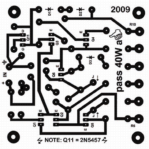

Can I continue for advice? I'll try anyway...I guess this is where I'm at:
1) Change C3 to 2200uF 6.3V low esr electrolytic
2) Leave C2 as 220uF 6.3V Tantalum or low esr electrolytic
3) C1 300 pF "expensive" film foil type
4) C4 20~100pF either silver mica or film foil
5) Q11 2N5457 (i've changed my pcb layout to accept it)
6) Q5 MPSA56
7) Q1,2,3,4,6 MPSA46
8) Q7,8 TIP142, not matched
9) Q9,10 TIP142, not matched
10) Add two 1N4004 diodes across 68R base resistors to output
11) I've matched all of the transisitors to be the same from left to right channel and have matched the input differential pairs with each other(from a set of four the same). I measured hfe using a Mastech DVM.
Oh yeah, my rails are a little lower approximately +/_25 VDC from a 18-0-18VAC, 250VA transformer, one for each mono block.
I have the metal work, power supply, basically everything and I'm am almost ready to assemble. I think I may use 3 pairs of outputs per monoblock vs. the orriginal 2 pairs. And I have 80,000uF of supply caps at 50VDC and I may add another 40,000uF if I add the extra output transistors.
ANY suggestions would be very welcome.

Thanks Eric, woody and amp-guy for your input.
My two pcb's are stuffed and after taking readings from each board to compare, everything is exact but the measurements on Q11. They're NOT matched and my understanding is that the feild effect current source will not vary each channel from the other, still I wonder if I should pull them and match them anyway? Any thoughts?
After that, I guess its just a matter of etching my power supply boards and begin testing everything with some DC flowing.
Thanks again to NP and the "chaps" here @ DIY Audio.
I don't think matching those fet current sources makes much if
any difference. I would be more concerned about matching the
voltage drop across the 1n4148 pair of diodes and even here
if one set measures say 1.25v and the other 1.35V i wouldn't
be concerned.
