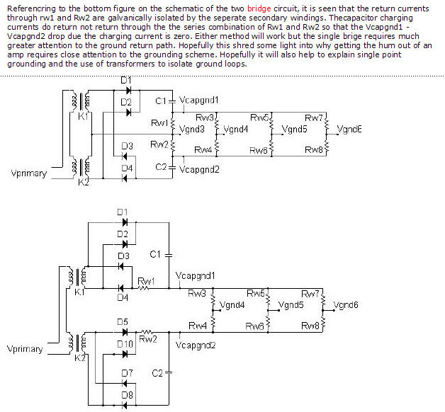

Hello,
In the early eighties a firend built an amplifier which he viewed as state of the art at that time for its schematic. Unfortunately he passed away and recently the amplifier did the same. I ended up opening the box and searching the web to find where / how this amplifier (which I like the sound very much) could be brought back to function. (ok this is almost pathetic..since i know little to nothing about electronic) Searching the web I found the passdiy and this forum sites which are full of all information I needed to get the amp fixed (almost). I'd like to thanks Mr Pass as well as all others who by their questions and answers have teached me a lot and fix the amp.
Beeing far far having a good understanding, one issue remained unsolved yet and even after several searches, I haven't found how to address it. Maybe some of you would have the answer, please be thanked again. Here it is :
There is some hum in the speaker.
I've removed the transformer away to no results.
I've applied Eric (http://www.facstaff.bucknell.edu/esantane/movies/a40.html) recommendations as well as Mr Pass (http://www.diyaudio.com/forums/showthread.php?postid=969953#post969953) although there i haven't found 2200uf tantalum so far (car we use electrolitics instead ?) But to no avail.
Here are the measurements (if that helps)
Right channel
+DC 31.20; -DC 31.20
DC offset 2.8mv
Bias 1.56Amp per trail
Voltage drop
- D1 - D2 1,270V
- R7 0.642V
- R6 0.592V
- Q7 - Q9 emitter 1.089V
- R10 0.636V
- start up thump 0.184V
- light hum yes
Left channel
+DC 31.46; -DC 31.46
DC offset 0.1mv
Bias 1.64Amp
Voltage drop
- D1 - D2 1,286V
- R7 0.656V
- R6 0.589V
- Q7 - Q9 emitter 1.026V
- R10 0.649V
- start up thump 0.343V
- light hum yes
1°) What can be the cause of the hum in the speaker ?
2°) I don't understand why the difference in the start up thump.
The only difference I'm able to noticed with the schema on passdiy is the transformer. It is a secondary 1kVA at 24Volt DC with 8 wires 4 are connected to two rectifier of 50Amp 600V and the 4 other a fixed on the ground. I don't know if that makes a difference. Many thanks anyway.

Hello not sure if you have resolved the hum problem stated in your post. Back a few years ago several people went about building the A40 and had problems with low levels of 60Hz hum. If the amplifier is not gounded per NP's specs it will do just what I think you are describing. I had forgotten about the subtle grounding nuance for this gem until latley when I completed mine. When implemented correctly the input shield is connected to power supply ground, and is 10 ohms above chassis ground. Many neglect the connection between the shield side and the power supply i.e. circuit ground.Hope this helps....
