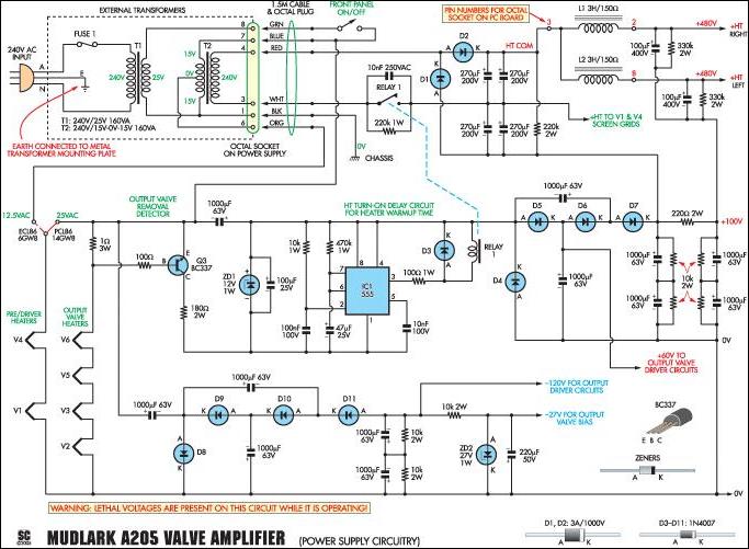

In reading the Mudlark Amp article: http://www.geocities.com/dbr_audio/Parafeed_2x6L6.zip
I came accross a couple of interesting ideas:
1) the use of two toroids to supply B+ & filament voltages
n essence, the two 160VA toroidal transformers, T1 & T2, are connected back-to-back. Transformer T1 runs conventionally, supplying 25VAC to the 30VAC centre-tapped secondary winding of transformer T2. With 25VAC applied in this way and coupling losses due to reverse operation, T2 produces 150VAC at full load on what would normally be its primary winding. This feeds a voltage doubler rectifier circuit consisting of diodes D1 & D2 and four 270mF capacitors.
2) the use of fluorescent light ballast chokes for PS smoothing
The DC from the voltage doubler is further smoothed by the LC filters consisting of 3H (three Henry) chokes and 100mF 400V capacitors. The resulting output is about 400V DC. Incidentally, the 3H choke used here is the same compact ballast choke as used for the valve plate chokes. These chokes are of extremely high quality and low noise. Better still, they are Australian-made and are a bargain when compared to hard-to-get and costly EI lamination chokes.
And Again
Two valves are used in the output stage. They are connected in parallel and have a common 56W cathode resistor, bypassed by a 220μF capacitor. The plate current for the two valves passes through a 9H (nine Henry) choke – essentially three standard compact fluorescent ballasts connected in series – and this provides a high AC impedance but low DC resistance to supply the HT to the plates. The output signal is then coupled to the primary of the output transformer via a 10mF 400V polypropylene capacitor.
As I'm not comfortable with calculations & theory so these are the sort of examples I like - real components in real circuits with schematics
