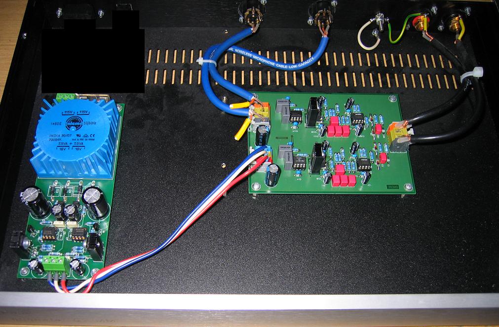

Hello guys and a happy and healthy new year.
Yesterday I found a little time to try a first seating test in the enclosure,
I have taken 2 pics
url]
I beg you all to have a look at my posting #682, where I told of my 3 problems. I have no idea what to do to fix them.
I truly like to run my paradise,
regards,
Christoph
Christoph, if the layout you have shown is a MC preamp, it must have hum and buzz like a hell. MC preamp is one of the most difficult audio components regarding wiring, shielding, grounds, pickup of magnetic field from transformers. I hope someone who designed this project would also give some recommendations and construction hints. My hint is to keep the input of the MC preamp as far as possible from any transformer and avoid any loops (loops of analog ground).
PMA, your advice is good (as usual :D).
Guys please check the assembly guide, it has my arrangement as an example, worked fine for me and is very low noise. I do use an external pre-regulator (as most of the builders are probably looking at doing anyway).
