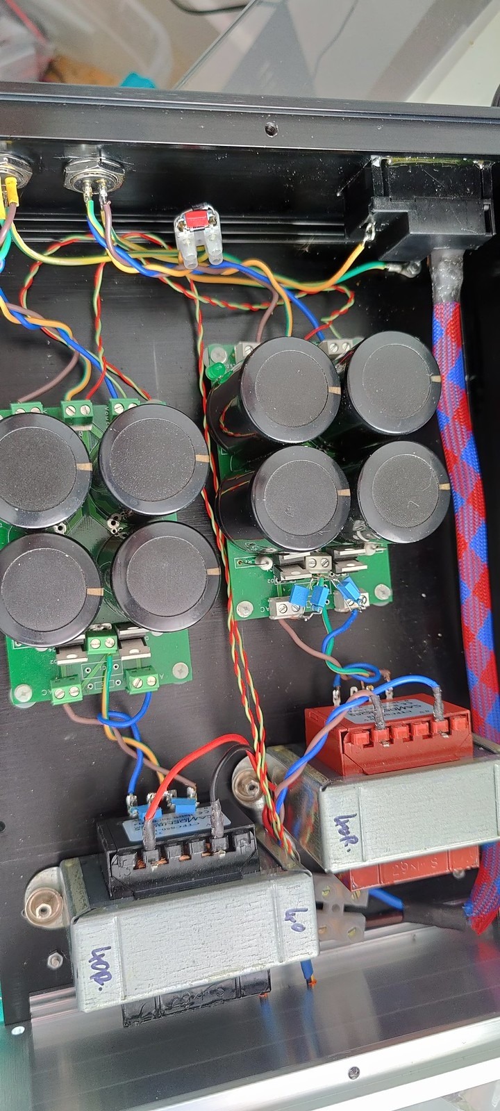

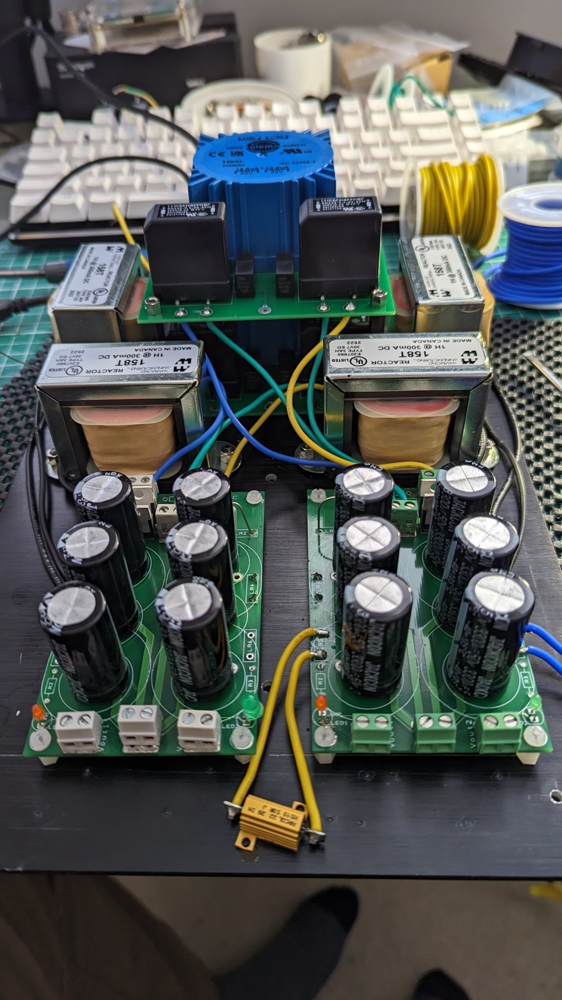

After many years of enjoyment I decided some upgrades were the next uplift. First off I swapped the 10k resistor on the input to a naked foil. I wasn't expecting much, but I was intrigued by how the sq changed to being more, err, open and relaxed, spacious... terrible words, but for me it was a welcome improvement.
Next was the PSU. Previously it was a frame transformer, qspeed diodes and a very simple CRC.
Nothing special.
I invested in a couple of sq's transformer PCB and hunted around for a BOM, mainly for the transformer voltages...
I finished up with this...
Ignore the power resistors, that was my fool's errand.
Anyway, I found that the 2x22Vac transformer doesn't quite get the voltage of the PSU up to 24.5Vdc, and not enough to keep the shunt happy, no LEDs are illuminating.
The plan is to replace the transformers with 2x24Vac ones and possibly fit a resistor to get CLCRC. Shame talema don't do 2x24Vac in that same form factor.
