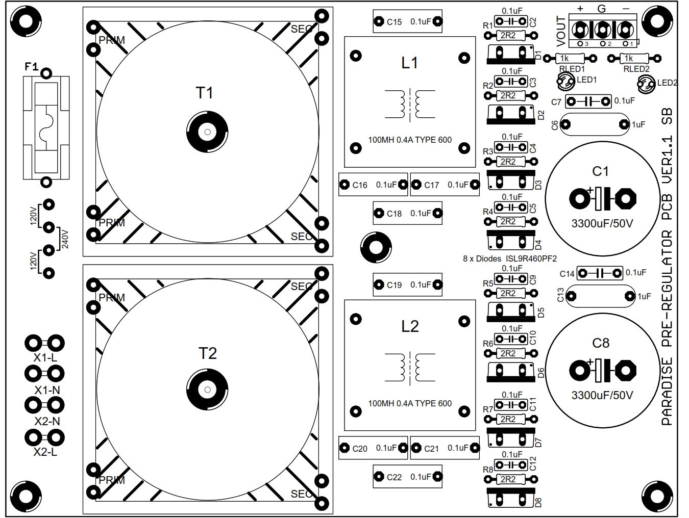

Finally got around to do some testing, and starting with the pre-reg boards i ran into a strange problem.
Ramped it up with a Variac, and one board is fine with +/- 41V and 4mA input current without load
The other board however started with about +/- 39V at 225V input, but then the + side started to slowly go up in voltage, and i gave up when it reached 48V. The no-load current was constant at 2 mA. The increase in voltage was about 10 - 20 mV per second at a constant input of 225V
Checked the soldering, but could not find any obvious fault. If somebody has a suspicion of what might be wrong, kindly let me know.

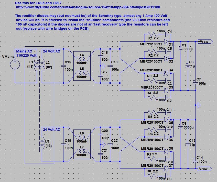

There are two boards, and each has two transformers - in case you are not familiar with the setup:

There must be a reason the + side of one board behaves the way it does. The voltage can not increase like that just because it feels like it . My knowledge is sadly lacking to come up with an explanation, but since there are not many components i thought somebody knowledgeable could pinpoint my mistake easily
Ok, reporting:
found a 300R 3W resistor, connected it to the V+ output.
Input voltage: 165 V (when i went higher, the resistor got too hot)
Input current: 14 mA
Output voltage into 300R: +20 V
Output voltage no load: -29 V
This would confirm that the output voltages without load are not particularly meaningful.
Voltages from the secondaries of the transformers at 165 V input
on the side loaded with 300 R: 17.5 V/17.6 V
side without load: 19.3V/19.4 V
That looked promising, so i did connect one board to one side of the RC-board.
The output from the + and - side was within 0.1 V and stable, and the second board showe3d similar values.
Ordered some 560R 3W resistors and will connect them to the RC-board and hook up both PSU boards. If that looks ok, the next step is to connect the regulator part of the main boards.
Gentlemen, thank you for your help :)
