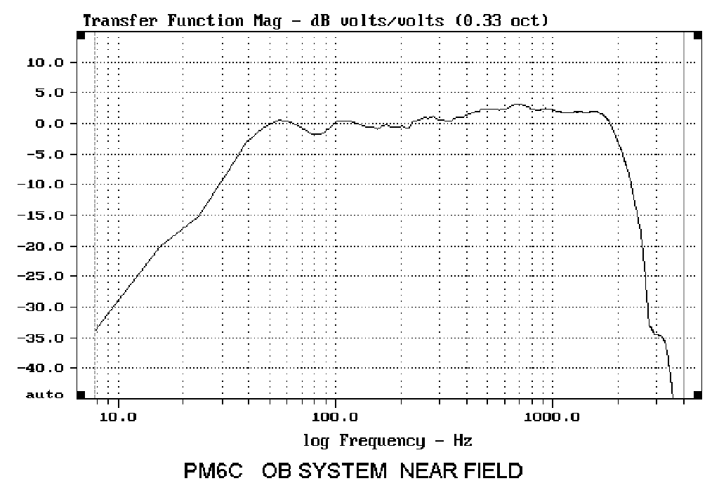

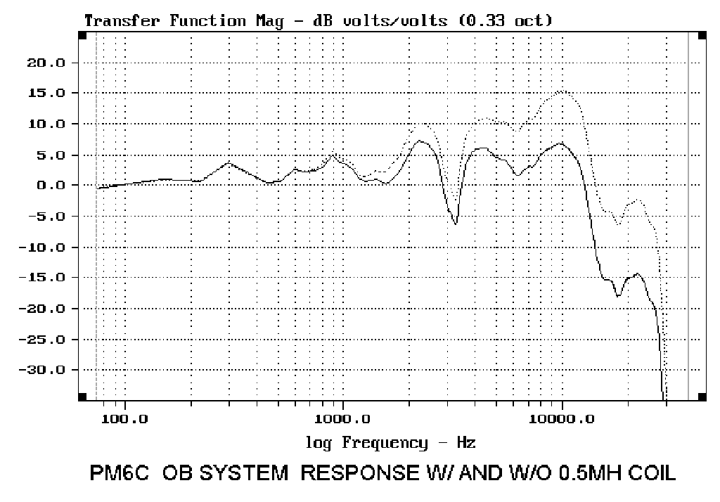

100 uF high pass , 12 mH low pass
Also, I put 0.25 mH in series with the Lowther PM6C
to trim the top.

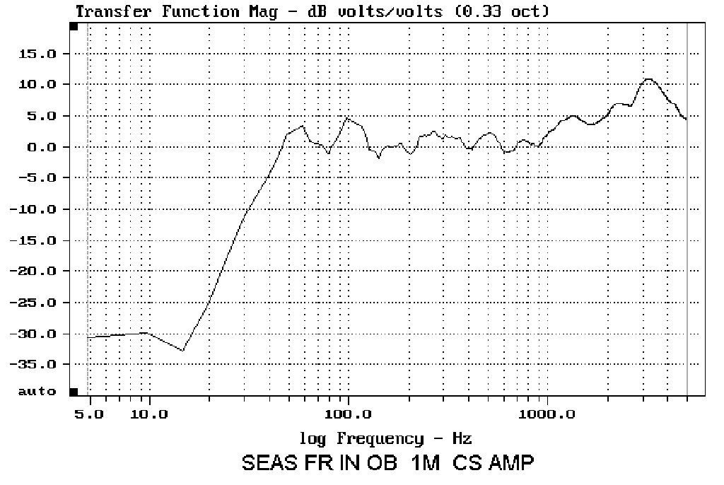

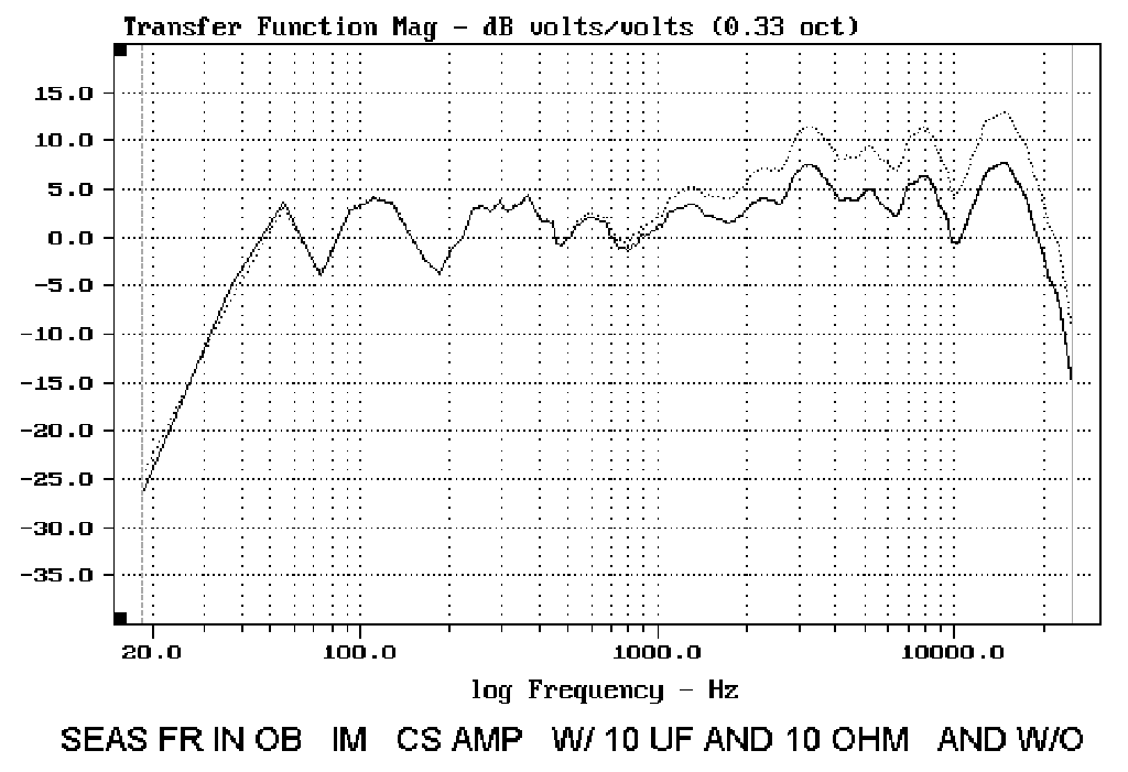

BOB is the Big Open Baffle, what started out to be a nice
little article that has turned into War and Peace.

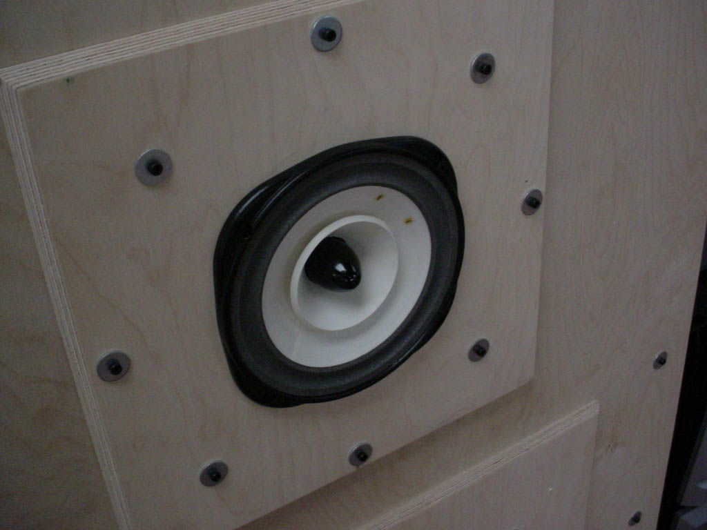

At BAF the SEAS driver had its own baffle 24"w x 72"h
with 15" wings.
Here's some response pics on it. Note that the first three
do not include the high frequency range.
