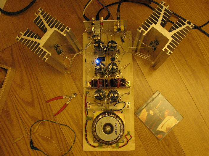

>>V<<
Here is the left channel . . .
Without power switch, plug-in, power-on . . . no pop noise at all.
J-low is dead quiet when no signal.
wOw wOw wOw . . .
Very nice sound.
I am now listening to Al Jarreau . . .
Withour loosing details . . . relaxed . . .
Papa, thanks.
Now, I understand why you said that you could live with this couple of years . . .
wOw wOw wOw . . .
Very nice sound.
Papa, thanks.

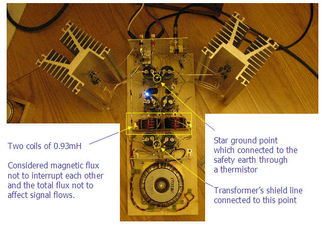

Yeah, looking ugly, but inner spirit is pure and beautiful. Don't you think . . . ? During the construction, I had few concerns. The original used IRFP9240/IRFP240. But, mine had to be with IRFP9240/IRFP250N. As you know, IRFP240 and IRFP250N have different transconductances . . . The original used two coils of 2mH. Comparably, mine had to be 0.92mH because I could get only this size . . . And, possibility of hum and noise . . . ?
I forgot installing power switch and the thermistor at the door of the transformer's primary side . . . As Choky says, often me Babo . . .
I am really impressed about quietness of the amp and the music reproduction quality. No amp is perfect. This amp might be the same. Nevertheless, the music through this amp comes to me very easily. I am living quite stressed life, and the music sound is, I’m sure, well qualified to save me . . .

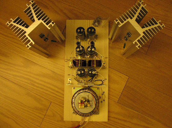

The attached picture shows where I stopped for some thinking during construction . . .
having my home leave holidays, I will study this circuit more . . . to understand the basic things better before I go for another project. Babaefish . . .? . . .? I don’t know yet.

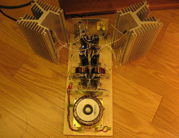

Few observations from my Zen V5:
- [>] Bias is only with 1.4A, but the sound is still good . . .
I do not feel any measurement is intersting at the moment, but when I have time to do it, I will do it to write down the measured references on my notebook . . .
[>] Each heat sink size is 120mmx120mmx250mm. I can touch it long time. The transformer is getting just warm while the caps and coils are staying cold.
[>] Total big caps are of 6x33,000uF = 198,000uF per channel. So, even if I kill the power, I can still hear the sound quite long time. And, the blue LED light remains really long . . . I might need to consider adding bleeders to the caps. Where . . . ? Which position . . .?

Babowana said:
[>] Total big caps are of 6x33,000uF = 198,000uF per channel. So, even if I kill the power, I can still hear the sound quite long time. And, the blue LED light remains really long . . . I might need to consider adding bleeders to the caps. Where . . . ? Which position . . .?[/list]
you don't need them ,I mean -bleeders
Zen Mod said:you don't need them ,I mean -bleeders
Technically, no need.
But, who am I . . . ?
Soon, Babo will forget and be in
and will repeat plug-in and plug-out
expecting the blue LED light diapears . . .
