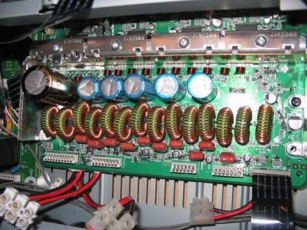

Ok, Here's what I found so far
Let me explain my test setup first because it's relevant to the results:
I wanted to test lots of caps in the the place of the 1,000uf XE Panasonic caps in the output so I decided to remove that cap and replace it with a socket to enable caps to be plugged in & removed easily.
I did this on the center channel first as it was the last one on the pcb board & easiest to get at. When testing caps on this channel I noticed a large difference between them but mainly in terms of the uF value used, with larger values sounding louder! This worried me along with the fact that I could only listen to this centre channel when I switched to multichannel with all the processing that intails.
So I decided to remove the cap from one of the front channels & put in a socket there also. That way I can listen to one channel modded & one channel stock in non-processed mode. The caps all sound similar in this position, including the Blackgates.
If you look at the pcb the PS comes in where the front channels are and the center channel is furthest away from this feed
My conclusion is to bring power to each channel directly by wiring power directly to the 1,000uF cap of each channel!
What do you guys think?

I replaced the XE cap on the left channel of the Front speakers with a socket & left the cap in place on the right channel so i could do a comparison by changing balance left to right! I left all the other XE caps in place on all other channels (except centre channel, which was the first one I modded)
I suppose my point is that the PS is affected as it moves from where it enters the board (at Front Speakers) to channel furthest away prom this entry point (center channel)
I don't know what you mean - here's a pic of the set-up - what you see is a Black Gate 1000uF STD cap in the Left(?) channel of the front speakers -and at the other end a blank socket where I took the XE cap out of the centre channel and put in a socket.
I know the socket will add some extra impedance but?
I also socketed the inductors for the front speaker left channel but the standard inductors are in place at the moment!(using Micrometals T106-2 recommended inductors again made no difference to the sound)
What I'm saying is that this 1000uF BG cap made a huge,noticeable difference in sound in the center channel but none in the front channel so I surmise that the PS supply is degraded as it feeds later channels (impedance?)!
What you see with the red+black wires going under the board is the power connection directly to the cap & the speaker output wires!

I had a hunch that the batterry I had was not good so low output current gave a dissapointing sound.
Got a good battery & wow, sound is stunningly realistic! This is more like the reports I have read about using batteries with this amp. Defintely the reference against which all mains powered (SMPS or linear) supplies will be measured or maybe I'll just stick with batteries.
I think would need 2 batteries in series for 24V to get to really loud levels - with one battery sound level rises up to -44dB on the XR57 vol dial and is flat up to -32db? - the area where vol is is normally controlled by PS voltage adjustment - (I didn't try the higher end of the vol control where the vol is controlled digitally again).
Anyway, this sounds great even though there still appears to be a amount of PS modulation with the music as seen on the scope! I'm wondering how this might beeliminated & how much better the sound might get? (yes I do have a 10,000uF cap in parallel with battery) - maybe paralleling some batteries would give even more current & avoid this modulation?
