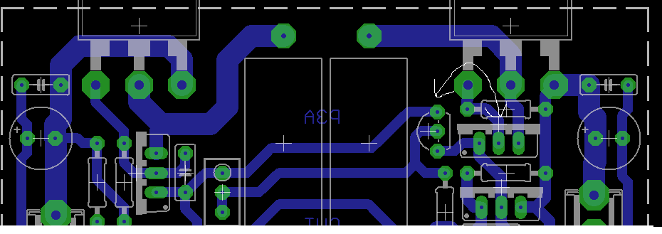

P3A layout
if the publication of these images is harmful to Elliott I'm in the best disposition of them to be erased by any moderator.
the attached picture is just the part of the pcb that shows q9 next to q5.

P.S. Back to the topic, the extra capacitance (~100uf) at the rails was necessary on my (own design) boards to prevent oscillation on the negative rail. I left myself the provision to mount a separate heatsink across the drivers and q9, but have not found it necessary to exercise that option even after long periods of high output testing.

CBS240:Just a few points.... I would at least fill the empty space with copper. I would also take the negative feedback from a point in the center of where the two output resistors connect, that being node labeled "OUT", where the Zobel now resides. Having the DC blocking cap grounded to the same trace as the decoupling cap might create issues as well.(Buzzzzzzz) It needs it's own ground trace, a clean ground trace, without the current pulses from the decoupling cap corrupting it, such as the signal GND. Does Q9 need to be mounted to sense the temperature of the drivers, Q's 5 & 6? (reffering to the scematic here ) Typically with a feedback pair OS the drivers have to be thermally compensated, but maybe not here....I haven't built this one.
I leave the Zoble off the board ,put it on a little solder terminal board( "daughtercard") or right at the output terminals.
Also, A 10 ohm resistor between the remaining "dirty ground"
and input /DC blockingcap ground.

Agreed.:) That seperation in PS gnd and signal gnd is important, and that both inputs of the differential are referenced to the same gnd so your not amplifying the difference between them.:eek:
treat the signal ground as an input that is just as sensitive as the "conventional input". Take the signal ground and it's three connections: NFB return, Zin return, RF filter return, back to the input socket and then connect the input socket to the Audio Ground.
I'm wondering why does the designer (R. E.) recommends 75mA bias current in the OP stage (2*25mV on the 0.33r resistors).
For an EF OP stage 25mV drop on the Re is the ideal value, but for a CFP OP stage far less is enough. Say 2.5mV.
Then bias current would be 7.5mA (2.7mA for driver, 4.8mA for output).
Anyone please who has built the P3A project would make some measurements & a listening test with ~7.5mA bias?
