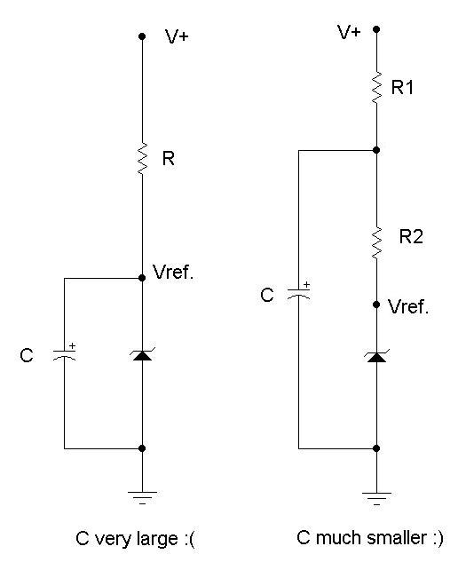

Size matters
I guess I don't quite get this obsession for small capacitor values. A 1000uF is a reasonably sized cap for an electrolytic. Placing the cap across the zener shunts the zener noise at frequencies where the capacitor impedance becomes less than the zener impedance of and lowers the impedance seen at the voltage reference point. The power supply terminal for several op amps is across this zener in the original context of this discussion. A low AC impedance for the op amp supply is very beneficial. Your circuit on the right for the smaller cap value has neither of these features and I can't see the point of the topology. This is pretty simple circuit that is commonly used.

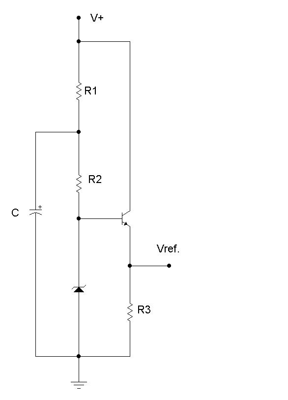

Once again
Thie circuit below is flawed for the same reasons as the previous one.A better way to do it is by biasing the zener from the V+ supply with resistor and filtering the zener noise (and the attenuated V+ noise across the zener) with an RC circuit after the zener is the usual approach. The base of the transistor would be connected to the junction of the capacitor and the resistor to the zener. This will filter the noise and reduce the effective impedance of the node by Hfe of the transistor. (until the impedance at the junction the resistor from the zener and the capacitor to ground drops below a few 10s of ohms) At high frequencies the capacitor actually has much less impedance than the emitter of the transistor. Another capacitor to ground at the emitter is often used for this reason. This are extremely common circuits and I have seen this capacitor bypassed emitter follower supply in many audio supplies. These are even commonly used as regulators for vacuum tube circuits.

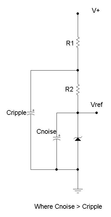

Fred Dieckmann said:I guess I don't quite get this obsession for small capacitor values. A 1000uF is a reasonably sized cap for an electrolytic. Placing the cap across the zener shunts the zener noise at frequencies where the capacitor impedance becomes less than the zener impedance of and lowers the impedance seen at the voltage reference point. The power supply terminal for several op amps is across this zener in the original context of this discussion. A low AC impedance for the op amp supply is very beneficial. Your circuit on the right for the smaller cap value has neither of these features and I can't see the point of the topology. This is pretty simple circuit that is commonly used.
Ahhh.....i take it you now accept that placing a capacitor across a power supply zener reference with a view to lowering its output resistance, or reducing power supply rail ripple simply won't work, and is very inefficient of cap. size respectively......
...On the the subject of zener noise, .....yes....a great many published circuits, including current-source references, place a cap. across the zener with a view to filtering noise....
This is indeed a good idea, as one can expect sufficient attenuation in the audio mid-band, where the ear is most sensitive to such.......one solution is given in attached figure...
For a typical zener impedance of 20 ohms at room temp, and 10mA, 470u should work well....

Fred Dieckmann said:Thie circuit below is flawed for the same reasons as the previous one.A better way to do it is by biasing the zener from the V+ supply with resistor and filtering the zener noise (and the attenuated V+ noise across the zener) with an RC circuit after the zener is the usual approach. The base of the transistor would be connected to the junction of the capacitor and the resistor to the zener. This will filter the noise and reduce the effective impedance of the node by Hfe of the transistor. (until the impedance at the junction the resistor from the zener and the capacitor to ground drops below a few 10s of ohms) At high frequencies the capacitor actually has much less impedance than the emitter of the transistor. Another capacitor to ground at the emitter is often used for this reason. This are extremely common circuits and I have seen this capacitor bypassed emitter follower supply in many audio supplies. These are even commonly used as regulators for vacuum tube circuits.
do you mind posting the circuit?
It has to be said that the emitter follower would have to run at fairly high quiescent current in order to effect a significant reduction in the zeners impedance.....
The zener diode is particularly noisy at higher voltages. The quietest zener is 5.6 volts; at this voltage noise is very low indeed. Perhaps a better option is to make a variable zener, using an NPN transistor with a 5.6V zener in its emitter, and a resistive divider between collector, base and the bottom of the zener.
By fixing the lower resistor in this string (R1), base to anode of zener, and setting a value of the base to collector resistor (R2) far above this a la Vbe multiplier, you can fashion a very effective and quiet Zener.
The total voltage from anode (bottom) of zener and collector (top) of this configuration is given by Vt = (6.2(1 + R2/R1). For R1 of 1K, and R3 of 3K3, the total voltage of this composite zener is 26.66 volts. The only caveats are that the current through the voltage divider should be at least 15 times the base current of the transistor and at least five times lower than the collector current; and that the zener should be run at no more than 30% its commercial continuous rating. This ensures good temperature compensation, low noise, and tolerance of varying betas.

No, I don't, quite the contrary. The whole point of this discussion was that the simple shunt zener regulator in the amp under discussion, would benefit from a larger capacitor across it to lower the noise, lower the supply impedance seen by the op amps, and could be done with a reasonable sized cap with a corner frequency below 20Hz. I didn't think it would be a controversial topic. As for follower topologies, RC fitering of the zener noise before the base connection of the follower is the most sensible topology for reduction of zener noise and increasing the PSRR. I see that 470 uF is an "efficient cap size" but I take it that 1000uF isn't. Perhaps you could weigh in on 680uF...........

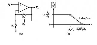

AKSA said:
Phase compensation, a small cap used between the voltage amplifier output and the feedback node, is a very useful method of improving tolerance to highly capacitive loads, and my amplifier designs use both lag and phase compensation. This method is highly favoured by Linsley Hood, a worthy guru. I find this approach difficult to get right, but very effective for stability, and much simpler than two pole lag compensation.
Hugh
The Linsley-Hood scheme is merely the conversion of the gain stage into a low pass shelving amplifier, with the output stage excluded....see...figure 1.32 in....:
http://users.ece.gatech.edu/~mleach/ece4435/chap01.pdf
Excluding the output stage thus...is sub-optimal, as this occurs at frequencies where output stage distortion is at its worst....
