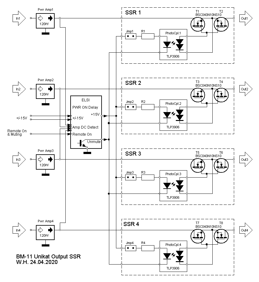

Maybe some additional help can be provided to my SSR Quad Output Relay project...
My project is small, i.e. because I only want to equip two 4-Way Speakers doing a lay-out with SMD seems like an overkill :rolleyes:. Here's the schematic:
attachment.php
As you can see, sensing DC is directly done on the Amp Board and the "Unmute" output signals are generated by the protection board (ELSI - works already) to one SSR board per Amp.
My questions:
Does my Open Collector Transistor (which switched the output relay so far) circuit work or did I miss anything?
How can I solder/connect the TLP3906 and the BSC040N10NS10 without having an SMD board?
I'd be grateful for recommendations!

So, in essence, the complete RTR SSR is a great device, but has redundant functionality for my case. Adaptation of the existing protection circuitry to the optocoupler and MOSFETs as SSR looks relatively straight forward.
Am glad that you have defined your requirement so clearly. I've been there too, though I've never designed anything around it. I don't know any better introduction to the issue than this page by Andrew Russell: Solid State Relay with PCB Layout The author is "bonsai" on these forums.

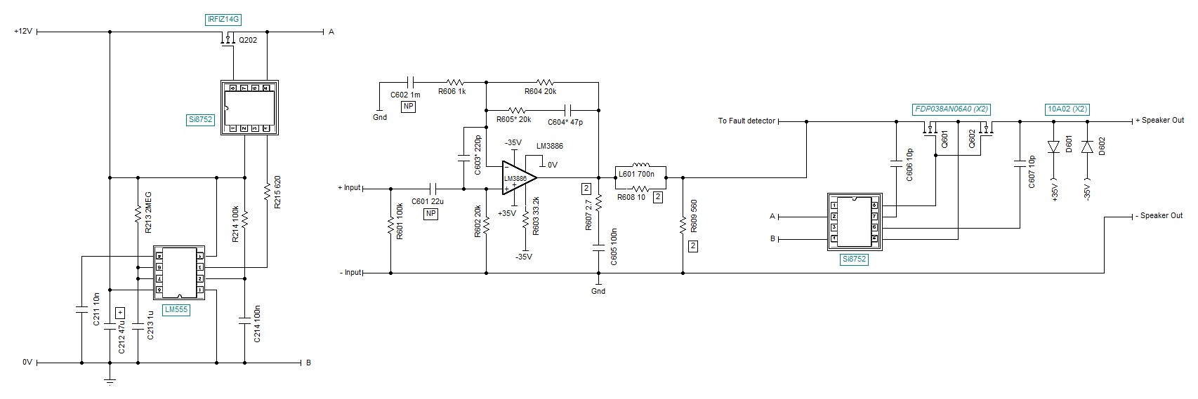

You guys really should take a look at my posted circuit. I'm using the Si8752 FET driver, it's NOT PhotoVoltaic based, it uses an internal RF generator/reciever that is capacitively coupled. (Data sheet) https://www.silabs.com/documents/public/data-sheets/Si8751-2.pdf [/URL] It provides greater drive current for quicker switching speeds than any PhotoVoltaic type, and it's rated for use with high current applications such as mains switching. There's also the Si8751 version which is digitally controlled.
Rod Elliott posted an article on his site about it here: Project 198

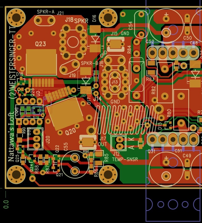

We want the MOSFETs in a SSR to be low on Rds-on and high on BVds and (BVds/Rdson)^2 = $$$ + L*W*H, roughly speaking. So we often end up with marginal BVds de-rating, thus making it necessary to take measures to protect the MOSFETs.
Under extreme conditions when the SSR switches off an inductive load, as is the case a speaker, the back EMF kick can subject the MOSFETs to high Vds, possibly endanger them. A pair of clamping diodes at the output of the SSR, as shown in Michael Bean's post #664, would dump extra energy from the the kick to power supply rails, and the MOSFETs would not see a voltage greater than what's between the rails.
The attached layout is my implementation of a SSR speaker relay with a 200W amp project, Meistersinger, finished a few years ago, the D16 and D17 are the clamping diodes. I used 150V Vds rating MOSFETs against the +/-65V supply rails.
For add-on SSR projects, on the other hand, it's probably not favored to have to wire the supply rails to the SSR board for just clamping. A bi-directional TVS device could then be used across the SSR to make sure the MOSFETs don't see a voltage greater than the TVS's V_ break-down. Member XRK971's SSR group-buy project displays such practice. The TVS, at break down, would dump the extra back EMF kick energy to the output stage of the amp and then to the supply rails eventually.
Just a thought.
