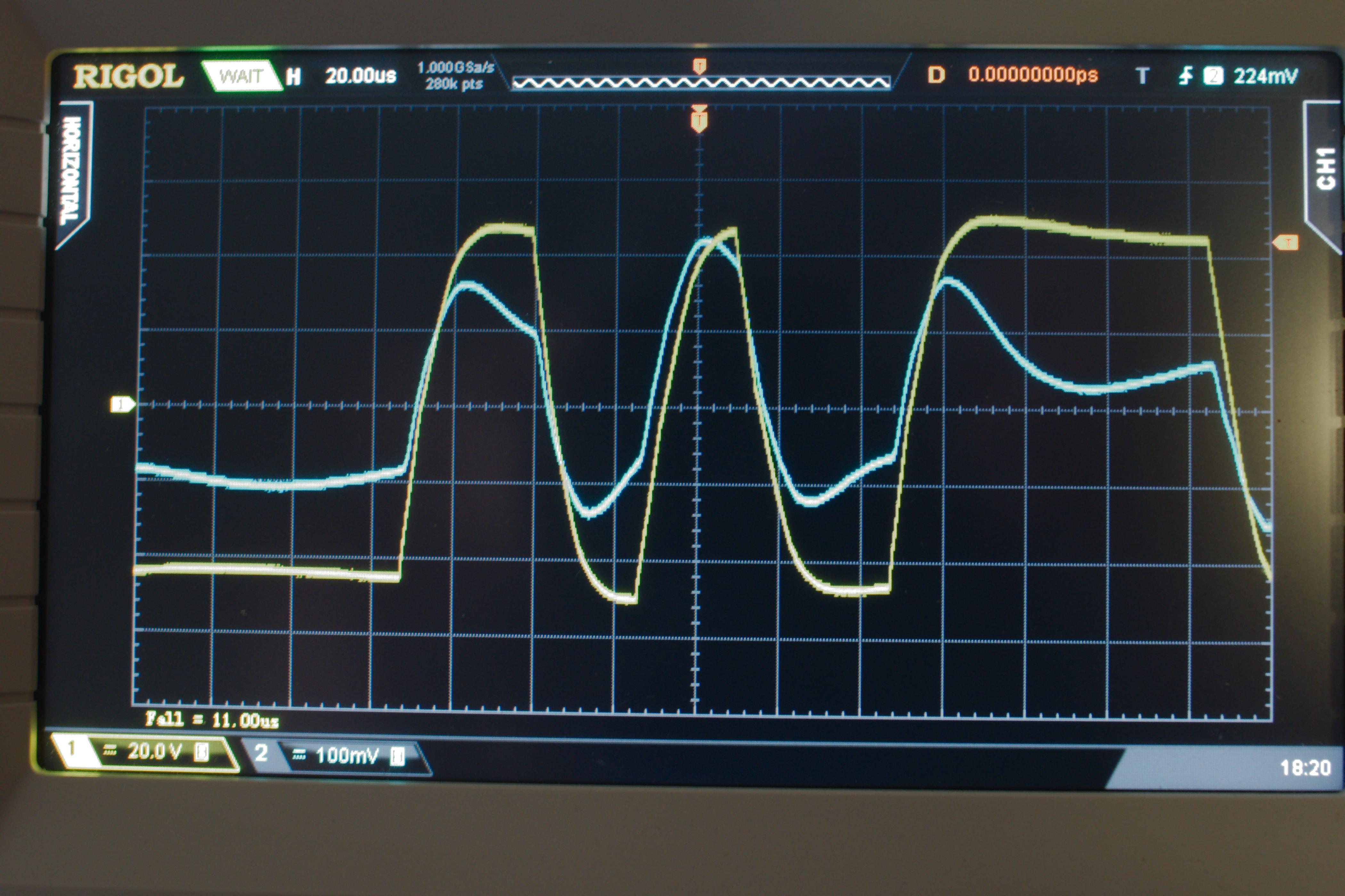

This is a 100W (+-50Vcd PSU) amplifier in normal operation. The blue trace is from the current probe and measures 10A/div (the maximum current shown is about 22A). Braking even normal operation, with an relay, is difficult under stress it will be even more difficult.

What is the load during this measurement?This is a 100W (+-50Vcd PSU) amplifier in normal operation. The blue trace is from the current probe and measures 10A/div (the maximum current shown is about 22A). Braking even normal operation, with an relay, is difficult under stress it will be even more difficult.
100W into 8r0, or 8ohms(with some L&C), or 4r0, or 4ohms(with some L&C)?
The load is a 8-ohm (nominal) loudspeaker system. Carver Amazing Platinum Edition. This is an magneto stat (2 pcs 70cm(28") line sources) with 4 cone (25cm(10") diameter) woofers in a panel.
You tested via a real speaker.
Pass the instantaneous peak current info on to the Cordell book Thread.
Some in there will not believe that peak current can ever exceed Vpk / (lowest real resistance of the speaker)
i.e. they insist that if a real 8ohms speaker has a resistance of 6r, then the peak current can never be more than Vpk/6

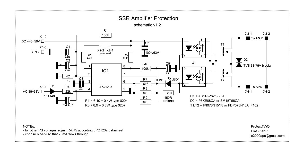

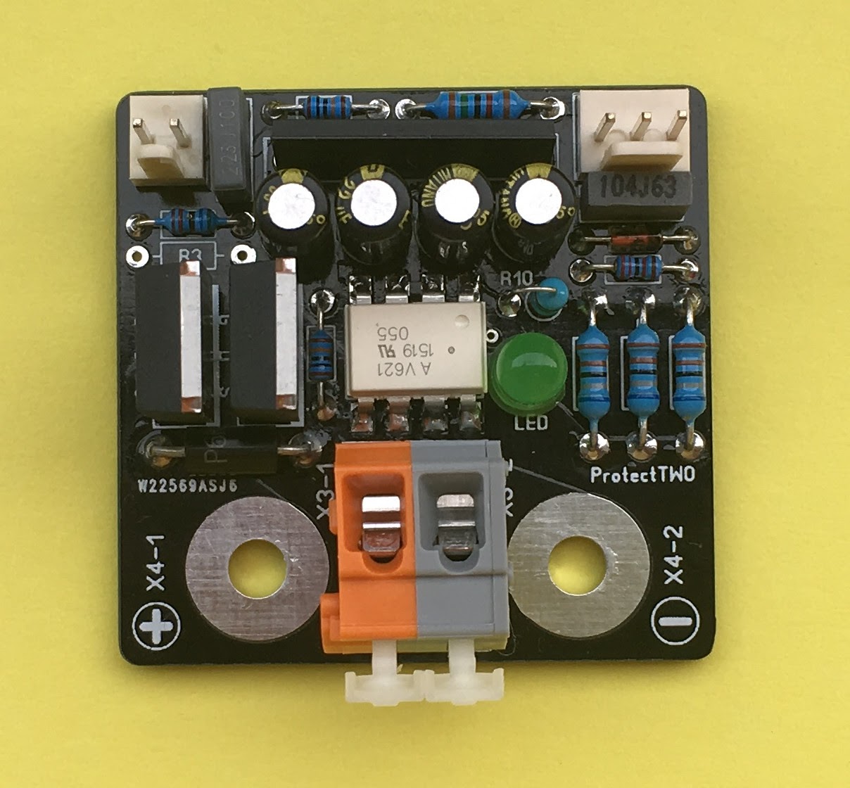

Hello, this is my first try to build a protection circuit by using solid state relay. I'm satisfied almost with all parameters but ON switch time is too slow due to LED circuit. If one does not plan to switch ON under heavy load everthing is superb. Question is, how to SPEED UP the circuit
- usable for 100-200W@4R amplifiers (one module per channel)
- resistance slightly less then 20 mOhm
- SSR ON time aprox 15 ms
- SSR OFF time aprox 5 us
- delay between overload detection and SSR OFF aprox 380us
See measurements

A quick thought on the photovoltaic couplers... have you considered running them in series (the outputs) to double the drive voltage available. I haven't looked at the FET specs, but may are rated up to 20Vgs or higher and so can benefit from being run in that region (lower Rds at higher Vgs).
Nice work though
Nice work though
