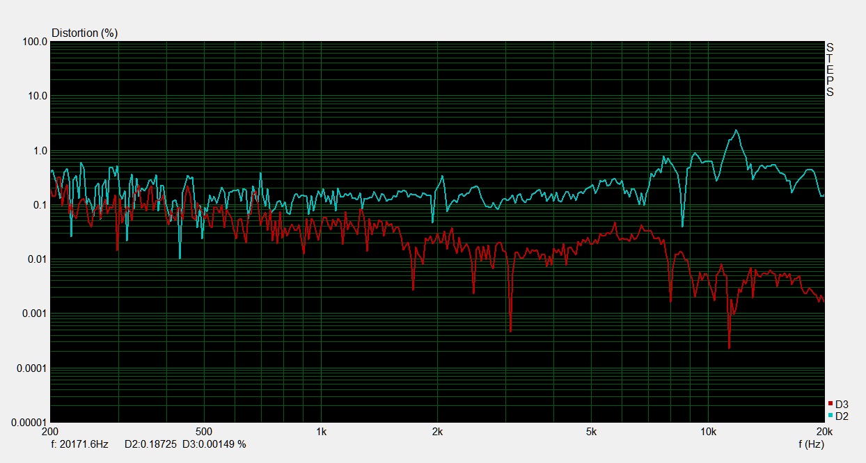

It's there clear as day in the stereophile measurement of the new 800 model. I posted that image in my earlier reply to this thread.
Zaph has measured the FST and measured the same resonance, along with a corresponding peak in the distortion profile.
Or maybe you'd prefer my measurements. The FST here is the red trace.
attachment.php
And the distortion sweep.
attachment.php
It is this peak that gives rise to the peak in the 800, linked again for viewing ease.
There's no two ways about this, the peak is caused by the cone of the FST going through a mild resonance that causes a peak of 4dB at around 3.5kHz. This is the region our ear is the most sensitive to and I was surprised to see that B&W hadn't filtered it out. Then again, B&W are known for using the 6.5" FST kevlar driver up high with a gentle crossover. This creates issues, but issues that also sound a specific way and will create the B&W sound. This isn't neutral, as the ragged response centred around 10k isn't neutral either, this once again being caused by the gentle filter used up very high on the FST.
Now the FST has a very well designed motor such that the distortion peak associated with this resonance is rendered a non issue - that is the peak in distortion is unlikely to be audible, but the peak in the frequency response sure will! Just listen to music on your PC and whack in a 4-5dB peak at 3.5kHz, it's very audible.

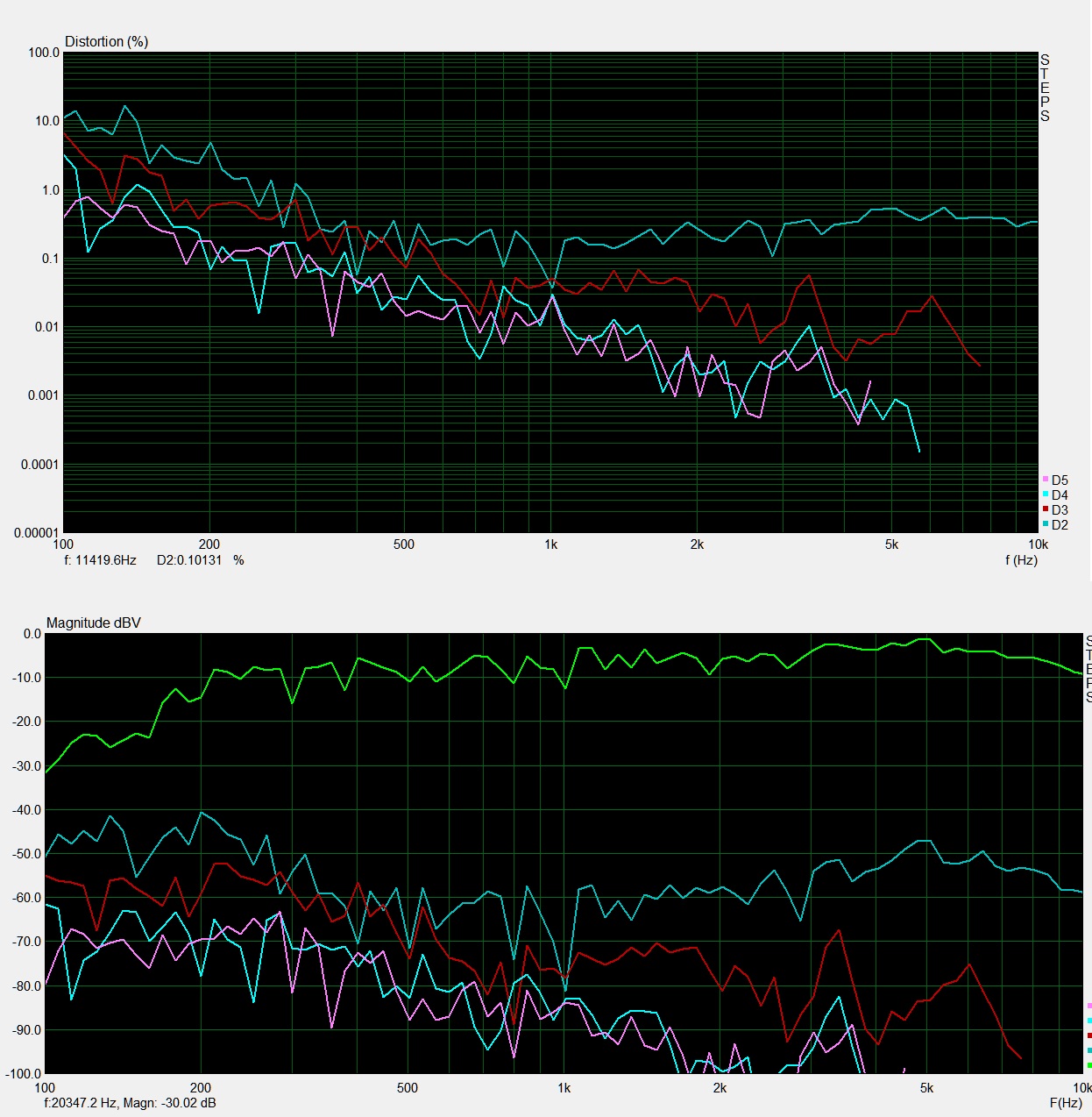

Yes I do know all of that already :) The FST design uses a 6" wave-guide along with the HDS tweeter made by scan speak, this allows me to crossover at 2.5kHz with a 2nd order acoustic whilst maintaining a very smooth set of off axis curves. The DSP time aligns the whole thing and as it's active each amplifier sees a rather benign load. Not to mention the mid-band sensitivity is pretty high, the FST being 95dB+, with the HDS tweeter hitting around 96dB too at the point where the wave-guide is doing the most. It goes loud very easily.
Below is an image where I ran some distortion tests to see how hard the FST could really be pushed down low. I wont include the 2nd order tests as the driver cannot manage with a second order high-pass unless crossed very high. Here we've got a 4th order acoustic target first at 400Hz and then at 300Hz. The top graph is basically at around 95dB, the next one down at 100dB and the one below it at 105dB. You can see that the driver is having to work ever so slightly harder with the 300Hz crossover, which is as low as I'd want to take it really. Wanting to maximise what I could get out of the FST, in taking it as low as possible and then has high as would be reasonably possible to avoid the peak at 3.5kHz. The combination works very well together with a ruler flat frequency response, smooth set of off axis curves and very low distortion that is also free from any peaks.
I think B&W use the FST down to around 300Hz too, which is a good idea as it's a fantastic driver, you'd certainly want to take advantage of everything it could offer, but a shallow crossover at 4kHz isn't really the best idea in my opinion. Of course B&W could have kept the xover at 4kHz and just added a load of shunt components to flatten out that peak at 3.5kHz and then smoothed the upper roll off a little more too - then we'd have a smooth on axis response, still with only one reactive series pass element. It seems odd to me that B&W would go to such lengths to reduce cabinet diffraction and then leave a hump in the response like that.

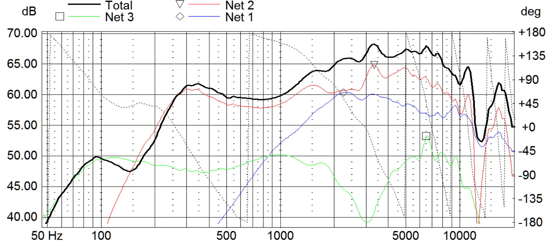

your are using 10 db deviation scale , pretty bumpy ride for 10 db scale. What software are you using to generate the distortion numbers..
I'm interested in seeing impulse and step response , xover points and type is very important in sizing, realism of image size is very important in sounding real ...

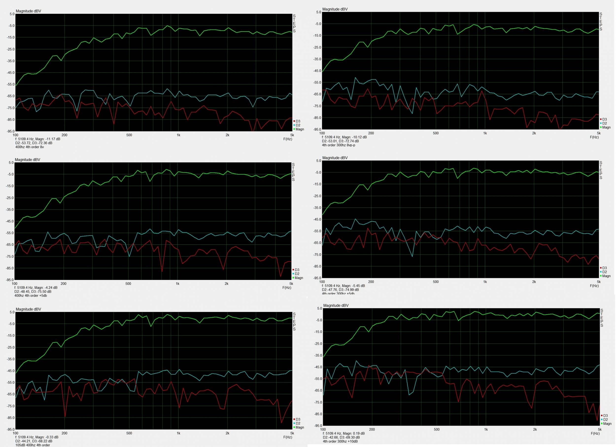

The ride is always bumpy when looking at STEPS' stepped sine distortion sweeps, the reason for this is that the mic is a reasonable distance away from the loudspeakers, without any gate, so room reflections come in. This doesn't really affect the distortion much as per say, but does affect the flatness of the frequency response. Also STEPS (part of ARTA) does the tests at stepped frequencies, ie, it's not continuous, so you pick how many different frequencies per octave it tests at. The more you pick, the longer it takes, those were done at 12/octave.
You call that bumpy, 10dB/div is normal for distortion sweeps, but even with the less then stellar way of measuring the frequency response it's still within +-2dB for the most part. With a proper gated measurement the loudspeakers are more like +-0.5dB apart from a little squiggle at high frequencies due to the wave-guide.
Here's a stepped sine sweep at 48 steps/octave, this is done at what I consider the loudest I tend to listen at. The 4th, 5th and 6th+ harmonics are not shown as they are much lower in level. The sweep stops at 200Hz because below that the accuracy dies tremendously due to the room reflections.

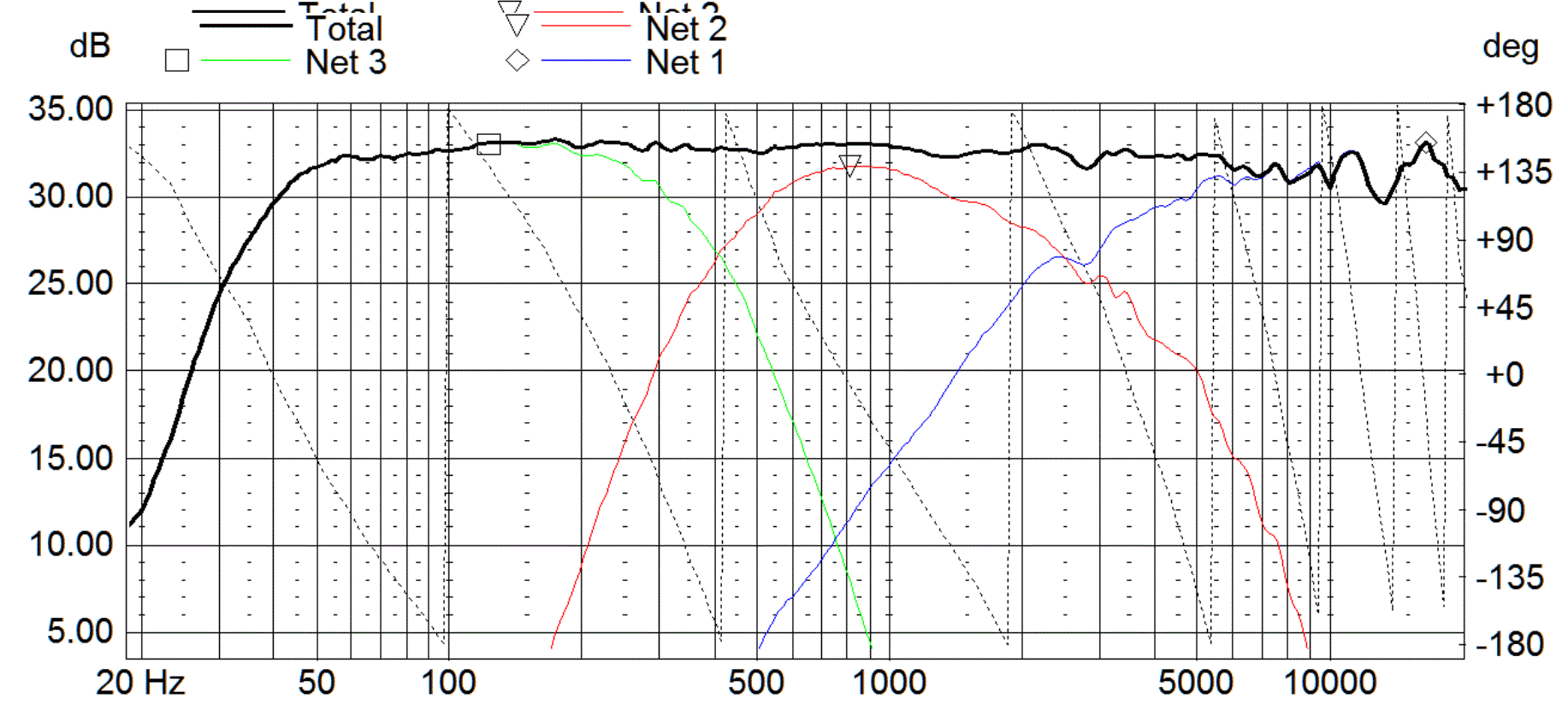

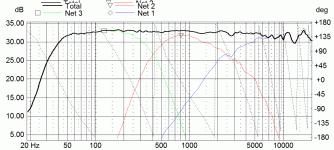

I have already said, that I use 2nd order slopes on the mid/tweeter and 4th order slopes on the bass/mid. These are both of the linkwitz variety and as mentioned before, have been time aligned with the DSP so that both exhibit strong nulls with the polarity reversed at the listening position. Nevertheless here's the simulated frequency response in LspCAD.
attachment.php
And I can assure you that the real life measurements match up very closely, the fine tuning on the time alignment was done in real life mind you by altering the delay until the largest nulls were reached at the listening position.
The impulse and step responses are fairly useless pieces of information imo, but needless to say both hand over smoothly from driver to driver, with a little bit of ringing evident in the impulse response from to the kink in the top octave due to the wave-guide.
