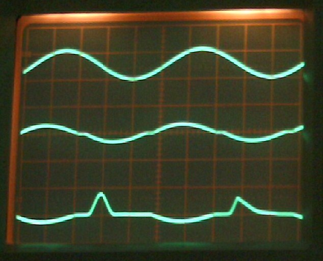

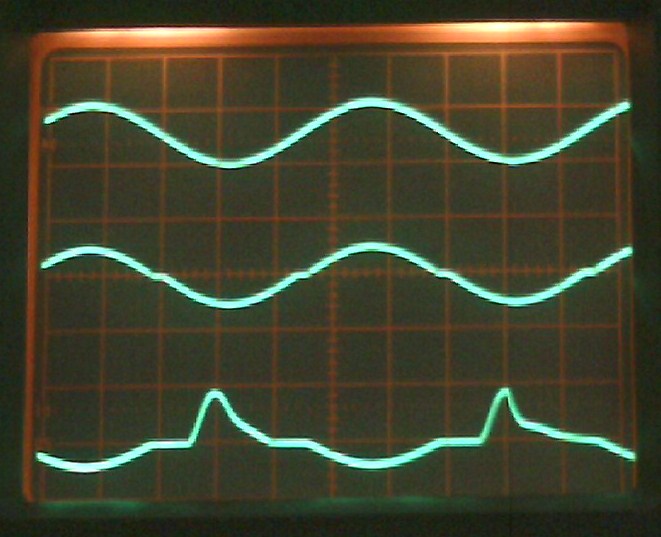

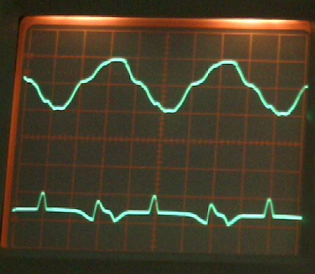

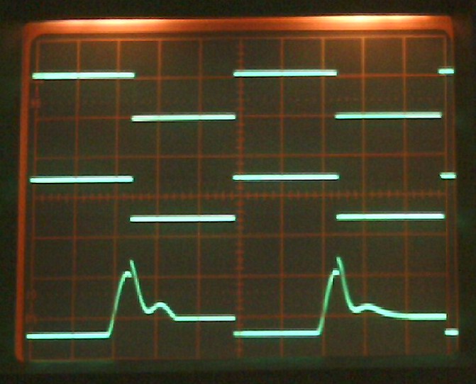

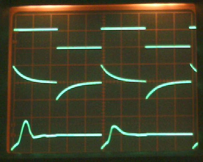

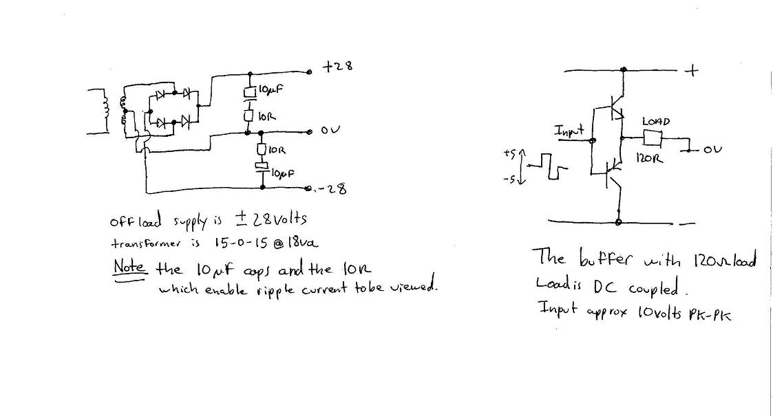

Some real world pictures to illustrate.
Note the PSU and just 10uf caps to give masses of ripple. Note the 10 ohm in series with each (think of the e.s.r. with those) added to enable the current to be seen.
The "amplifier" is as bad as it gets... an unbiased buffer.
I used 100 hz as a test frequency to enable pictures to be photographed from the scope.
Image 1 shows the input to the buffer as the top trace at 10 volts pk/pk, the output across the load as the middle and the correspnding ripple component in the lower. The ripple is approx 1.5v pk/pk measured across the upper 10 ohm.
The output is perfect, even with only 10uf in the PSU and masses of ripple. In fact the ripple is larger than the signal... but the output is unaffected.
Due to the way the scope triggers the phase relationship between the ripple and the signal is not accurate... more on that later.
Image 2 shows the above but with a 10uf cap "in series" with the load... as we expect it's effect is dramatic as it forms a low pass filter.
The output current really does pass through this.
Image 3 shows a sinwave input... DC coupled, so no loss of LF.
Image 4 again a sinewave, now AC coupled via 10uf, loss of LF.
Image 5 is with the buffer fed from the 50 hz secondary voltage (via a divider of course) to show the true relationship between the ripple component and the signal. The waveform is distorted because that's exactly what it does look like on the secondary when the transformer is supplying the current to the circuit.
So I hope that explains what I am trying to put across.
