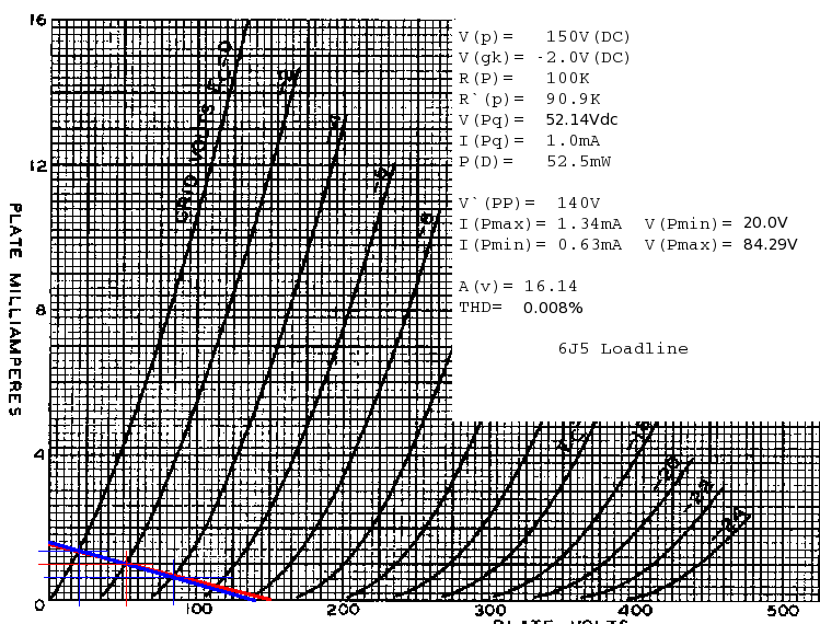

Here is a version...I like the possibilities current mirrors give, and to me the pros outweigh the cons. (No capacitor, wideband response, gain and bias (of the output tubes) in one, load resistors placed at any voltage level, etc)
For simplicity only a single 6AS7 is shown, and for simulations the load is 32ohms. 4 tubes in parallel is fine for 8ohms.
Many think the cathode resistance in the output is too high, but I've tested and believe it both sounds better, and provides better harmony between the parallel tubes.
The mirrors can be modded in all kinds of ways, cascoded, wilson style, base drive with another pnp's emitter to the mirror bases, etc etc.
The load/gain resistors can be varied without any change in distortion, just gain. U can experiment with various values for max symmetry, but I cannot hear distortion if it is slightly off, since it's all benighn second order.
The bias is adjusted with a potentiometer in series with the LTP tail resistor.
Btw, do u know why a CCS in the tail of the PI is actually worse in this circuit?
Cathode followers driving the output helps increase power, obviously, but I prefer the sound of the lesser powered CF-less version.
I don't use NFB, R13 is not there, but if u like, R13 can be up to 2kohms...actually, u decide, it can be any value...

Simply plugging in the 6SL7, no operating points or other elements changed, reduces stage gain to 47.17/23.6, with a -3dB high cut of ~87kHz and an output impedance of 60.3k. You could just rig up an octal socket and try it out. Stuart

I've grown less fond of the cascode because of its non-existent PSRR, lack of AC balance adjustment and very high output impedance. The cascaded input, DC coupled, of Covi's design appeals to me on those grounds. I would certainly use the aforementioned CCS in lieu of the LM317, and perhaps select a different tube lineup.
Stuart
If you have a differential cascode, you eliminate the PSRR issue. The output impedance does not have to be high- some things about the cascode are counterintuitive, and evaded even its designer! For example, depending on what tube is on the bottom, often you can increase Gain, linearity and bandwidth all at the same time by **increasing** the current (lower Rp value)! I've certainly seen this, so don't assume that a cascode has to have a high output impedance- you could be very wrong.
If you have a good CCS, the AC balance issue is of no consequence. A bad CCS and all your performance goes out the window...
To precondition any tube, the plate, grid and cathode are tied to the filaments and the tube lit up (no B+ obviously) for whatever time it seems to need. 72 hours seems to do it for the 6C33.
I thought the 6SN7 operated as you have it, was running a little low in current, but a nicer sounding tube probably can't be found.
It just isn't true that you have to run the 6SN7 at a high plate current in order for it to sound good. Take a look at this loadline for the 6J5 (a singleton that's basically half a 6SN7). For this design, the 6J5 is running with an IPq= 1.0mA. The THD estimate is quite low, and this definitely sounds quite good.
The 6SN7 used as a CCS in the tail, I considered doing with a cascoded pair of DN2540s.
I've used cascoded BJTs to make the active tail loads. Works great, and the AC balance per phase is excellent.

When used as an LTP splitter/amp, these are not problems. With an active tail load, the cascode LTP doesn't require any external AC balance adjust. As for the high output impedance, that's no worse than what you get with small signal pentodes, and becomes a non-issue when used in conjunction with cathode/source follower grid drivers.
That was the major problem: very few examples of cascoded LTP hollow state amps, though this is used quite frequently with solid state designs. So I went ahead and gave it a try, using 6BQ7s to make a single stage splitter/front end amp. It worked just great, with excellent sonics.
