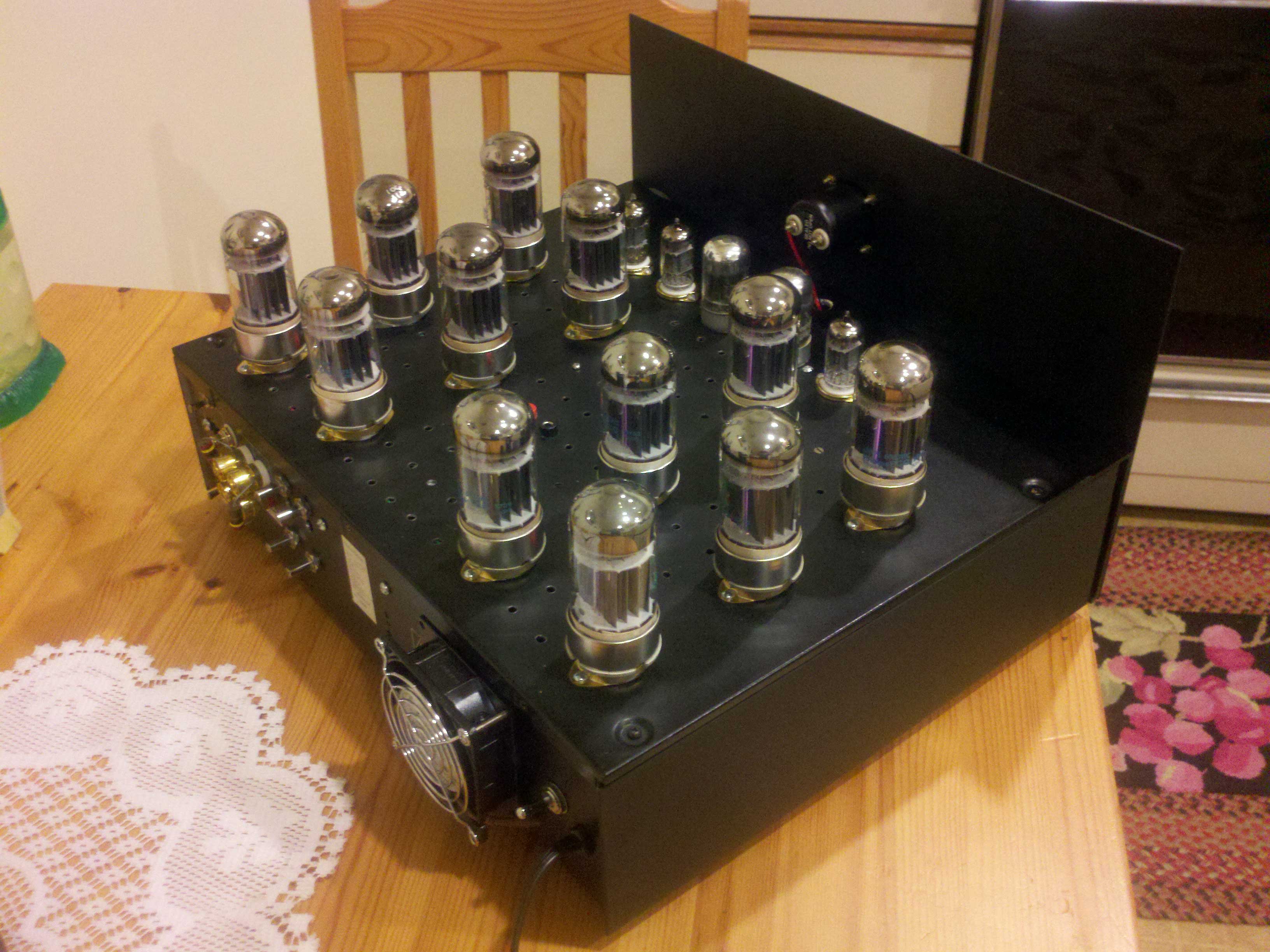

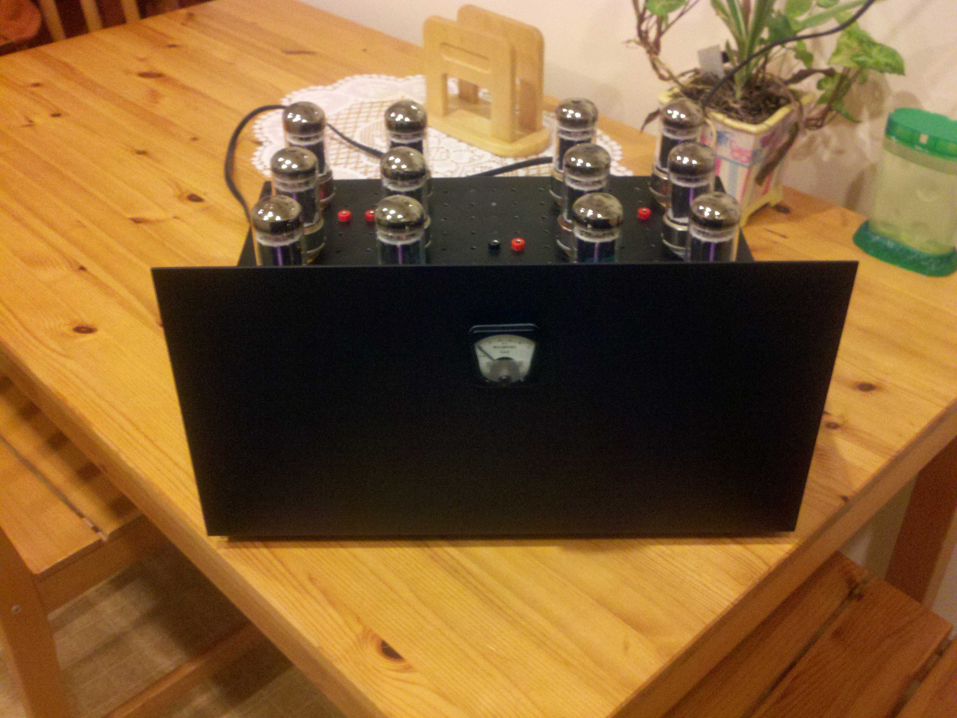

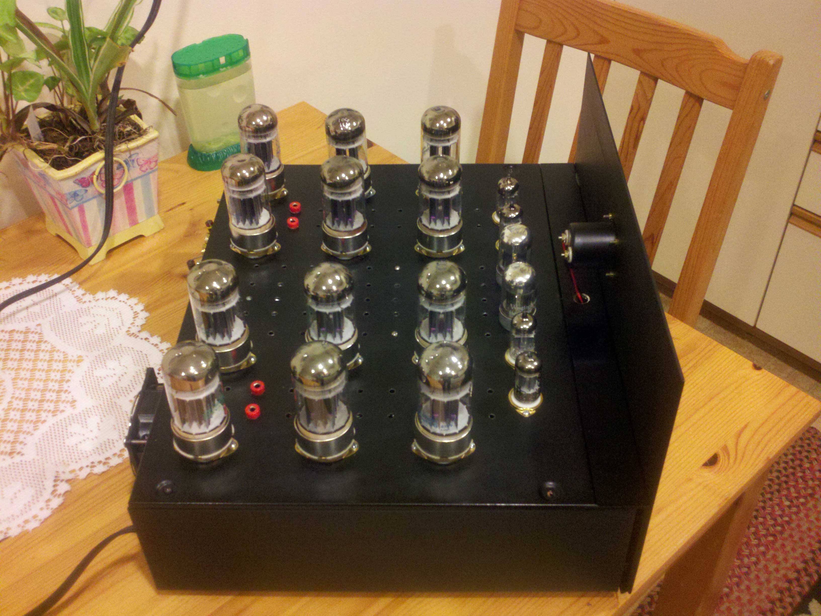

It took a little over 2 years but here it is. Just finished it... sorry but life got in the way.
Enjoy.

Yes this is the Glen Orr OTL from Audioxpress which was based on the 1950's otl. Glen's design changed the original a good amount though. Had some inside pics but they got lost and getting inside is a real Bit*h as the case started life as a high end sony cd player from the 80's i gutted and shoe horned the amp into. you access the inside from taking off the top an that is the b***h.
Thx for the comment
Im using 6080wc Jan Philips tubes from the 80's on the output. 12ax7s as the 2 first stages and a 7n7 for the driver. Right now I have only the heater voltage on in the pics shown. I will leave the amp on with just heater current for the next several days to just try and prep the tubes for use since they were sitting for years in their boxes.
