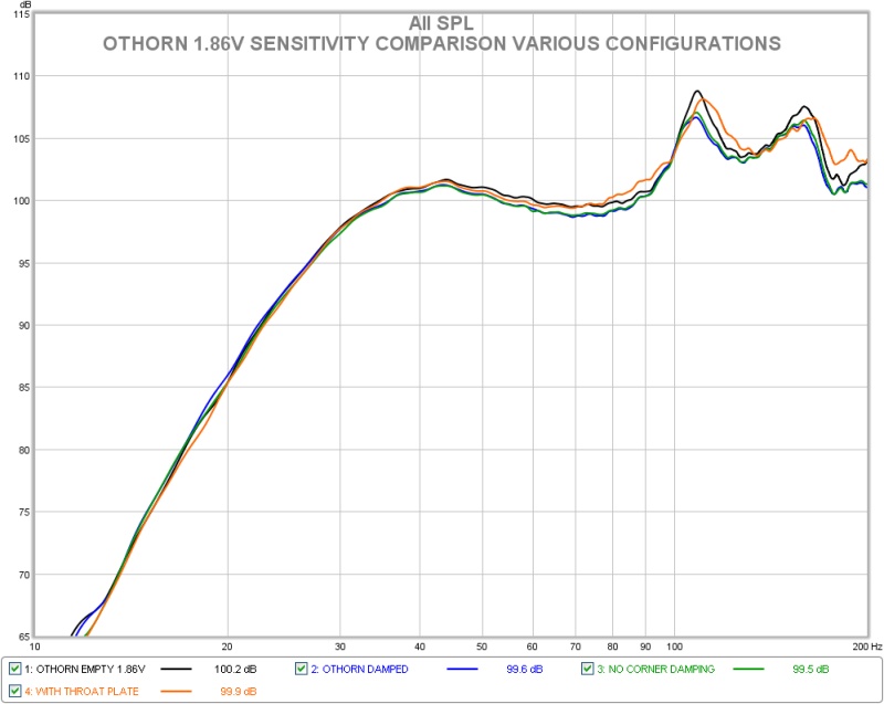

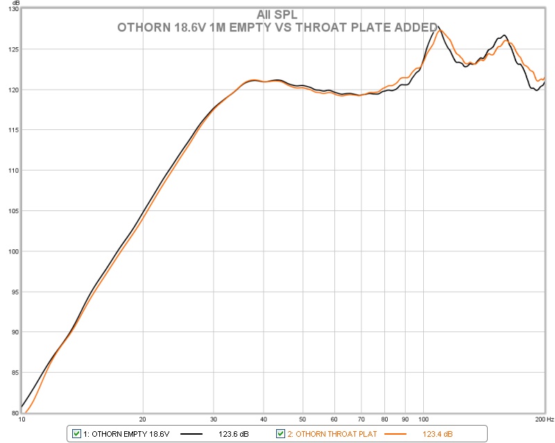

Here is the little bit of data that I have. Note that the correction plate was not by any means perfect and was inadequately secured. Due to the odd angle half way through the throat area under the driver in the original version of the Othorn it was not sitting flat on the panel opposite the driver and the 4dry wall screws I used for a quick and dirty method of attachment were not enough. I also did not do a whole lot of verification of clearances from the cone.
You can see that it did improve the flatness of the response and overall sensitivity a bit above 75Hz but that it did almost nothing below 75Hz. I do consider it an improvement in response with the plate but something happened when zapping the Othorn with a bridged K10 and test signals and a bad noise was heard. I do not know whether the pressure on the driver was too much, the excursion clearances were not enough, or the pressure inside the throat vibrated the plate hard enough to break it loose and then it made contact. Either way I ended up with a damaged cone. I glued the cone with rubberized CA glue to repair it and removed the plate and it then survived the test signals and many subsequent beatings with no issue. I meant to put a lot more effort into the correction plate and do it "right" and test again but since the effect with it in the cab was so small and mostly above 75Hz and the cabs are generally high passed below 80 or 90Hz anyway I got lazy and never did it. I still don't have a correction plate in the Othorn or the plans even though I've had it accurately measured and designed for awhile.
That's all I got. I haven't seen any actual measurements from anyone else on this subject yet.
The measurements are taken ground-plane at 1m at either 1.86v or 18.6v. (Back when I was doing calculated 1w into min impedance for sensitivity)There is no processing on the signal. Also note that there is no smoothing on these measurements. ;) Also note that the second measurements set has 2 measurements with varying degrees of dampening added to the cabinet. Both reduced sensitivity and output noticeably and really didn't do much in the time domain to justify it so I removed dampening from my Othorns and never used it or recommended it.

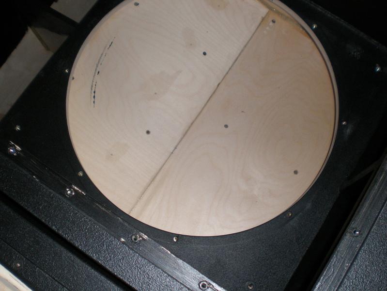

Hi Sine143!
"PASC did note "better cone control" with the keystone. if this give the keystone 2db more powerhandling (better excursion control)... that would explain the extra output"
Both cabs with 18NLW9600 Eighteen Sound. Pink noise with amp capable 2300W clean (no that ms thing). Also with WAV music.
KS LR24 20 ~ 200Hz OK with good cone control near flat. DSP8000 - ECM8000 not calibrated (so you know it decays below 40Hz);
Image - TinyPic - Free Image Hosting, Photo Sharing & Video Hosting
TH18 LR24 38 ~ 96 Hz with large excursion. Put lower than 38Hz lowcut at your risk.
Also tried in the TH18 the 18TBX100 and 18LW2400, but no more than 1200W with 18TBX100,and 1000W with 18LW2400 to make the cones dance(travel) a lot; result are like equal for these two drivers, so advantage to the 18LW2400 which costs less.

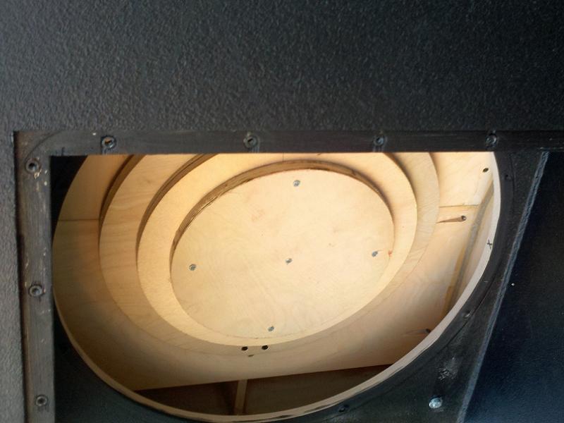

TH was made full of braces and corner reflectors, also filled it and KS with sawdust mixed with glue to avoid leaks at all corners, but not added at the time of the building, with cone correction apparatus.
Cone correction added to 6 SS15 boxes, and work at mouth to fix it from any vibrations proved to me, that also the lows missed before (40/50Hz), and now clear bass guitar notes from 80 to 100Hz playing thru it.
The reward for this work was a noticeable less cone travel and around + 2 dBs, using it LR 38 ~ 96 and or 100Hz band.
So, maybe work it into TH18 is worth.

As Ricci's measurements show, it's extremely unlikely that "cone correction" had anything at all to do with cone control, the missing lows being fixed or the +2 db. Mouth bracing probably had much more effect.
Is this completely subjective or did you measure any of this? Either way, was it tested properly outside or did you capture whatever info you have in an uncontrolled environment?
Also, unless your mic is defective it shouldn't be decaying below 40 hz. These mic capsules are very accurate at low frequencies, calibrated or not. It's at the extremes where it's inaccurate, very low in frequency (much lower than 40 hz) and most notably up in the khz range.
More subjective insight. The KS is louder than an SRX728 (by at least 3dB, probably more), and doesn't seem to be missing anything in low end extension.
My 18TBW100 that I managed to toast reached it's thermal limit far before it showed any signs of mechanical stress, the KS seems to control excursion.

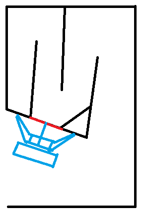

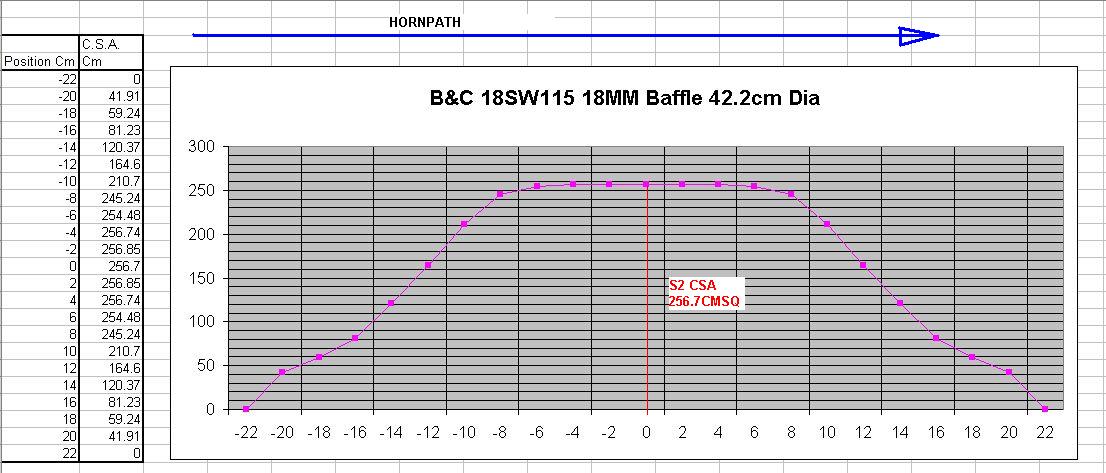

A cone correction is a theoretical path line that accounts for the volume of the speaker cone and baffle.
This allows calculation of the horn path without using Vtc and Atc in Hornresp.
This allows a accurate representation of the compression at S2.
When the cross-sectional area is plotted for the cone and baffle at varous points along the speaker horn path, and extrapolated to the width of the speaker it typically takes a shape which is like a flat bottomed vee, that tapers out to zero at the extents of the baffle cut out.
A Danley TH118 TH115 is impossible to sim without taking account of the volume of the cone and baffle as a cone correction path line, as S2 would be zero! :scratch:

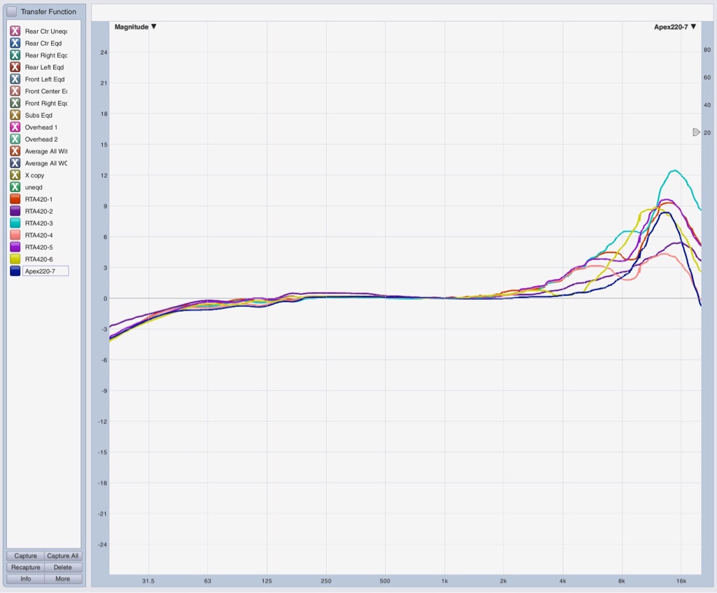

I own an RTA-420 (same mic that was mentioned during Art's tests of the Keystone), my experience is that it is most certainly not flat down low. Measurement of a batch of the same model by a member of another forum seem to agree with that experience.
Sent from my iPhone using Tapatalk
PASC mentioned ECM8000. IIRC that mic uses the Panasonic WM61 mic capsule, which is very famous for being flat without calibration. It's usually a bit off in the khz range but down near the tuning of these subs and up to a few hundred hz it should be pretty accurate.
Anyway, your graph shows only a 1 or 1.5 db deviation from flat down to the tuning of these subs, which isn't really even worth mentioning. I'm not familiar with your mic.
