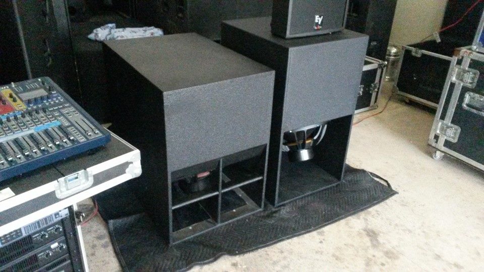

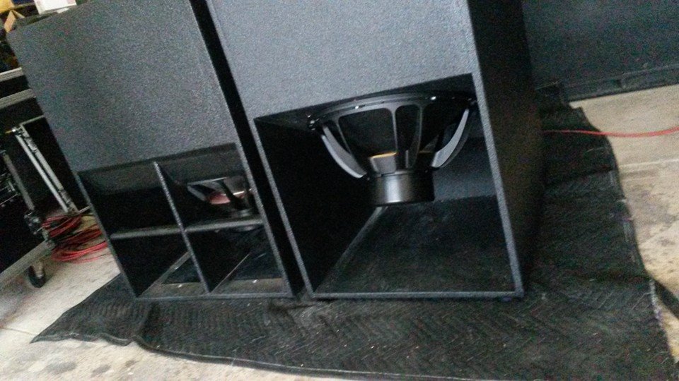

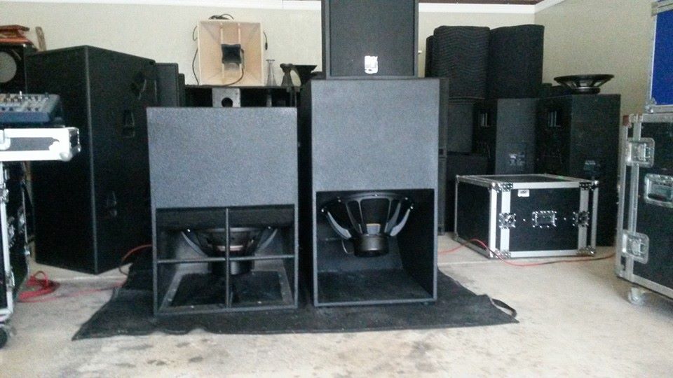

Hey ya'll. Had some fun jamming these two a/b today. Two very different monsters. Came out kinda how we expected. The xoc seems better than the othorn for psytrance, (most) house, dnb, kick drums, and anything a bit faster really. The bass is sharper from the 18" xoc, and sounds faster/more aggressive. Its considerably lighter, smaller, but several inches taller than the othorn. It does have a true deep 35hz slam to it, it is certainly not wimpy.
Where it falls short next to an othorn is with glitch hop, dub, and anything with a fat deep bassline. The othorn is gets a bit louder overall, and that extra 5hz lower extension is considerable. Those genres with deeper slower bass lines really come alive with the ground shaking and all that with the othorn. With the othorn you get this refreshing depth that you rarely hear. The xoc doesn't quite get there but its not too too far off.
Both have that impressive low 30-40hz deep "BOOM". Both have their own personalities across the response, with the othorn having an overall deeper tone throughout. We found we don't like running either over 80hz. We find both to be excellent. Hope all is well :D

If you were to put two "holed" braces in a V pattern connecting the underside to either side of the driver, would that help the underside stop flexing?
I want it to be fair when we go outside so I think we will rebuild with some bracing on the xoc. upon searching we found a few diff ways people have braced it. Also gonna figure out a clever way to add a beefy grill because boy oh boy is this 18sw115 hanging out there in the wind just begging for a dixie cup or beer can. I want to build a keystone, weltersys seems to def know his stuff. If the xoc sounds considerably better with the bracing it will be a real big winner in my eyes (because it sounds awesome already). Its such an easy and inexpensive build and it slams. Im sure this has been known be all for a long time lol. Hey sine im rebuilding my tops 3 way!!!!

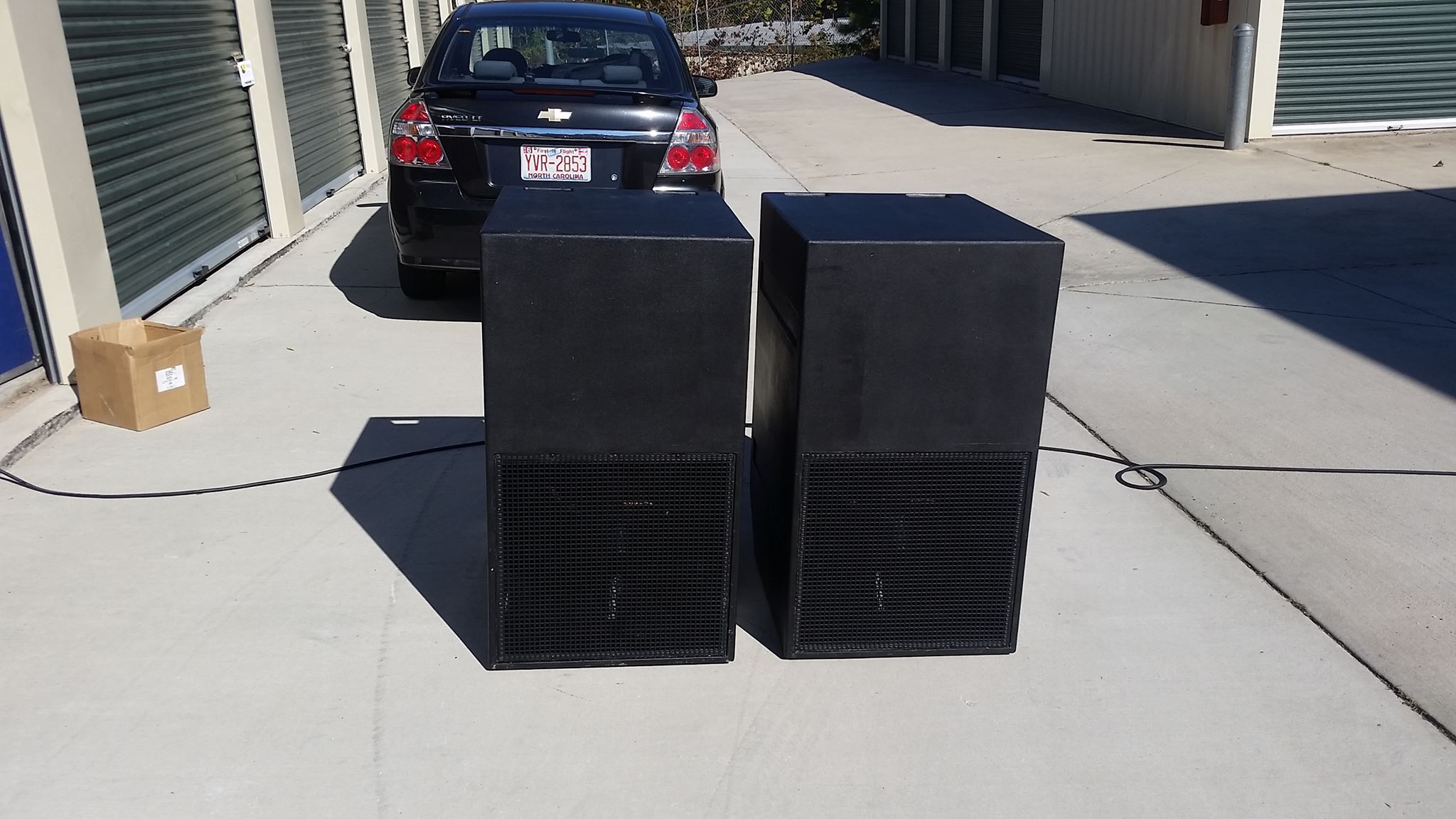

just build a keystone and throw one of the 18sw115 drivers in it. a tapped horn doesnt get much easier to build than the keystone
you can see what I mean by "strips of 3/4" in the mouth. also shows how the grille was mounted. i put foam on the grilles shortly after this pic.

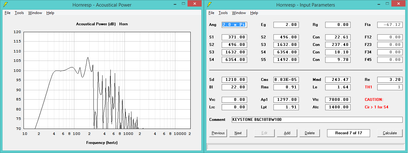

You might want to look at the keystone thread. Art mentions that you can trade off a little sensitivity for more extension by making one dimension longer. Easier than designing from the ground up and the design is comparatively simple.
B&C 18SW115 XOC shaded vs. Keystone in black @ 1W.
Truthfully the OTHORN trounces both on paper but as you allude to, size, weight, power needs, and cost are all factors. Then there's the LABhorn with more of the same problems, plus you need multiples to get the extension. I recall you need 8.
I was fortunate that Art took an interest in my threads and here is a post of his thoughts which highlight some relevant info: (snip)
The reason I designed the Keystone was to get more output from the same truck space. Using the same power (Crest CA-9), and one BC18SW115-4 (bridged mono) compared to 4 Lab 12 (two per side of the amp) in dual ported enclosures, the Keystone outperforms them in every regard.
As a reference, the four dual Lab 12 had more output at 40 Hz than eight dual 18" Meyer HP650.
The price increase of the neo driver now would make me choose the BCTBW100, only slightly less (ultimate) output than the BC18SW115 for a lot less money.
The Lab 12 loaded Pal12 is a nice "bite size" cabinet, but the big gun B&C 18s" are simply way better drivers, and a single 18" Keystone is lighter, easier to build, and 21.5% less truck space (15.52 cubic feet compared to 19.79) than a pair of PAL12.
Art(end)
I think the Keystone really fits the bill of what you want and it's worth the investment in sawdust and time to see for yourself. You already have the driver...
