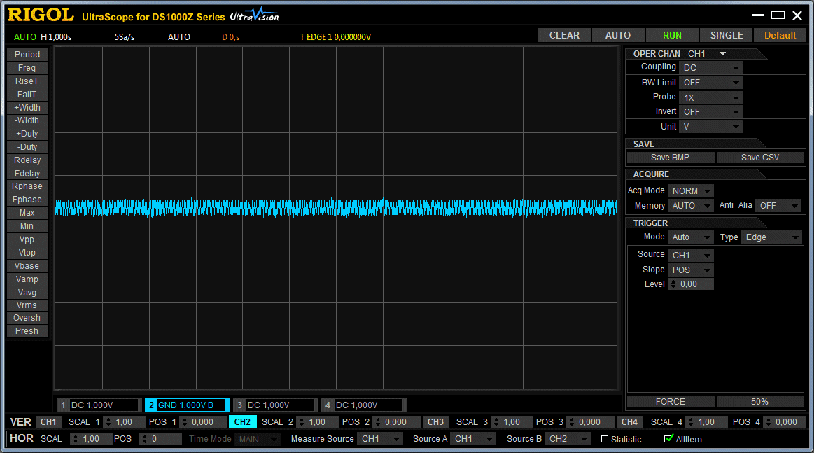

Hi anatech,
I installed the tools for remote access to the Rigol which also included some stuff from National Instruments (NI MAX). Although it looks like something I might sometimes use at work, I'm not really familiar with it (I'm only a user, I don't install or set things up with it).
From Rigol's site I downloaded the tool to remotely access the scope (via USB or LAN) and it works, but I'm not impressed. The tool doesn't fully work (yet?). I can control many functions remotely, but strangely, not the vertical or horizontal scales. There are controls for them, but they don't respond.
Also, the update rate of the screen on the computer monitor is really poor, typically somewhere around 2 to 5 times per second.
It looks like the tool ("Ultrascope") isn't really finished yet. I'll post a screenshot later.

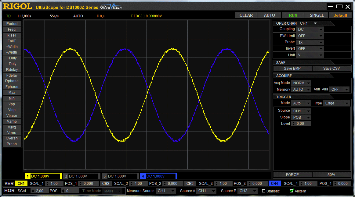

The connecting part works fine, but the remote operating part can do with some improvement.
The first attachment shows what it looks like on the computer monitor. The second is what it looks like when the screen is captured by Ultrascope. This is the same as when it is saved on a thumb drive directly on the scope.
Compare the sampling rate of both captures and weep... (I'm assuming that the 5 Sa/s on the PC screen is actually the update rate, the scope is sampling at 500 MSa/s).

Jitter,
What's the noise on the signwave? is it oscillation on the source or is it sampling effects of the scope? - apparently your at 1V per DIV so I doubt its noise?
To me it looks like a HF signal riding the Signwave - I typically see this on an Analogue scope when there is low level HF oscillation (say from an incorrectly compensated Opamp).

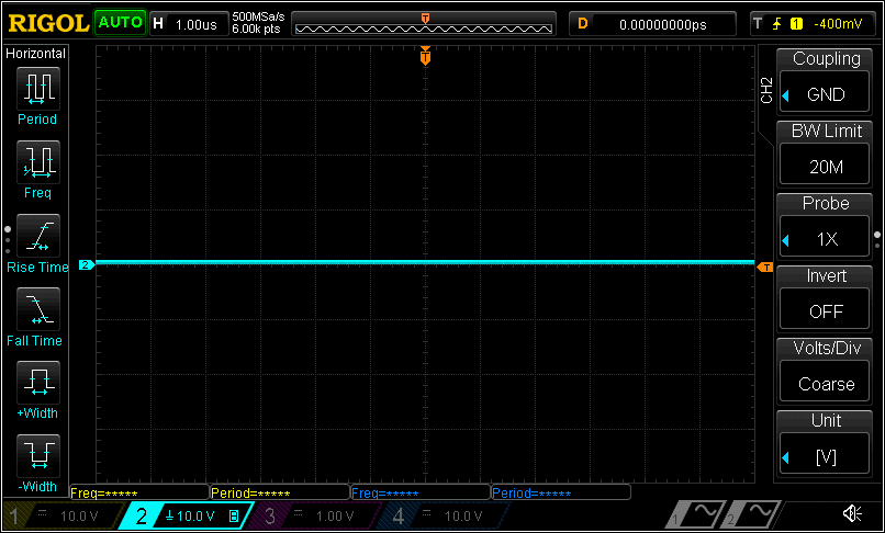

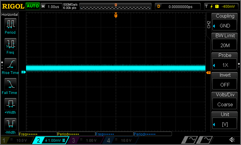

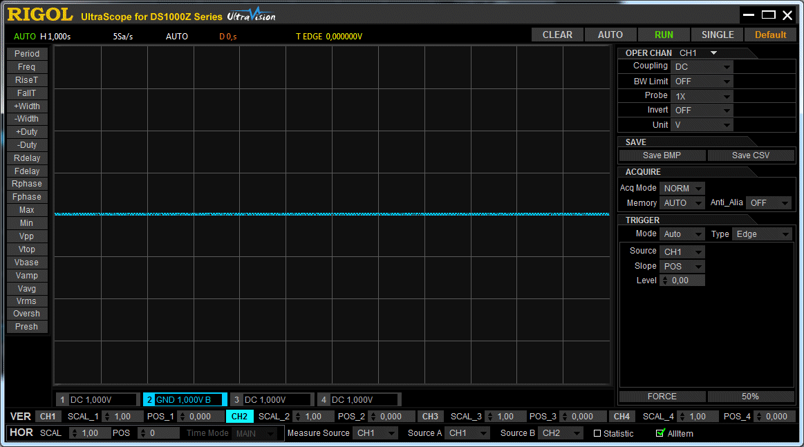

Here are some more attachments. First and second are with the input switched to GND and scale most sensitive (1 mV/div). The third and fourth the same with the scale in the least sensitive setting (10 V/div). Don't mind the settings shown in the UltraScope tool, many of them are incorrect. The screendumps from the scope (second and third) are correct and as shown on the screen of the scope.

Your first screen shoot is amazing as if I "read" it correcting the input to the scope is grounded and at 1V DIV. and yet there's so much noise - is that really possible?
If its the scopes Noise floor, then this will hide any HF Low level oscillation you might have riding on a waveform.
I wonder if its a Software issue?
Edit - I see you say there are at 1mV not 1V Div as indicated, then its OK! I could not believe it was that Bad!
Why the indicated scaling error?
Yes, the scales, coupling, etc. indicated by the remote controlling tool on the PC (UltraScope) are incorrect, that's why I also included the screendumps generated by the scope (and of course to show the difference between what UltraScope shows and what the scope itself shows).
I'm assuming that the problem lies with the UltraScope software as the scope itself seems to work fine. But I have yet to look at a forum to see if other people experience the same issues with UltraScope.
Edit: of course the following from my previous post was wrong: "The screendumps from the scope (second and third) are correct and as shown on the screen of the scope."
It should have read: "The screendumps from the scope (second and fourth) are correct and as shown on the screen of the scope."
