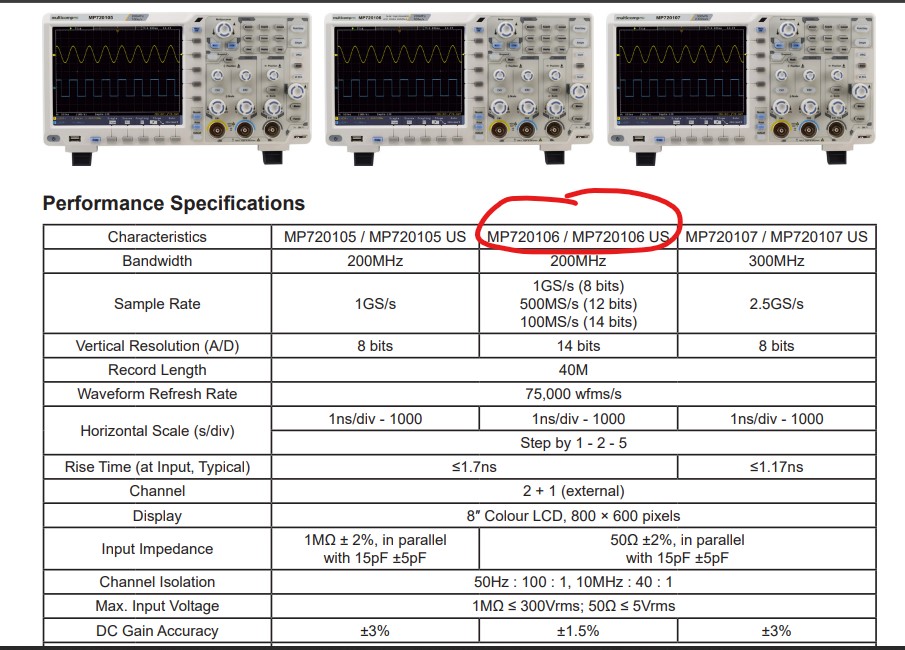

I've been looking at possibly getting a new 'scope. Currently using a 100Mhz analogue one that will be around 28 years old now.
It seems to me that resolution is everything here when talking of digital one and that 8 bit is by far the most common. That to me leaves a lot to be desired.

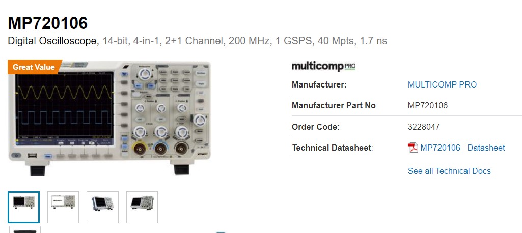

Any thoughts on these, they are a Farnell 'own brand':
https://uk.farnell.com/multicomp-pro/mp720106/dso-200mhz-1gsps-1-7ns/dp/3228047
There is a 14 bit 200Mhz model which also has a signal generator/arbitrary waveform generator and DVM built in. Very unusually (to me) it also has a battery power option.
https://www.farnell.com/datasheets/3215892.pdf
There is also a cheaper 12 bit 100Mhz model:
https://uk.farnell.com/multicomp-pro/mp720024-eu-uk/dso-2-1-ch-100mhz-20mpts-500msps/dp/3107582
https://www.farnell.com/datasheets/2816290.pdf
These seem (to me anyway) far better specced than many of the usual suspects.

@Mooly: these scopes look loke Owon OEMs. Do they really sample with 14bit hardware wise?
I think they achieve higher resolution by oversampling only at the cost of reduced bandwidth.
Isn´t that similar to ´High Resolution´ or ERES used by other companies?
