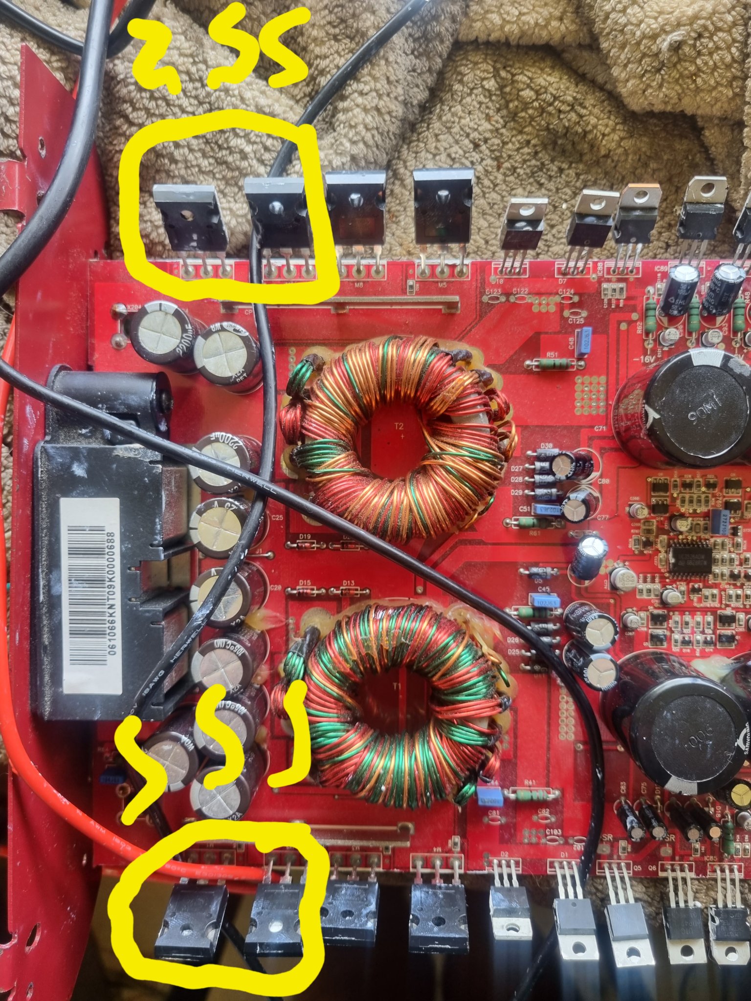

With Q713 fitted and it initially draws upwards of 13A. Once it settles down and just pulsates only these 2 groups on each side are getting warm. (Circled in photo) others remain stone cold.
They do get very hot on the initial start up when it's drawing 13A.

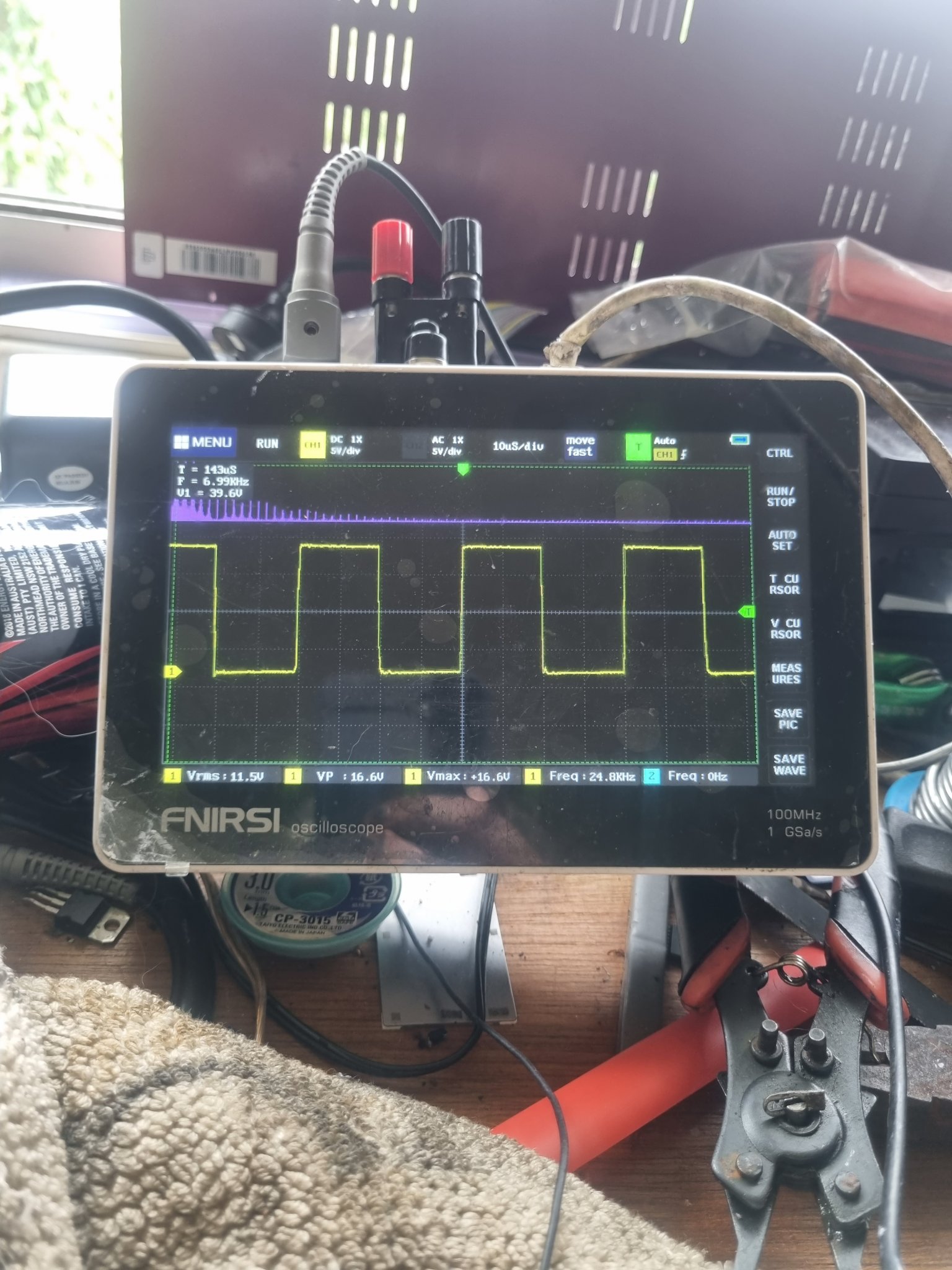

Do the signals on the gate legs of all of the PS FETs look the same? Q713 in or out of the circuit?

Without q713 in circut all the power supply mosfets get the exact same signal on all legs.

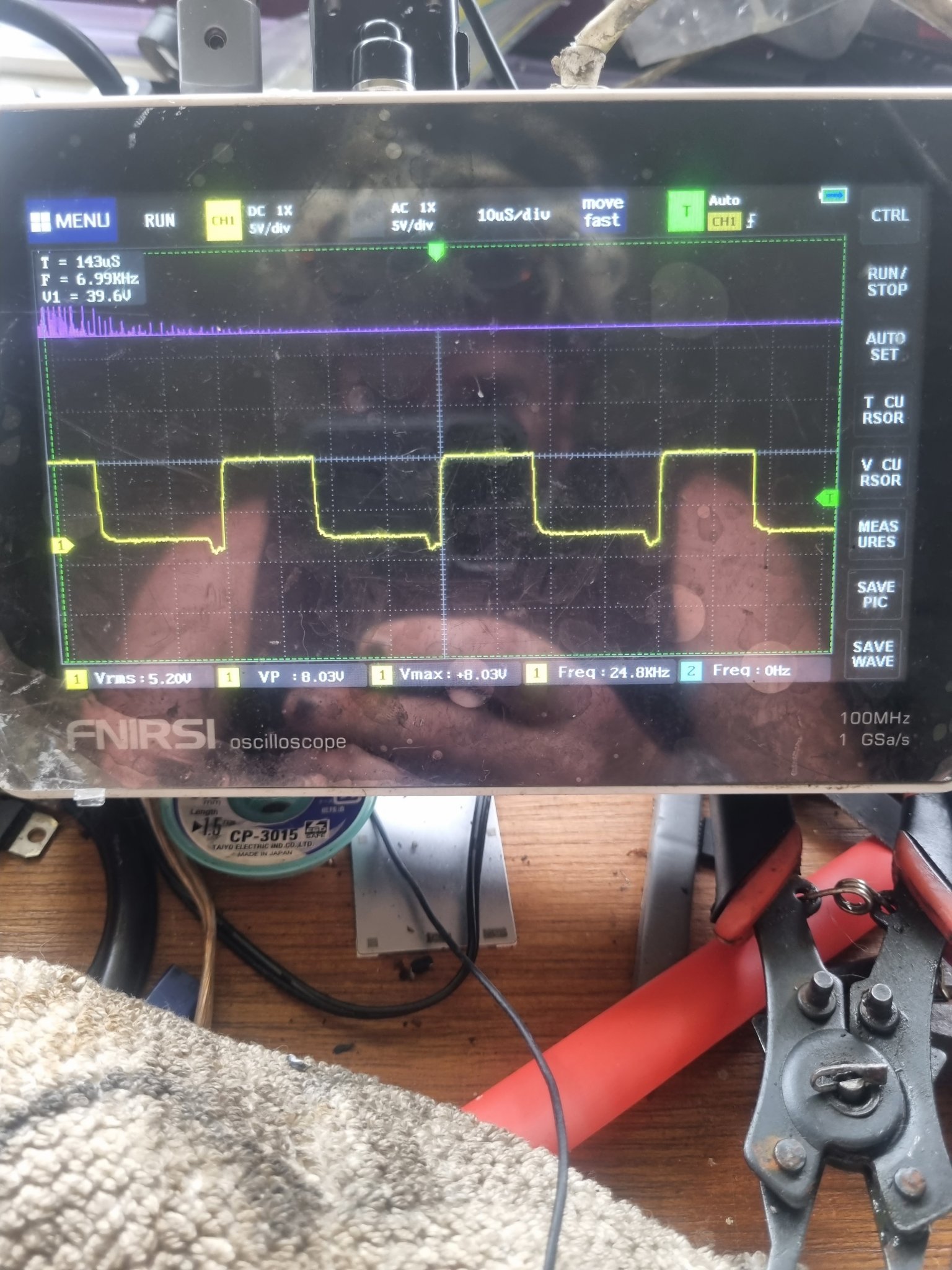

With q713 in circut it's almost impossible to see as it just winds up and down probably once per second so its basicly impossible to see.(looking for signal on the PS fets)
