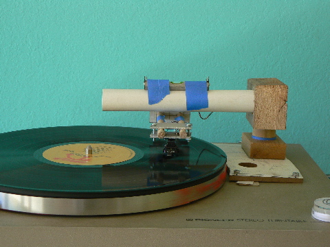

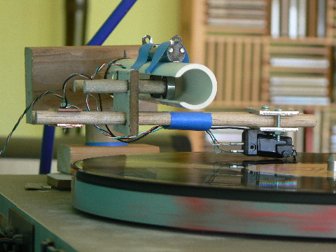

This Opus clone was cobbled together as a proof of concept project and this is its Initial Public Exposure. Obviously, without PVC and blue masking tape, I'd never be able to build anything so, again, what EC8010 called "rustic."
The bearings are $5/pair remote control model car parts. I removed the seals and lubricant so they roll more freely. The PVC interior is highly polished. Horizontal movement (rolling bearings) is quite good - no hitches or stuttering as long as the record is clean. This arm does not like dirty records. Vertical movement (sliding bearings) of the arm is stiff. Setting the VTF is difficult and, although the arm does follow warps, the stylus winds up doing a lot of the work. The polished glass tube and carefully chosen bearings would help. Figuring out the arm mass and relative weights of head shell and counter balance was trial and error. I probably didn't get optimal results.
Regardless, it works and it's definitely DIY possible.
The sound has a remarkable presence and is very enjoyable with a deep 3D stage and the best bass - detailed and musical - I've ever heard from my system. The sound is transparent so voices and instruments are clearly delineated.
After seeing the Opus pictures, I just couldn't help myself. It's encouraging to have obsessions turn out well.

Doug: nice knock up. I do like the spirit level nice touch. Clear Audio make the "STATEMENT" yours might be what you can afford to build after the divorce so perhaps we should call it the "SETTLEMENT".
Try giving the trolley assembly a degree or two of downward tilt to provide a little help to make things roll along easily. Great to hear that it works and sounds so good.
Is it good enough to temp you to give up on the thread suspension arm that you have been working on? I can't quite make out from the picture but one of those tip mounted record brushed might provide a tad extra trolley drive and also provide some relief for the cantilever and its suspension. Nice job Doug I am sure that this will inspire some other folks to try some ideas out. Do you think you might be talked int trying out a metal tube for comparison? Thank you for posting your pictures. Best regards Moray James.
Doug I just had a simpler idea to check out friction of the PVC tube. Make a little dam at the end of the tube with putty or the like and with an eye dropper insert just enough alcohol to wet the bottom of the tube. Single Malt Whiskey works best for me but that seems such a waste. Running wet should reduce overall friction quite a bit and you can see if there is any significant improvement. Faster and easier than building a metal tube. Regards Moray James.

Thanks. I hope others will take a shot at an Opus clone, but I also hope that some of the other ingenious ideas and approaches from this thread will become working models - like BillG's glass-lined V trough. Part of doing my half-assed builds is to show it doesn't take an engineering degree and fully-staffed machine shop to produce something workable and rewarding. Funky materials and a home shop are just fine for a first approximation. Big bucks and obsessive precision can come later, if they're justified.
I noticed, looking down the tube, that a bit of trolley angle - either for or aft - might help, but I haven't quite figured it out yet. The cartridge is a Shure w/dust brush. I thought it might help with lateral movement, but I've tried the arm with the brush up and down and didn't notice any difference.
I'm still working on the string arm - that's my baby and it still has some growing up to do yet.
I've got copper tubing that's the right diameter, but that's for another day. In the meantime, I'll try the alcohol idea and report back. If I ever make a Schroeder quality version of this thing maybe I'll consider putting single malt in it, but not 'til then.
