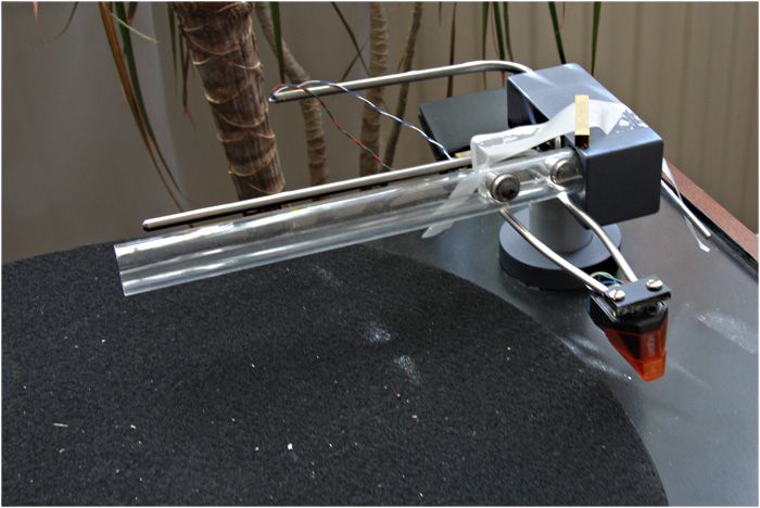

I had the pleasure of hearing the Clear Audio linear tracking tone arm yesterday.
Its a substantial piece of equipment and compared to the Opus, some might say over engineered. It is solid and heavy. The entire arm lifts up vertically and locks in place for record removal.
I got a good glimpse at the bearings. They are tiny and have a rounded surface, fitting perfectly inside the glass tube. They were smaller than I imagined. The arm tube is thin and short and carbon fiber.

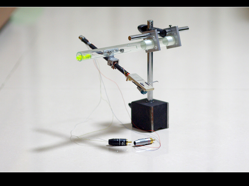

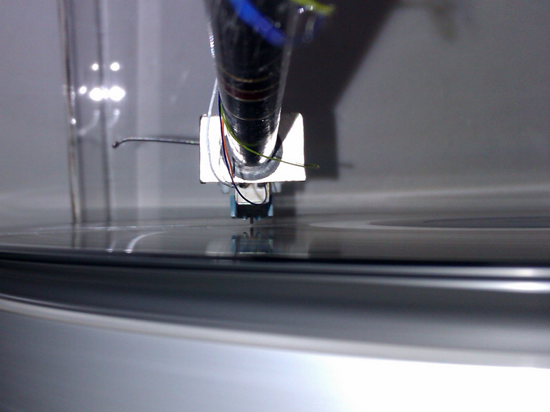

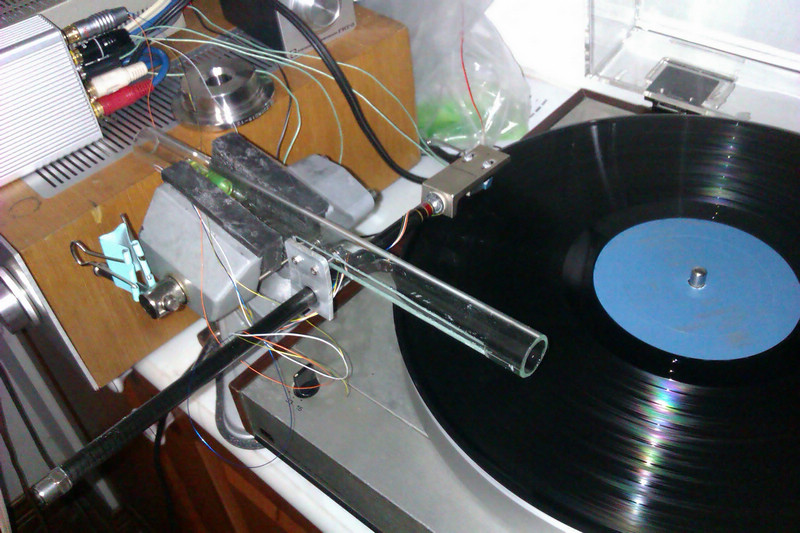

dtut,
I place this arm on the table , left side of TT without any glue on base because the base is heavy enough to keep its steadiness.
I adjust the the tube position to keep stylus in linear tracking and right VTA(about 20 degree) firstly,and then stick two square card on table to limit the position.
I didn't weigh the total sub-arm,only weigh the stylus pressure is 1.6g for EXCEL ES-70S.The stylus basically stay in the centre of sound track by my visual observation,it can smoothly move form the beginning to end if the record in good condition(without deep scratch).
I‘ve fixed an arm lift on this tonearm,and will upload a playing video lately.
The 2 key points for DIYing this kind tonearm is:
1、the inner surface flatness and cleanness of glass tube;
2、the smoothly of small bearing,you need high quality bearing.(My choice is SKF MR83)

my glass tube tonearm
eaglebear,
Great experiment, and thanks for the video of it in action. What have you used for the vertical pivot bearings? I have been thinking about building a lt arm with vertical pivot bearings and have put together a crude test unit. So crude it has lots of problems and promise. The most important feature is the ability to set and measure VTF. I find it very difficult to do in the original CANTUS design.

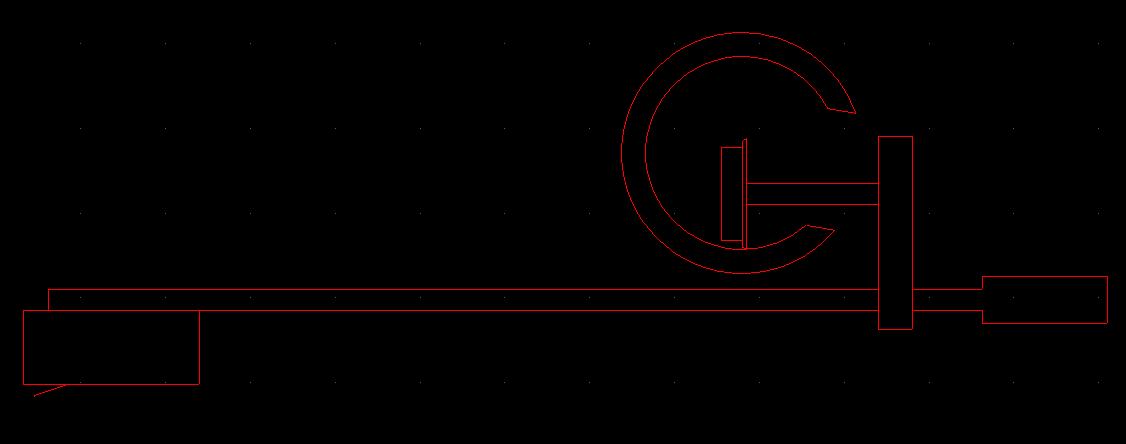

If you look at Bo's early design he did in fact have a vertical motion component. Bo used what I would call a rolling knife edge bearing which allowed the arm to pivot back and forth like an SME3009. This aspect of the design was later dropped for the current two bearing four point contact design. I discussed this with Bo as I had been considering a rolling knife edge design myself. Bo convinced me this was not the way to go. Bo had a lot of hands on experience with the design and his later version is from accounts superior to the earlier version. Best regards Moray James.

yes!I fixed two micro bearings(size:1*3*1) in arm bracket for arm vertical pivot, this point is different from Opus.

Here is a drawing of Bo's original bearing assembly as you can see this is essentially a "rolling knife edge" bearing. Clear audio have copied this style of bearing though they executed it in a different way it is the same thing. Bo was adamant that the more motion the arm allowed the poorer the arm will sound. I think Bo is right. Best regards Moray James.
