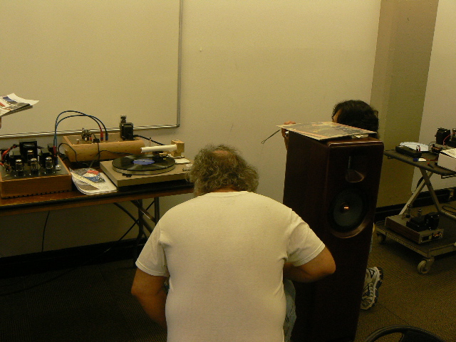

I took my Cantus clone to the Burning Amp Festival this year and it got intense attention all afternoon. That record was eccentric and people were fascinated watching the arm move back and forth and not skip. Despite that, I don't think anybody else decided to build one and I don't quite understand that. Mine is crude and ugly - maybe that puts would-be builders off. But, as Robin' arm shows, they can successfully and attractively be built with hand tools and easily available cheap hardware. Even good bearings aren't expensive. Robin's long bolt for the tower solves a whole bunch of set up variables all at once.
And when the arm is built, it produces great music.

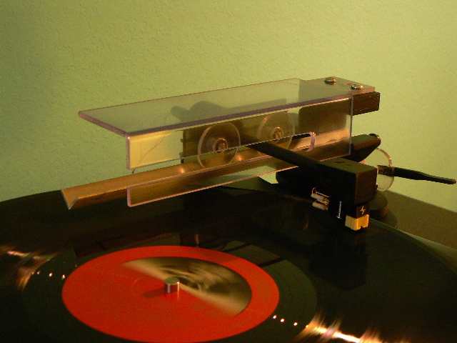

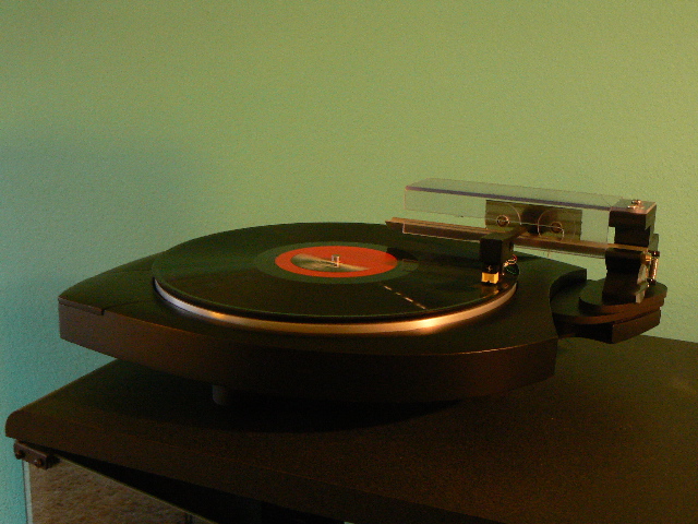

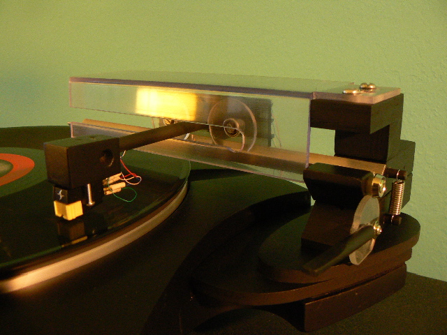

Good morning,
This is my latest LT. I made some concessions to appearance with this one. The cover is from a broken TT lid with the arm lift/rest built in. The tower is hinged at the back for arm lift. There's a registration pin between the upper and lower halves for alignment and the spring compensates for the torque caused by the additional weight of the cover so things stay level. I finally figured out how to work acrylic, so naturally I went overboard.
This is the first LT I've built that I can fairly confidently measure VTF on and it tracks very well at Shure's recommended maximum 1.5 grams for the M91ED, although it may have sounded better at about 2.5 grams. I played a record that is both eccentric and warped so the arm was doing cycloids all the way across - it looked drunk, but no skips and the stylus stayed centered.
OK, I'm going to bang the DIY drum, again. Despite the focus on appearance this time, except for the bearings, this arm was built with scrounged materials, in a relatively limited shop. A basic arm can be made with hand tools and the result and reward can far exceed the effort.

Thanks Stew,
I built the plinth a while back. The platter is from an AR corpse and the motor from a BIC. The 3D geometry challenges involved in matching the new arm to the plinth were the hardest I hit on this project.
A friend mentioned the Marantz SLT-12. I googled it and, since I've gone to the dark side of complication, instead of sticking with the simplicity of the Cantus - and your 219 - I think I've found my next project.
The SLT-12 is beautifully engineered and the innards are almost sculptural, but I can't help wondering why Saul thought it had to be designed that way - and what he knew that I don't.

I did a bearing comparison last weekend. The original bearings that I used for the project had ceramic balls in a stainless frame. They had quite a bit of play after flushing the grease. I ordered several different types by mailorder and here is what I found:
The lowest friction were the glass balls in a plastic casing. The sound was dull, a lot less bass and definition compared to the ceramic bearings. I then tried a standard bearing with a teflon cover. The cover seemed to increase the friction, I could see the cantilever flexing laterally. The sound was OK though. After removing the cover, the flexing went away, the sound was still OK, just not as good as the ceramic bearings. The final comparison were chrome steel bearings from SKF. These things are incredible - even better than the ceramic. Soprano voices had less stridency, the bass was still powerful and clear. No noticable cantilever flexing.
I put a USB connector/jack on the RCA end of the cable. This allows me to remove the arm wand/wire for cleaning or protection from my wifes dustcloth.................
Again, a very easy project that simply sounds great!

This looks really cool!
My experiments with the Cantus type geometry show that mechanical grounding really helps the sound. Could you try a glass or hard metal disc instead of plastic?
