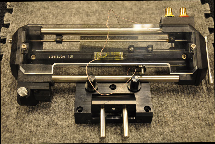

3 point carriage
Since people talked about 3 point carriage so here's more pictures of bearing mechanism of Souther and early Clearaudio when they still use 3 roller carriage assembly before the recent conversion to Cantus style. The triagular carriage has two rollers in the back and one in the front.
vinylengine.com/phpBB2/album_showpage.php?pic_id=13527&user_id=97278
vinylengine.com/phpBB2/album_showpage.php?pic_id=12185&user_id=97278
___________________________________
The curious thing about the Clearaudio arm is that their flagship model TT1 has the arm above the rollers and whereas TT2 and TT3 have the arm hanging below the rollers.
