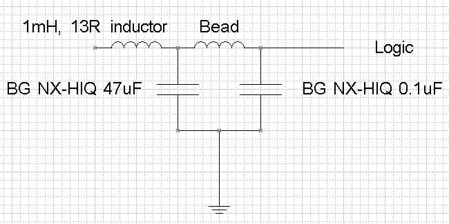

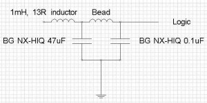

How about this decoupling scheme?
The key features:
1) No capacitors directly connected in parallel. There is resistive damping between each capacitor. (This should reduce possibility of resonance within the arrangement and across the board)
2) Use of inductor and ferrite to filter a wide range of rf
3) Small bypass capacitor with short PCB trace near IC
4) Larger reservior capacitor
5) Low noise, quality capacitors throughout
Anyone tried something similar?
(P.S. looks a little like TNT Convertus PSU arrangement)

Re: How about this decoupling scheme?
I'm not sure if you read my link, so here I quote it:

Don't forget the key to making all this work:
Keep the loop small to minimise EMI.
I believe that Guido Tent demonstrates this in the link that he refers to. Required reading.
(Hope the url is in this thread somewhere, 'cuz I am not certain what it is.)
Ferrites don't really "filter" RF they absorb it. Their resistance at high frequencies keeps parasitic resonances down, without creating IR losses at DC like a resistor would.
Oli:
Small caps are used close in as they become self-resonant at a frequency hopefully higher than what is present. Too low, and they will become self-resosnant at a point below the operating frequency.
Check Wima's site.......they should show how SRF is a function of capacitance for various values. (At least if their site is like their catalog.) This may give you further insight as to how all this works.

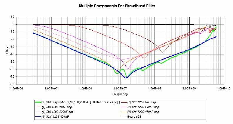

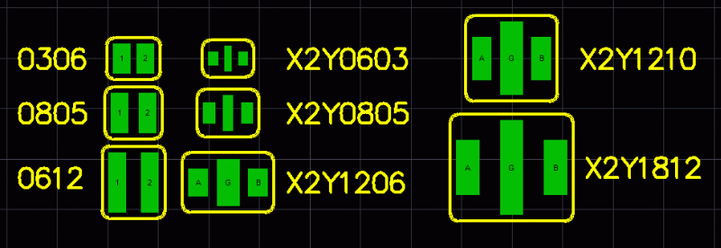

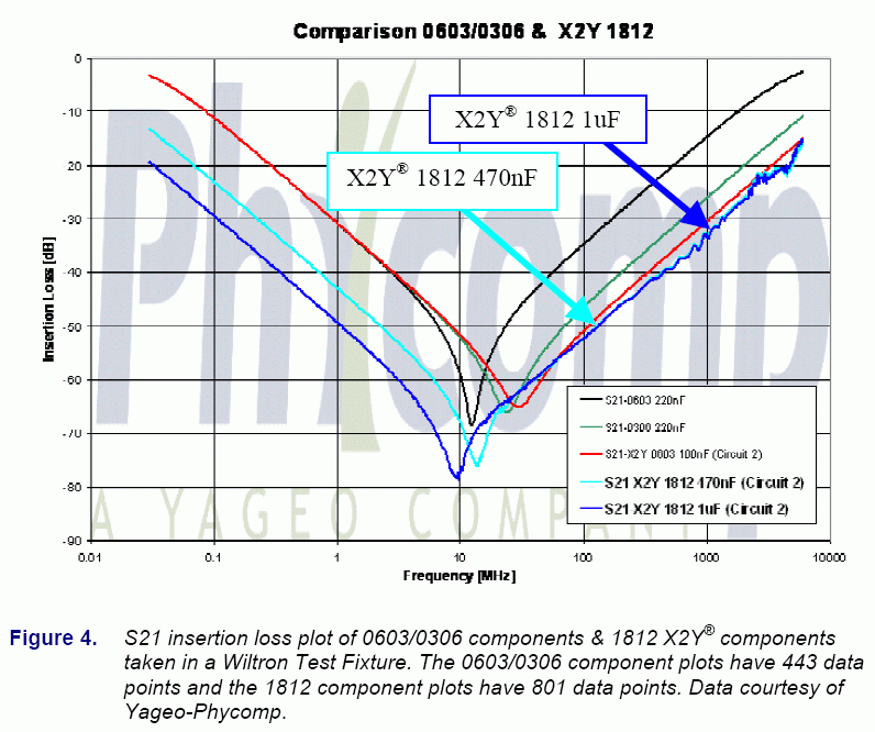

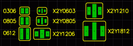

there is no point in stacking various ceramic capacitors. Above resonance impedance is governed by parasitic inductance which is the same for all same size capacitors. Only effect of stacking is reducing inductance by paralleling chips. But you could use same value chips for that, in fact higher capacitance will give better overall results. The only means of improving decoupling efectiveness is reducing parasitic inductance. The only way of reducing parasitic inductance is keeping LOOP AREA small and NOT using short tracks spaced 5mm apart. Also using capacitors with small intrinsic inductance helps. Of course there is no point of using DIP chips instead of SMDs, if they are abailable.
New types of low inductance capacitors are from AVX and from X2Y.
Attached is picture showing effectiveness of stack of 5 various caps (green) against one X2Y cap (blue).
Best regards,
Jaka Racman
Best regards,
Jaka Racman

You plots reinforce what I suspected...
Jaka,
- A smaller value of capacitor will have a higher resonant frequency.
- A larger value of capacitor will have a lower resonant frequency.
- The larger capacitor has lower e.s.r. and has greater attenuation than the smaller capacitor throughout the range.
So what if we used a large capacitance, low esr electrolytic- e.g. 50uF?
This should be fine for decoupling as long as traces were kept short. In addition it would act as an energy reservior. Since there are no parallel capacitors there would be less chance of oscillation.
The enemy is lead inductance- Historically ceramics were developed as a cost effective and compact capacitor for use in early computers. They facilitate shorter traces- that's the only reason why they're good. As Guido states in his article (see Guido's link) Compared with older electrolytics - "Modern electrolytics are far better Rf performers."
Keep the loop tight!

Anyone tried OsCon and BGs in the same supply line?
We're not talking about decoupling here; rather the elimition of residual supply noise-
- Initally use Os-con to clean up
- In addition use BG to reduce the noise floor even lower
Jaka Racman said:Hi,
seems that there are better alternatives than 0306.
Jaka Racman
That would be great but for one or two glitches.
1. The X2Y chips require more complex routing
2. The X2Y technology chips appear difficult to purchase - where can one get them?
3. The size of the 1812 chips means adding "significant" trace lenght when using really small digital devices.
4. Silicon chips posted earlier provide even better high frequency performance as far as I can eyeball it.
Naturally, I welcome any good alternatives, but for me the AVX chips will likely be "optimal".
Petter
1. Depends on the application, sometimes they are even more suitable.
2. Farnell carries them.
3. 0306 recommended footprint is not small either. Also X2Ychips come in smaller sizes. Below is a picture of recommended footprints for both types. I do not think that 1812 is optimum solution either, but smaller sizes still outperform similarly sized high aspect caps. But you can not solder them directly on the component leads.
4. Fres=2.21GHz, C=12pF => L=432pH, not better than 0306. Eyeballing can be deceptive.
