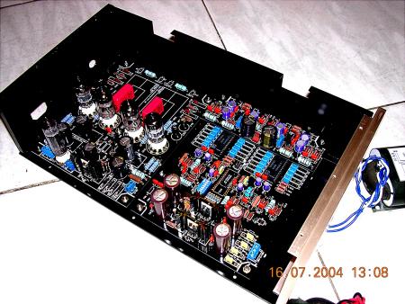

Dear jewilson,
I agree your comment, if U choose OS-Con, unless U change to Blackgate non-polar. NIL will better than that.
Do U know that Dell server Grade display card also use OS-con.
Thanks for your comment for my PCB, KITS.
pls see the photos.
I combined use OS-Con, panasonic pureism & Elna non-polar in my tda1541a kits already.
Pls see the full funish photos.
thnaks
thomas

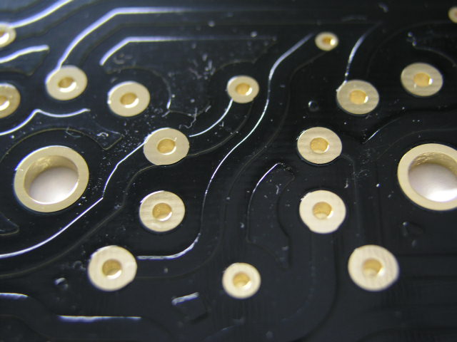

Dear jewilson,
PCB factory told me that gold plate really good. Signal run more smooth. They test in hifU know data is data, as I said, can U told me why graphit carbonate can made the digital data run fast speed will less error. Enclose by graphit carbonate PCB can run very stable & smooth. NObody will know, why intel coming i925X,DDR2 ram all high speed display card need use this type enclose to make PCB.
May be there will some unknown reason but we did not know.
I trust my friend becauase he make PCB, computor PCB monther board, Dispaly card. IBM, Accuphase PCB also his client.
If as U said not need gold plated, I will not agrue with U because I don't know. but I saw although low speed CPU, GPU below 2.4Ghz all need gold plate.

Graphite carbonate might make a very good substrate or pcb material. FR4 material for a PCB is not the best thing in the world that for sure. I know some people that make pcb's out of Teflon but that a night mare to repair and solder but the capacitance is low.
Did you know that a lot of the very old HP test equipment had Gold plated PCB’s? They stopped that along time ago and they claimed it was no advantage. I have an older distortion analyzer that has gold PCB and even Threshold amp that has Gold pcb you might ask Nelson about that.
Also, the reflow of tin dose not add to the performance of a pcb bare copper is better. The Solder mask type too can affect performance.
[Did you know that a lot of the very old HP test equipment had Gold plated PCB’s? They stopped that along time ago and they claimed it was no advantage. I have an older distortion analyzer that has gold PCB and even Threshold amp that has Gold pcb you might ask Nelson about that.

let talk about the Graphite carbonate enclosure. The factory only told me that this material will not catch any electric stastic . This is the reason that can lower the error during High speed digital signal running. Pls considerate the coming I925X is 1066/ approx 1G FSB.
About the gold plate. I would like to tell U there will had different type of Gold plated method. Some is not plated real gold. some may be 18K,20K 22K 24K.
My PCB is 24K gold plated. Its very thin, only 1 micron. Pls know that the gold plate & the Graphite Carbonate will cost me 25% more than the lead trim/coated. I was a diyers. I know diyers heart. We did not satify standard consumer products. May be we like tailor made more. But it cost more money. Me too. But now I can use reasonable money but can produce very good quality goods which benefit to more diyers. Hope U will understand what I say!!!!
About FR4 is a standard of PCB. I PCB also FR4 grade but 2.1mm thickness. which can resist the vibration.
This is the best what I can do in reasonable price.
