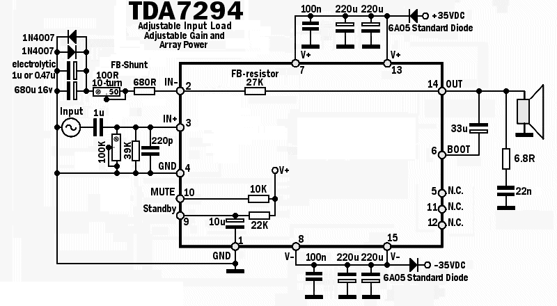

Need of compensation changes with board layout. It is a "moving target" problem. The schematic that you found is for the Jim's Audio TDA7294 single layer mess. However, it is noticeable that the Parallel TDA7293 board doesn't use lead lag comp at all.
Here's a TDA7294 schematic schematic without added comp.

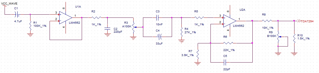

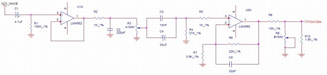

Keane,
To answer your question, I quickly drew up what the preamp section of this HEAVILY modified AudioSource amp looks like.
The topology of the factory amp is the same, but I've heavily modified the values to achieve a much flatter response than normal.
The droop you see in my non-compensated response is actually due to two different things:
1. The R2/C2 combination
2. The C5 value through the U2 op-amp
These values are what is currently populated and being measured. I have no idea why audiosocure wanted to boost the output about +14dB through the op-amp, then immediately yank it back down to 0dB with R10, but they did.
Anyways, I hope this helps. The TDA7294 appears to be waaaay more than stable (at least in this design).
So output impedance is at most 1.5k. With such a large RC across the inputs, input impedance can be changed enough to cause problems with reasonable source impedances. I'm not sure how much that applies in this case.
You may think about trying to lower the source impedance. With many poweramps a large source impedance will bring out more distortion.

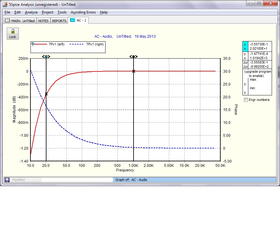

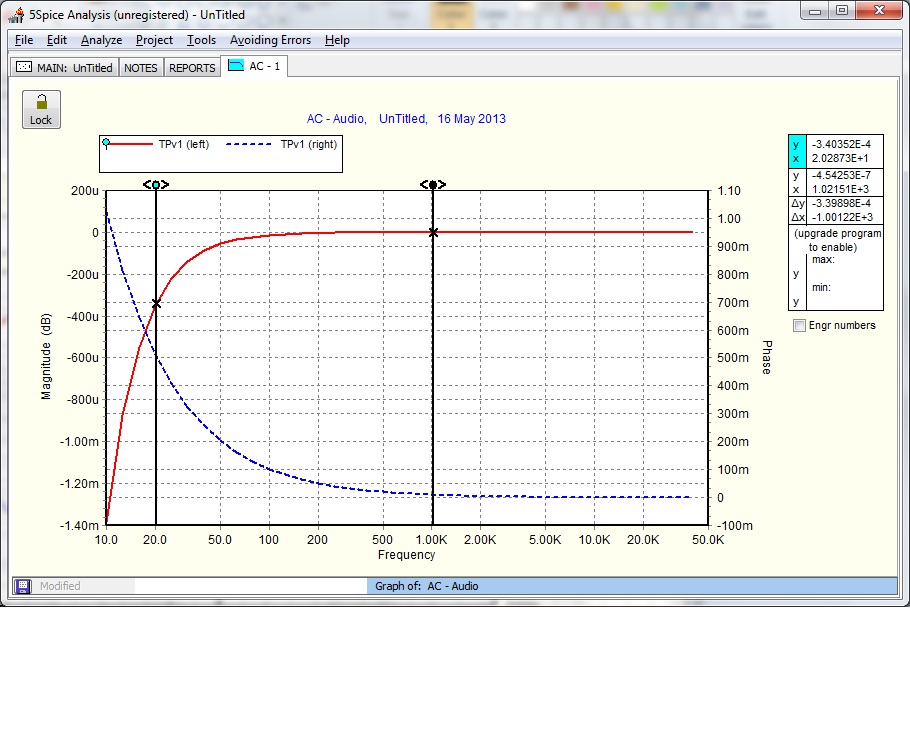

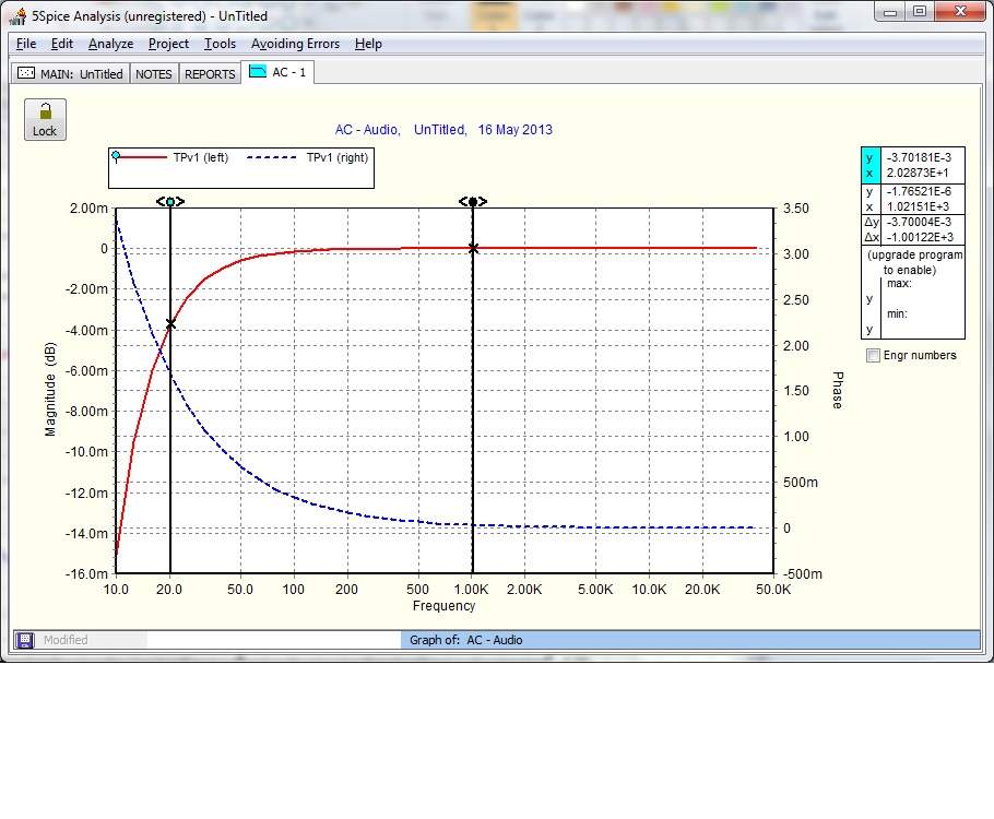

The one suggestion I would recommend is to change that input cap. You currently show a 1uF with a 27K resistor. If you check out the bode plot for this filter, you'll see that it will cause a 0.35dB droop at 20Hz (which isn't too bad), but the bad part is that you're 17 degrees out of phase.
I would recommend 22uF or greater. I personally use a 33uF when there's a 27K input impedance. Attached are the simulations for a 1uF, 10uF, and 33uF input cap. Alternatively, I guess you could change the input impedance. Enjoy!

Thanks!
I can probably manage 10u||10n with the Parallel TDA7293 board or any of the little compact double-layer boards by same designer, or point to point, or really any excellent layout is also compatible with using a larger input cap. I already tried 5.5u with the TDA7293 Parallel board, and it was just fine.
Input load:
I'm curious about this. The valid range for input load seems to be 12k through 27k. Smaller figures do louder midrange and a few other things as well. There's no problem to use a 22k or 18k input load. Would that help?
Lower input loads would make the droop and phase issues worse.
FWIW - I would also recommend Nichicon KZ or FG caps for the inputs. Also, the Elna Silmic II caps are just as good if not better. There's no real need for a bi-polar cap on the input pin.
Okay.
I'm willing to do larger size input caps, but only in case of good board layout which is the minority--the compact dual-layer boards listed in post#455, and also point to point (compact triple-layer). Perhaps these have the power caps located close enough to pins 7 and 8 that we have more freedom in fine tuning the amplifier. That's a guess, but I know for sure they're easier to work with for achieving an appreciable practical output. And, your big input caps will do just fine with those decent boards. . . which are the minority.
For the majority, 1u input cap is a safe bet to show on the schematic because the majority are the "inductive spaghetti" single layer boards that have the power caps too far away from the chip with annoying results that get worse if the input cap is made larger. Bad layout boards are the majority, which is what happens when sprawling single layer board design meets a chip with mad pinout. It is possible to make plug-in daughtercards for bypassing problem areas of bad boards; however, a thorough job of it bypasses every circuit and thus it would be so much easier to replace a bad board instead of fight with it.
Anyway, it is really a problem to show board specific values on any schematic that doesn't also show layout.

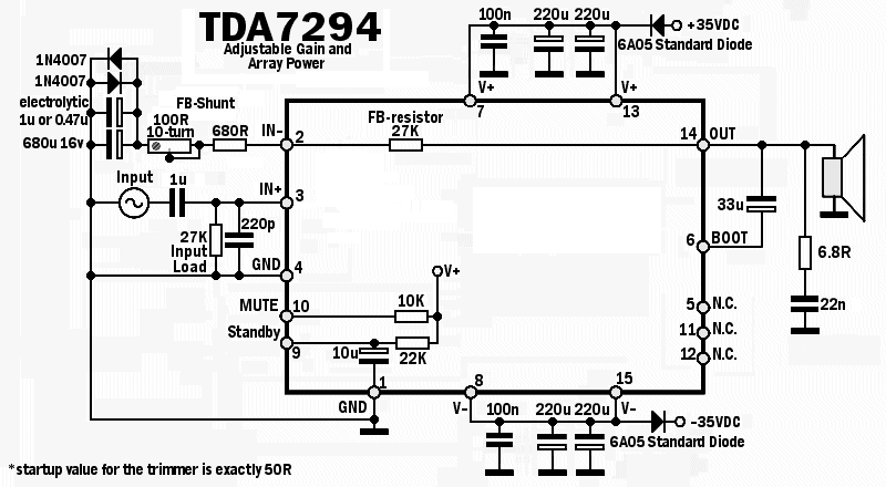

On Bob's single layer TDA7294 board, a power circuit mod very similar to what is shown in the photos (same component values) did cut the need of compensation in half. Note: The TDA7293 Parallel amp board in the photo has V+ on the left side (your board might be different, so double-check). These parts and the 440u per rail are shown on this schematic. Powered like shown in the photo above, it will be much easier to fine tune the amp.
The feedback-shunt trimmer for adjustable gain goes a long way towards not needing added compensation at all. In addition to unimportantly setting the gain, it also varies the tone, mainly treble versus bass, which is expected because of changing the gain, so please use the trimmer to dial in a level response precisely. That's good but a midrange control was previously missing. To fix that, I've added adjustable input load to the schematic.
Functions:
Gain trimmer = Treble versus Bass (dial it in for level)
Input load trimmer = Midrange soft or loud
Notes:
You can replace the 100k input load trimmer with an equivalent resistor after you've completed your fine tuning; but, that is not true of the 100R gain trimmer--it needs to stay on the board. If your board has a fortunate layout for good behavior, then you'd be able to use an input cap larger than 1u, if desired.
