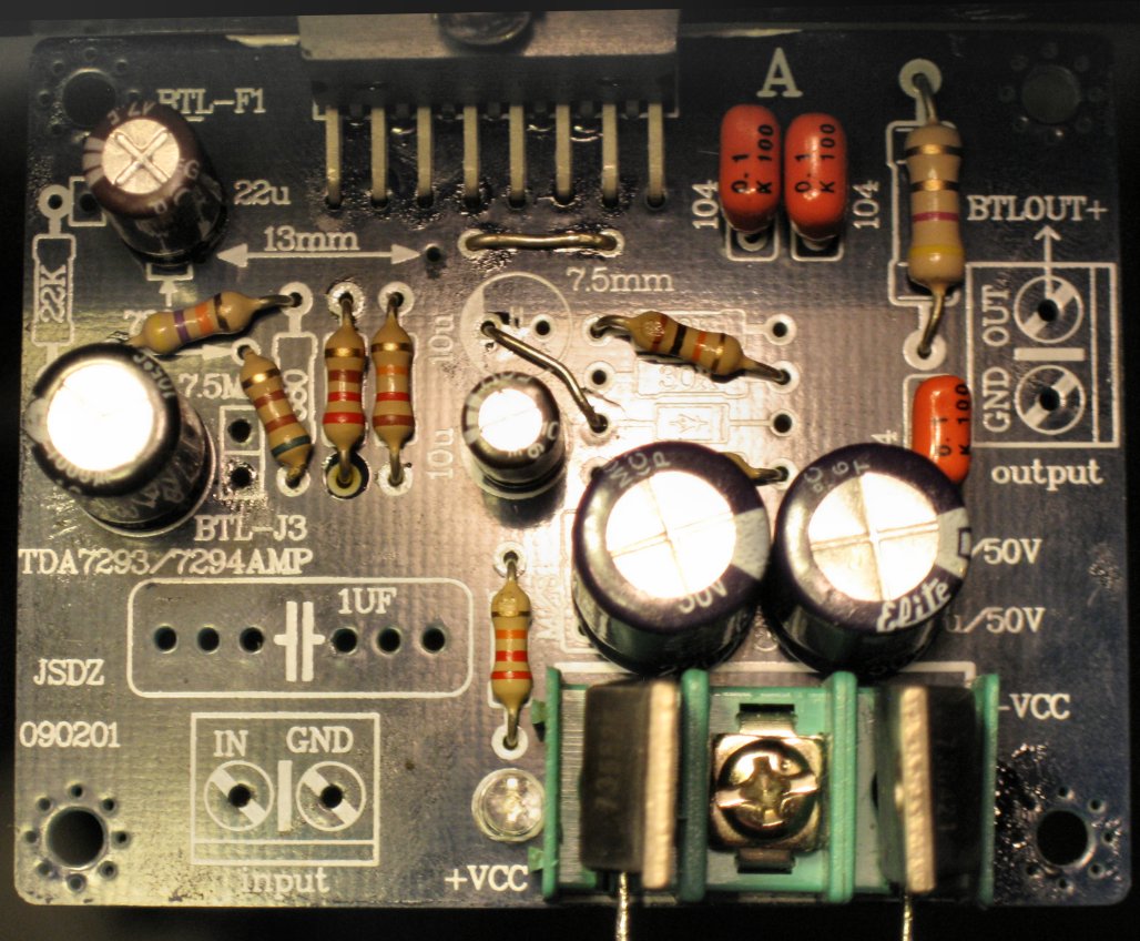

I ordered the same kit from Jim's Audio and I plan to build a modded stereo amp. I have read this entire thread over a number of times and I ask that you check my understanding before I heat up my soldering iron.
I have a 25v dual secondary xfmr of 330va. A little strong but that's what I have. I will constrict the pwr supply as described in posts 116,117.
On the circuit boards I will:
1) replace the 22uf/50v supply caps with 220uf/50v Panasonic FC electrolytic
2) Replace the 47uf/35v input cap with 660uf/35v electrolytic
3) Replace the 680ohm feedback resistor with 1.2k ohm 1/2w Xircon carbon film
4) Replace the 22k NFP shunt resistor with 47k 1/4w Xircon carbon film
I'll be using a pre amp because I've got a few laying around collecting dust.
Fused mains, star ground, bulb tester, speaker protection will be employed.
Am I on the correct track?--Just trying to summarize at this point. Thanks!!
That transformer is perfect.

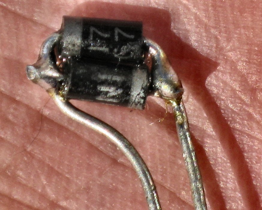

There was a minor layout change. Instead of the MBR1035 schottky going at the output end of the power supply board. . . they go at the power terminals of the amplifier board(s). What they do is hard to explain, but their task is rather simple--they block blur. And, I have been using them during the testing.
Most remarkably, I didn't have to roll off the bass with tiny size caps at amplifier input; but instead of bass blocking, the Schottky already blocked the blur at powerside, so then I was free to allow more bass into the amplifier with any size input cap. I put it up to 5uF to check it out. Doesn't blur.
Looks daft but works exactly as intended. Applicable parts include:
MBR735, MBR745, MBR1035, MBR1045, MBR1635, MBR1645. Two schottky (1 for v+ and 1 for v-) per each amplifier board.
Without the shottky, the amplifier fuzzed and faltered at full blast; However, with the shottky, the amplifier did not either falter or clip. Paradigm shift is amplifier board power decoupling forced to work in wide conditions, without the labor of arrays--The schottky is easier and effective. They promoted greater peak power, suitable for audio amp. Also, most efficient way for decreased crosstalk in stereo builds, per KSTR's comment, post 117.
Yes, Panasonic 220u is a okay. Their 270u is fine too. You can also parallel caps if you want to explore that for a slight boost with slightly different tone.
I actually got lower distortion with: 27k vs 510+220 (post#408)
But most importantly, put the feedback resistor trackside, under the board, right onto the chip pins.
The 510+220 (730) is carbon. Alternative is 560+150 (710).
I used the xicon carbon film from the radio shack--those have nice thick low inductance pins, not wispy pins. On the Jim's Audio single sided board, just put one resistor each hole at the spot marked 680, and tie the tops of the resistors together to create your 730R or 710R.
Or, on the Parallel board, put these resistors trackside, directly from pin2 to NFB-shunt cap so that you don't amplify the weird PCB layout.
The nfb-shunt cap(s) will end up hanging off the left edge of the board if you happen to use multiple parallel caps and or bypasses. However, 680u(16v)+0.47u(Nichicon ES), both electrolytic, will fit onto the board.
The very large value nfb-shunt cap also needs a safety clipper. You get a pair of diodes, such as 1n914 or 1n4148, and put the pair together antiparallel (paralleled with stripes facing opposite directions). That makes a clipper. The forward voltage drop is now ~0.65v in both directions. This clipper is used to prevent the 660u cap from charging up to a blast that could knock out the -input. When the antiparallel diodes are put parallel to the 660u, they limit the cap charge to ~0.65v. This also prevents power on thumps.
Notes: Without the safety clipper, the extra big size NFB-shunt cap will probably cause a thump. Use the clipper--That clipper does not clip audio. If your rails are lopsided, use two series clippers (4 diodes) for 1.3v tolerance, which is still better than nothing. Then the NFB-shunt cap will not accidentally charge to more than 1.3v. The big caps can work fine, but is slightly more effort. It is the price of good bass.
Maybe you'd like to wait until I've made some photographs?

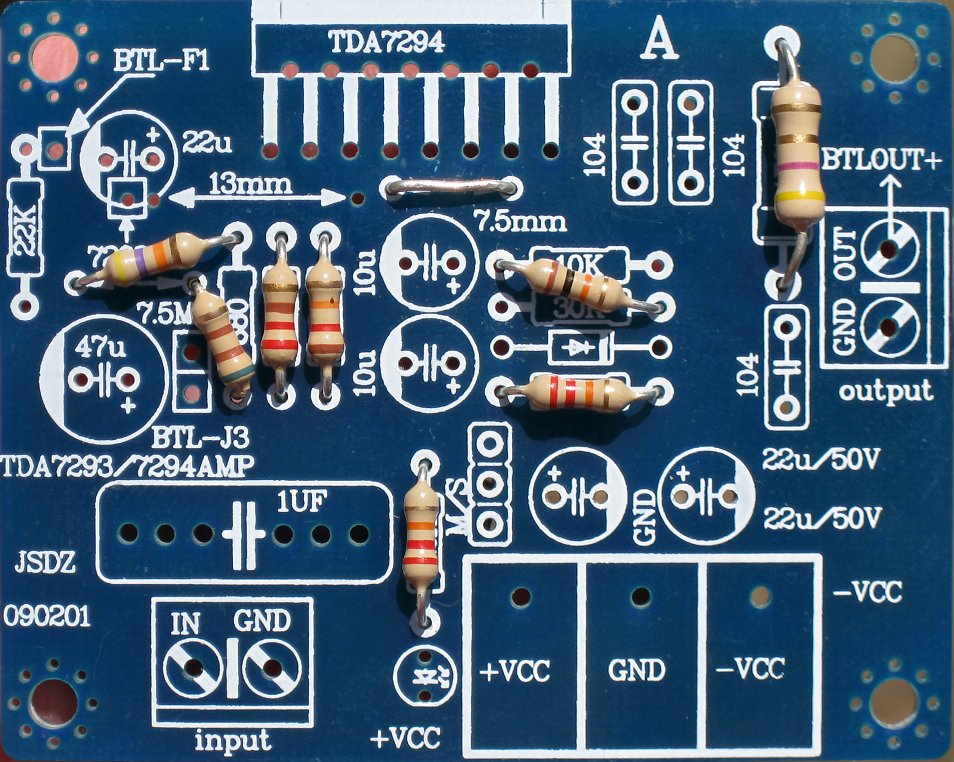

Antsy TDA7294 single layer board. . . :D
Here's the single sided TDA7294 board available Jim's Audio and elsewhere. I believe this resistor re-route configuration and values are correct; and I hope to test this one fairly soon. All of the resistors are on the board and by shortest route, so if you don't want any trackside work, this is probably the way to go.
Thanks for the helpful reply Daniel. I will await your photos and last changes before ordering parts for the boards and pwr supply so I can incorporate your changes. I am getting antsy to begin the build and will keep my progress posted.
Antsy? That's good news! I have a suggestion. . .
Howabout a trip to the nearest Radio Shack for:
"Micro 1A Diodes" such as 276-1104 or 276-1101. This is to restrict charge build-up in the giant NFB-shunt cap. Assuming 2 boards, you'll need 4 standard silicon diodes if your rails are level, or 8 diodes if your rails are not level.
Excellent flux, such as 64-022. This is to convert non-shiny imperfect solder joint to perfect solder joint--apply drop of flux and re-heat. Perfect, and quickly. Excess washes off with alcohol.
500-Piece 1/4-Watt Carbon-Film Resistor Assortment, 271-312. This is a big collection of very good quality resistors, and exactly what I've used. They're similar to other quality parts like Xicon, Vishay, Koa.
And they've got thermal compound, Arctic Ceramique, which is excellent for chip amplifiers.
Also consider purchasing the three Smallest sizes of tiny green polyester dip cap. That's for use as bypass helpers to larger signal caps. They work very well to bypass an Elna Cerafine of 4.7uF and Smaller sizes for simulating BlackGate sound without the wallet smash effect. Anyway, these little green polyester caps from the Radio Shack can help remove treble droop from larger signal caps. They're slightly lossy, and therefore far less risk of ringing if you install a mismatch; so, they're easy to use for bypass duties. I believe the packages are marked 0.047uF, 0.022uF, 0.010uF
You may also want to experiment with Radio Shack's big blue 1uF as input cap, although not exactly my preference to use HV plastic for signal, it is well reviewed and there is no need to pay more for that approach--although possibly not optimal, at least it does not treble droop, so it is not confusing to use it. The main benefit is that it will give you an option for comparing.

Now Playing--Jim's Audio Single Layer TDA7294 board.
It came on playing efficiently while the bulb tester remains dark.
Upper left, the bootstrap is 47u. Standby has a 10u cap, mute does not. The input load is 12k. The gain divider is 27k vs 510R+220R. Resistors shown more clearly at post 414. The NFB-Shunt Cap is 660u with an additional bypass cap under the board (try a 1u or smaller electrolytic as your first guess). Plastic power terminal modified to support the MBR schottky for to block blur and block crosstalk. Picofareds RF filter cap added to small signal input area under board. More elegant small input circuit not yet built. The amp is playing nicely direct driven from my computer.
Here is the safety clipper that plugs in right next to the NFB-Shunt Cap. The connection is clipper parallel to large nfb-shunt cap. It doesn't clip audio. This little clipper prevents charge build up in your cap so that it doesn't knock out the inputs like a taser. The unit shown limits the charge to 0.65v with 1n4007 didoes. If your rails are quite lopsided, two such units can be put series for 1.3v limit. This unit shown in the photo below, prevents the destruction of the chip's input.
