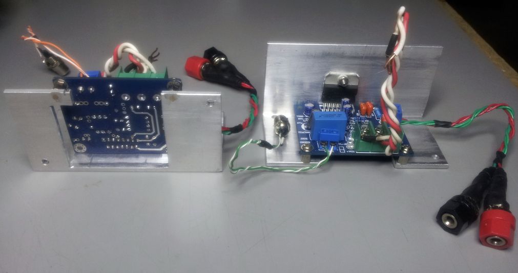

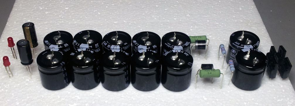

I needed a method to start the component swap testing so I built a open bottom brace. I'll use that in combination with sockets when I start the comparison process. Will be adding some alternative parts in the next online orders.

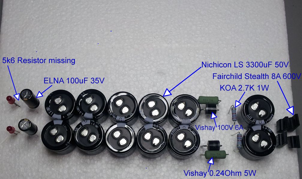

Also got a start on a PS by mixing some new and some on-hand components. Between emails and posts, Daniel has me thoroughly confused :D so I'll just post what I have and ya'll can set me straight.

Bob, most of those parts look good.
However, I see a 3 divergences that don't match the schematic. . .
1). No need to cause ringing with the unexpected extra 100u caps (omit for now).

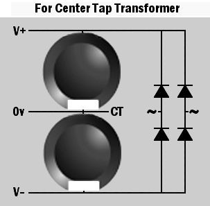

2). If your transformer is dual-secondaries, the bass could be better if you use dual-secondaries specific support. See photos (attached).
3). Capacitor polarity needs checked. See photos (attached).

We need to talk about "Derating."
Bob, in regards to that one mystery 35v cap on the rails in your picture:
The 35v rated cap on 35v rails is like setting the cruise control on a Chevy Corsica stuck at maximum speed, 143 miles per hour, which would shorten longevity dramatically. Likewise, the 35v rated cap running on 35v rails won't last long.
Derating for longer lasting:
50v rated caps, 35v rails, TDA7294, 24+24vac transformer
63v rated caps, 48v rails, HoneyBadger, 35+35vac transformer
The deal is that getting any practical long-term use out of anything either electronic or automotive requires it be used at somewhat less than floorboarded. Unfortunately, the sensational headlines of marketing figures (like the voltage printed on the side of caps) don't usually include longevity, and datasheets are advertisements, especially the first page with the headline/destructive test, peak rated figures that aren't for practical use.
Some approximate examples:
An active device may run up to 40% of its rating at conservative voltage or up to 20% of its rating at higher voltage.
A passive part may run up to 60% of its rating at room temperatures or up to 35% of its rating at warmer temperatures.
Those generalizations are somewhat imprecise, but none of them run at 100% of their advertisements. Therefore, the voltage figure printed on the side of the capacitor is not really trustworthy--it is a "headline figure" aka marketing BS. The fix for this problem is Derating.

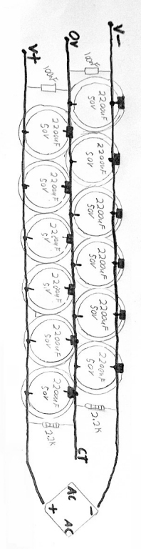

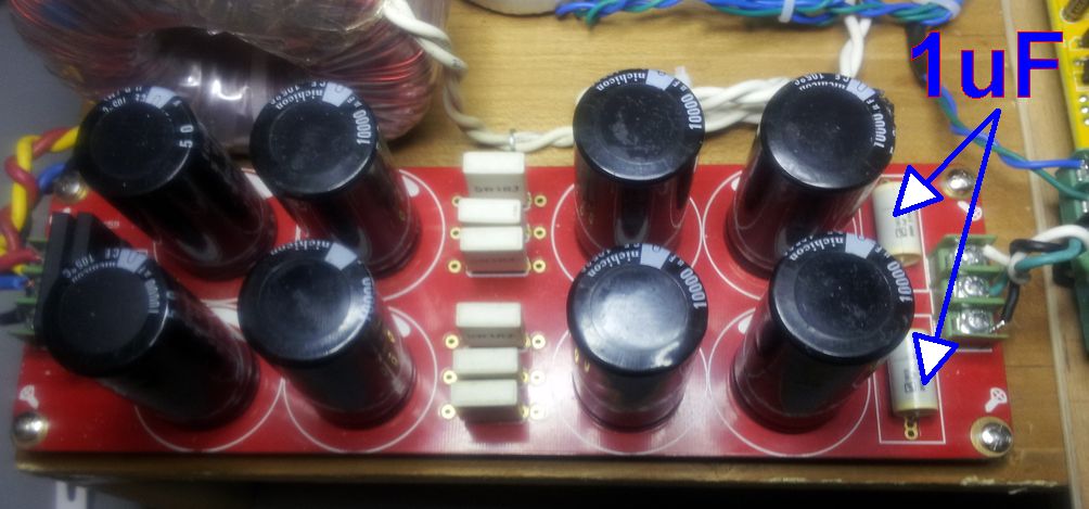

Hey Daniel,
There may just be a computer graphics problem here. I used the drawing attached to post # 78 as my key. I saw uF and on closer examination that may nF - not sure.
But I'm glad you caught it. That's why I posted what I have before heating up the soldering iron.:) Also the red PS in the same post has a cap in a similar spot, so some more clarification may be needed. Are you suggesting that specific cap be completely eliminated, replaced with a different value or it's something for center tapped transformers only?

But I'm glad you caught it. That's why I posted what I have before heating up the soldering iron.:) Also the red PS in the same post has a cap in a similar spot, so some more clarification may be needed. Are you suggesting that specific cap be completely eliminated. . .
Yes, that 100n can be eliminated. Let's call it "TBD" (to be determined) status. You may want something as small as 22n polyester dip (not box) cap, or as large as 2u electrolytic. . . or no extras at all. There's no telling until after an audio amplifier is connected.
The wrong cap can really put a dreadful kink in the treble, but omission does not have that risk. For sure you'll want to try the power supply, first, without that extra cap.

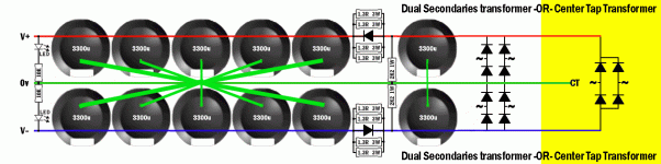

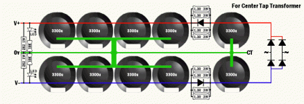

. . .something for center tapped transformers only?
I think that I found out where the 100n came from.

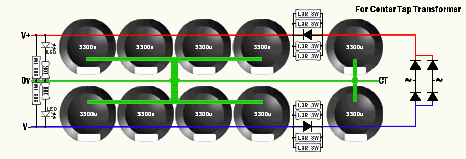

On a center tap CRC power supply, the smoothing section at the bridge rectifier has its own ground. . . and then effectively a heavy duty jumper. . . to the reservoir/tank section that has a massive star ground. . . and then another heavy duty jumper. . . to the output jack. Aha! That last bit could have some little 100n caps or something at the output jack.
Well, the main point of this post is showing that a Center Tap specific CRC power supply has a different and somewhat more complex grounding scheme. Suitability for multi-parallel little caps power supply was limited, but I think I've managed to draw it.

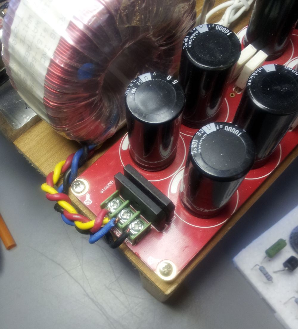

Looks like the PS boards I have been using will accommodate both styles of transformers. They have the small caps installed but work just fine with duals I have.

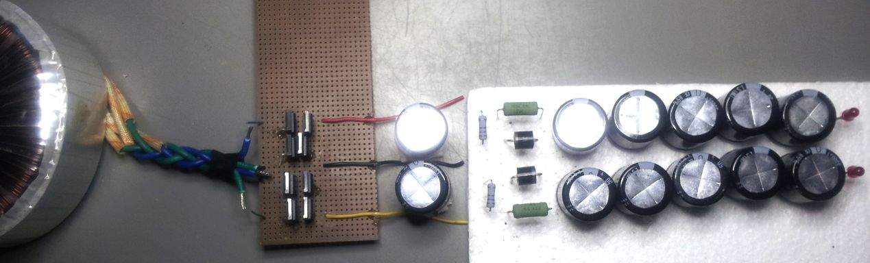

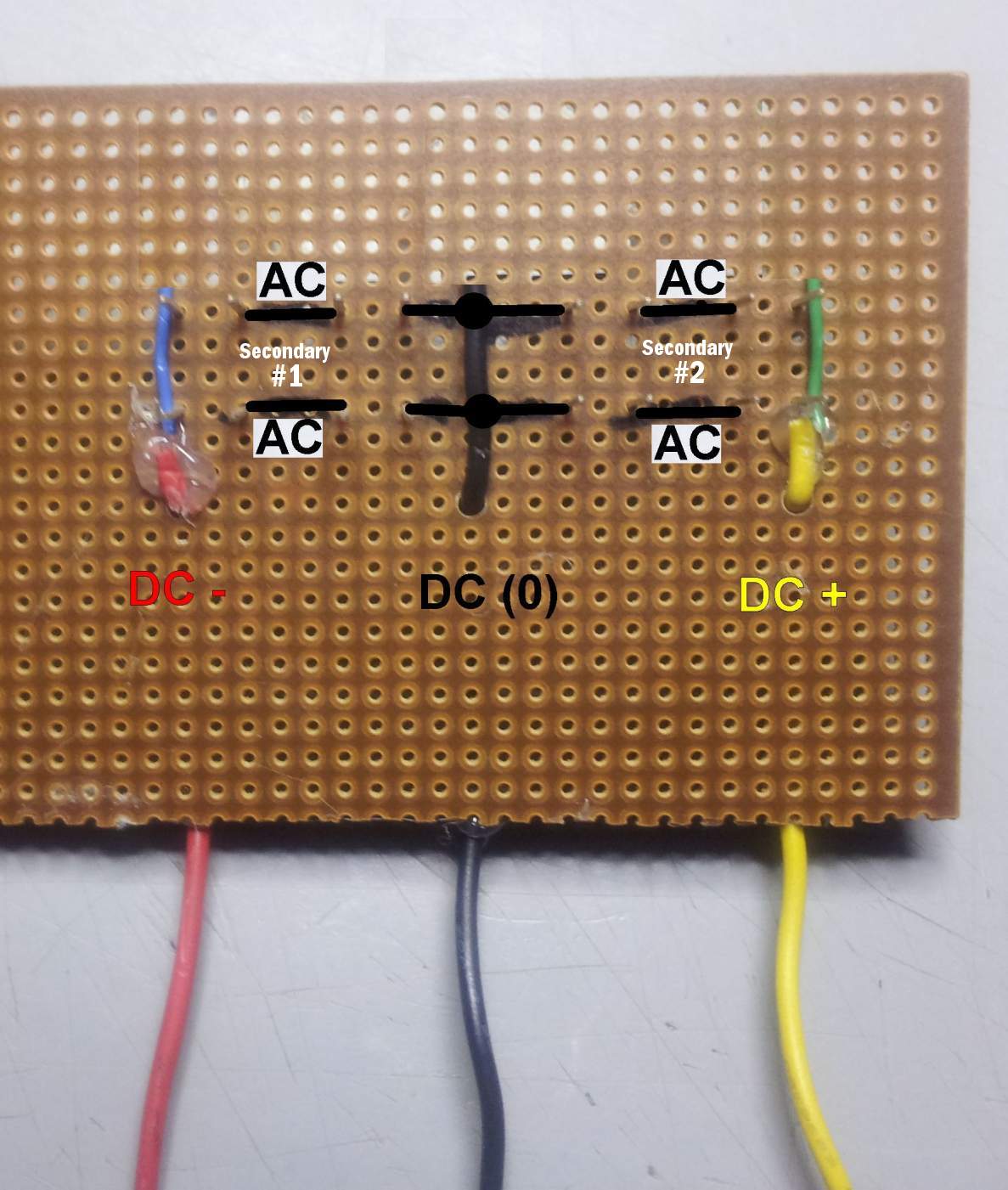

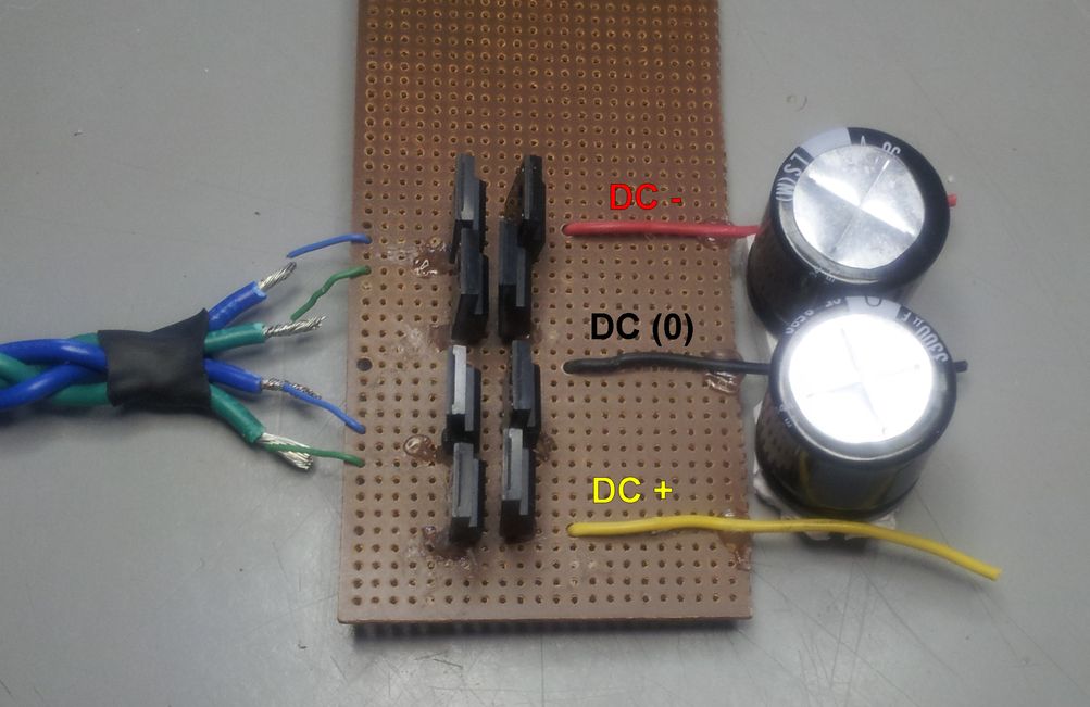

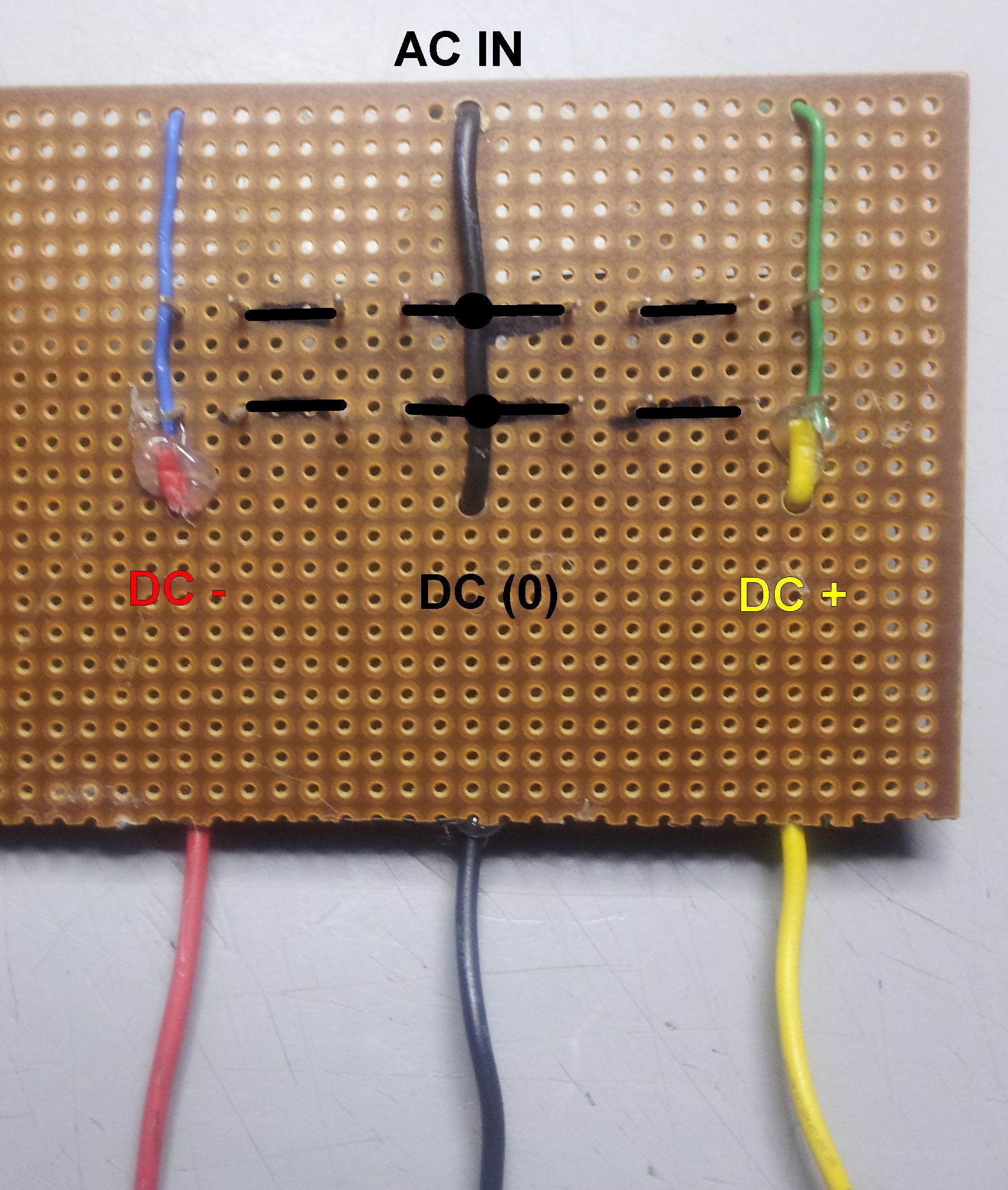

Since we didn't have "show and tell" when I was in school I'll try to make up for lost time here :) This is a little mock-up for final approval. Of course I'll use bigger wire (or copper strips if advised so) for the final construction. I have never done a DIY etched PCB so that might be another new adventure.

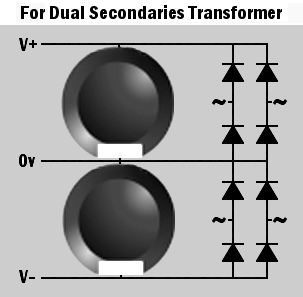

Right side picture, you have a dual secondaries transformer and it can perform more strongly when given specific support. That's good news.
You have two secondary windings--use ohmmeter to identify secondary#1 and secondary#2. And separate the output cable of your transformer so that you have a twisted pair of conductors for secondary#1 and a separate pair of twisted conductors for secondary#2.
Middle picture, don't attach any cable from a dual secondaries transformer to any part of the DC rails. All AC must go through the diodes (per every dual secondaries type schematic). See attachment.

Center tap vs dual secondaries? The deal is that those two styles are competitors, like Windows VS Mac.
Without hindering bass/dynamics from dual secondaries transformers and without setting center tap transformers ablaze, a solution with neither problem has both hookups. I've never seen one because it would make more sense to put the bridge rectifier(s) on "daughtercards" and plug in whichever you needed.
However. . . Like a Jeep or Scout than can do either car or truck, here (attached) is a hermaphroditic power supply board that can use either a center tap or a dual secondaries transformer, properly. Proposed use: A "Tester" power supply for bench use.

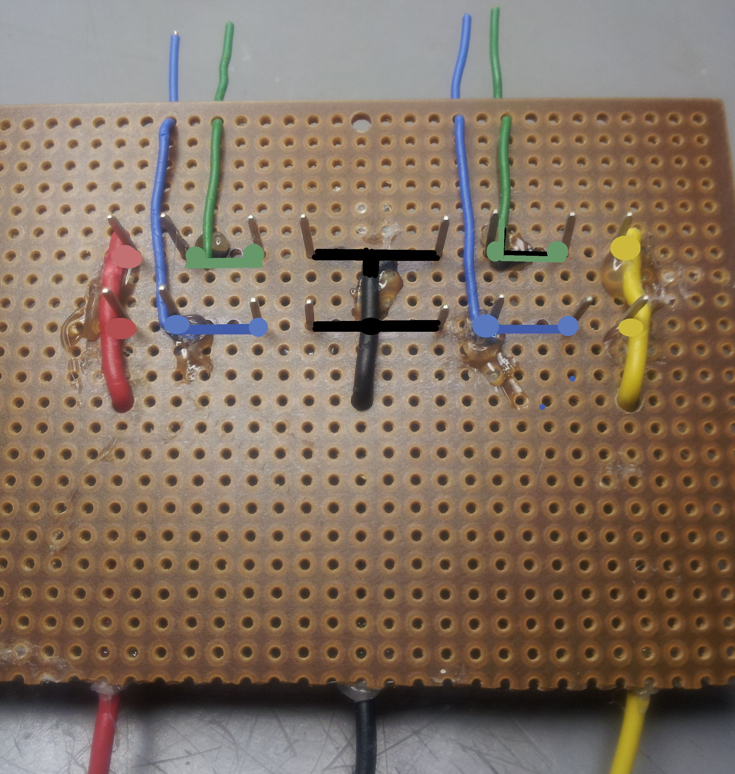

It's a good thing I don't embarrass easily.:eek: Here is the latest. Am I getting close?
Again, some of my confusion comes from my existing board . It is using the "3 point" configuration with dual secondaries. I believe you are saying that will work but is not optimal for this particular application. Is that correct?
It is not optimal for your transformer--Using center tap power board with dual secondaries transformer causes "poorer regulation" and what that does is make the transformer act like it has less VA, so then the bass and dynamics falter due to early onset of transformer throttling. See also post#274
Oh yes, the latest photos of the handmade stuff looks correct.
