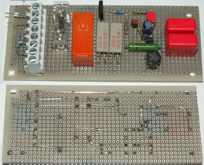

softstart final circuit
here is the final schematic of "my" softstart circuit and here the "PCB" of the softstart circuit.
Delay is about one second, recovery time (minimum time between switch off and switch on for "retriggering" the delay) below half a second.
I realised, that it is better to let all the circuit on the primary side of the supply, to avoid mixing primary and secondary voltages. The actual board is 120mmx50mm. All necessary connections to mains, two-pole mains switch and transformer are included in the connector.

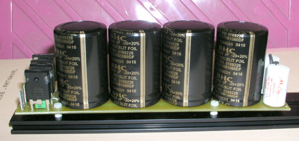

My views on the power supplies, I don't like the OEM way of calculating a transformer, OEM typically lacks, this is what brings us all here in the first place. I don't think DIY'rs here want to pinch pennies in areas it really makes a difference, or throw away tonnes of money in other areas where it doesn't make a difference. If we pool together we can avoid such things occuring for everyone, lessen the learning curve, and cost of it.
So I don't think 70% of calculated requirement is a good way, for whatever that's worth, I also dont' think 130% of calculated value would get you much of anything. Why not go for 100% of what the calculated requirement is, maybe 110% or 120% for good measure (usual losses etc).
Overkill here will only hurt the pocketbook.
Caps, Bruno's requirement, calculated ripple requirement, seems the smart method. He also warns about power factor .. as ewildgoose reminded us Bruno has even provided, if I recall correctly, a very general rule of thumb for sizing them according to the load. This is engineering so there should be no black magic voodoo solution here.
Perhaps there are other factors to the supply capacitors which could be discussed here that might have more of an impact in quality than mere size alone. ESR.. ESL.. Ripple capability, etc.
It would be nice if we could work out what works and what is BS so we dont' all go running for split foil gimmicks that cost a fortune, and just stick to the basics that do actually work.
Kind of like, we all know what's best for rectifier diodes, right? Thanks to the dozens and dozens of previous posts on the same subject here =HexFred, or any ultra fast/soft recovery. And voila, our work is done.
Has anyone ever compared a standard set of properly selected computer grade caps to "possible" gimmicks like split foil/virtual 4 pole etc? Or do we just buy them because the marketing got to us?

I know we don't want to run caps hot for the obvious reasons, but it might be a posibility to use the idea to test the effects of esr on the sound quality, while keeping the rest exactly the same.
Putting more caps in parallel operation is a much easier way to lower esr.
I also made me thinking about several famous class-A designs that use to run very hot (Old Krell's, old Musical fidelity) and had good sound. Was there a relation? Probably not but still an interesting idea.
One other thing I notice is that all theory suggest that this has most impact on lower frequency's.
My practical experience with Zap 2.2SE was that with too smal power supply the HF was much more affected. I assume that the current draw in the bass does affect the voltage on the supply rails and this generats IM distortion in treble.

My opinion concerning ESR drop with temp. The disadvantage of ESR is twofold at least:
- ESR will produce heat due to the I^2*R power loss, induced by ripple current, 2A at 20mOhm will result in 0.16W. The according temp rise has to be added to the operating temp.
- ESR produces steps on the capacitor voltage (= rail voltage) due to I*ESR. This is important, because the charging current of the main caps is much higher than the average discharging current.
I did not measure it, a rough estimation instead (assuming 2A average, resulting in about 160W at 40V rails, from 10mF caps): delta(V)=I*delta(t)/C will result in 2V(!, pos and neg individually) rail drop per 10ms.
To get the charging time, I go the loop way calculating sin(x)=2V/40V; delta(t)=(90°-x)/90°*5ms (90° and 5ms are the equivalents for the raising part of the charging sine voltage).
This will result in approximately delta(t)=1ms, which ends in a charging current, ten times of the discharging one: Icharge = 20A (I(charge)/I(discharge)=t(discharge)/t(charge)). Multiplied by the ESR, this will add 0.4V steps (within 1ms) to the rails.
Hopefully I'm not completely wrong.

Oh yeah, great work on the slow start circuit Timo
