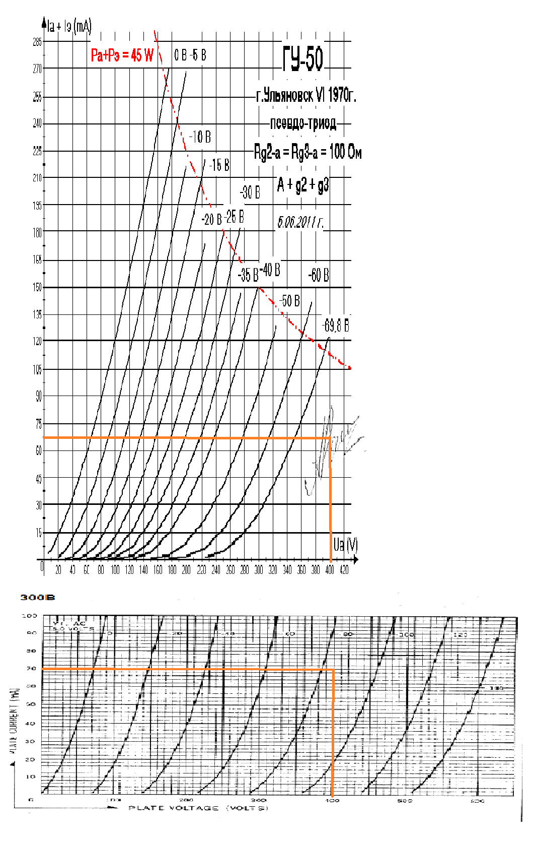

Hello Rongon !
Thanks a lot !
I'm begining to understand push-pull load line :The Valve wizard had help me and the triode calculator too:
Universal loadline calculator for vacuum tubes - Vacuum Tube Amplifiers - DIY
OPt seems to be around 65 ma vg near -70v...

Thanks for the link to the online loadline calculator. I hadn't seen that before. Nice find.
When you load your GU-50 into that calculator, set it SE and to Triode (of course), but set the Load (Ohm) to *half* the Ra-a of your OPT, so for a 3.5k:VC OPT set that to 1750 (ohms). Then set the anode voltage to 400V, the quiescent current to 70mA.
That matches the easy way to draw a loadline for push-pull operation. You do it as if you were making a loadline for single-ended operation, but at half the load impedance (or resistance).
So... With those parameters entered, do you see the operating point? It's way over to the right, with not much room to swing along the loadline to cutoff (0mA anode current). All the room on the loadline is to the left, towards 0V on the grid (grid current region). That means your output stage will be spending a lot of time running in class AB, with one GU-50 going into cutoff when the output stage is driven harder (higher input voltage applied). That will create a crossover notch at higher outputs while one of the GU-50 tubes is not drawing much current and the other one is. You will need to use negative feedback to smooth that out.
Now try the same operating points, but this time with a 300B.
It too is pretty far to the right on its loadline, but not quite so much as with the GU-50 triode.
Also, you can see that as you go farther right on the anode curves, the 300B anode traces stay more upright, while the GU-50-triode traces start to 'lay down' to the right (they get flatter, less upright). That means the 300B stays more linear as it approaches cutoff.
All this argues for using the GU-50 with a higher impedance load, so that it can operate more of the time in class A, farther away from cutoff (closer to 'centre-biased' for more symmetrical swing).
I tried it with 3300 ohms to simulate a 6.6k ohm OPT like one would typically use for PP 6L6GC. Try lower anode voltage too, let's say 350V. Set the anode current to 90mA. See what happens? Much lower THD, but less power out.
Now set the quiescent current lower, let's say to 75mA. That's a good looking spot too. My takeaway? GU-50 works better into higher primary impedance, like 6.6k ohms, or even 10k ohms. But it will work into lower primary impedance like 3.5k ohms, sure. The tube will act differently, though, and you'll want to design for that situation.
