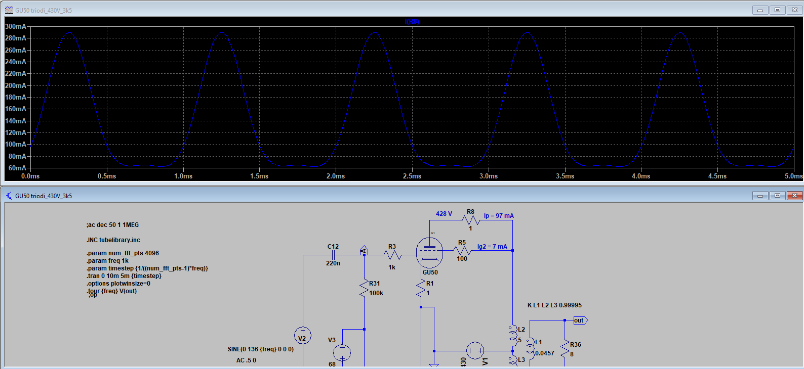

My results are at class A. Attached the plate current of one GU50 at full drive.
As you see the plate current do not drop below some 60 mA.
The drive voltage at g1 is 68 Vpp. DC-bias at g1 = -68 V.

104 mA is plate current + screen grid current (=cathode current) at idle (no signal condition).
Look at my post #24. There is the plot of plate current.
The max. value of the cathode current at full drive is 310 mA and min. 65 mA.
Working point ?? It is the idle condition.
Look at the schematic: Ua/Ug2 = 428 V, Ik = 104 mA, Ug1 = -68 V.

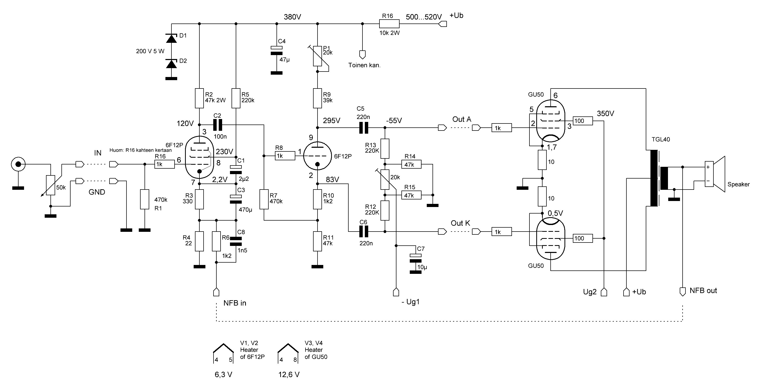

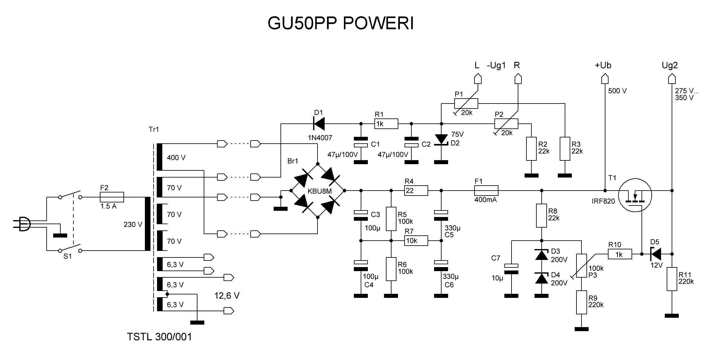

If you are interested, attached are schematics of my GU50 experiments. I got 75 W.
I have my schematics,i will use 6n8s for drivers and Schmitt phase spliter.
Maximum current for this transformer is 170ma even it is a 50w transformer

Here's a schematic of an idea using PP GU-50 in triode and two 6N8S (= 6SN7).
The B+ is 400V and it uses fixed bias for the PP GU-50 pair.
The simulation predicts very low distortion and about 17 watts max power out to the speaker.
It's a 'Williamson' driver circuit.
The 4.7k ohm global feedback resistor is just an approximation to get about 6dB NFB.
It's just an idea. But it looks pretty good in theory.
PS - The output transformer model used is for a Dyna A470, which has an approx. 5k primary impedance.
